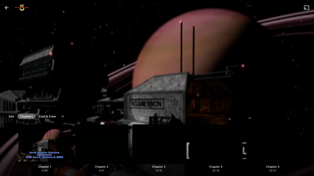

blgentry 51 Posted October 4, 2023 Posted October 4, 2023 I've got Emby set up in my video libraries to create thumbnails at chapter markers. This mostly works as expected. But in a few instances, the chapter markers are all at black screens that appear between scenes. So the thumbnails either show as totally black, or as a barely visible picture of the next frame that's being blended in at the chapter marker. This makes sense from a DVD/BD authoring perspective. Put the chapters at the scene transitions. But this makes the thumbnails not very useful for trying to visually identify parts of a show or a movie. I was considering changing to 10 second thumbnails, but I'm thinking that won't solve my problem. When I press the interface button to display chapters, I'm still only going to get the thumbnails at are AT the chapter markers right? I won't get hundreds of thumbnails showing on the timeline. So what are the 10 second thumbnails for? I guess for some sort of visual fast forwarding support? Can anyone link me to a picture or video that illustrates what these thumbnails are good for? Next, I've read up on how to change the thumbnail generation setting. It seems that I have to "refresh metadata" for them to be regenerated. That will potentially overwrite all of my existing metadata and erase my carefully selected choices. I'm hoping that I misunderstand the whole process, but I don't think I do. Thanks for any information and help. Brian.

blgentry 51 Posted October 5, 2023 Author Posted October 5, 2023 These black thumbnails are from embedded chapters that were present in the original source material. In this example of Babylon 5 S2 E2, they came from DVD. If you think about it, it's quite natural for the author of the DVD to put chapter markers where scenes begin. When there's a scene transition, many times the video goes black for a moment to signify the transition. Attached is an Emby screen shot of this episode, with the chapters at the bottom. I'm not sure if this really matters the more I think about it. I don't often jump forward in TV episodes. I normally watch them all the way through. With movies, I sometimes locate a particular scene and watch it or show it to a friend or something. With TV shows I don't do that very often. This mainly came to my attention because when I showed the timeline in Emby I had black frames in almost all of the chapter markers and it looks weird. I'd still like to fix that for cosmetic purposes if possible. Thanks, Brian.
GrimReaper 4845 Posted October 5, 2023 Posted October 5, 2023 16 minutes ago, blgentry said: These black thumbnails are from embedded chapters that were present in the original source material. In this example of Babylon 5 S2 E2, they came from DVD. If you think about it, it's quite natural for the author of the DVD to put chapter markers where scenes begin. When there's a scene transition, many times the video goes black for a moment to signify the transition. Yeah, don't quite see mitigation to that other than for Emby core to implement fixed offset for embedded chapter marker images, preferably +x seconds for extraction.

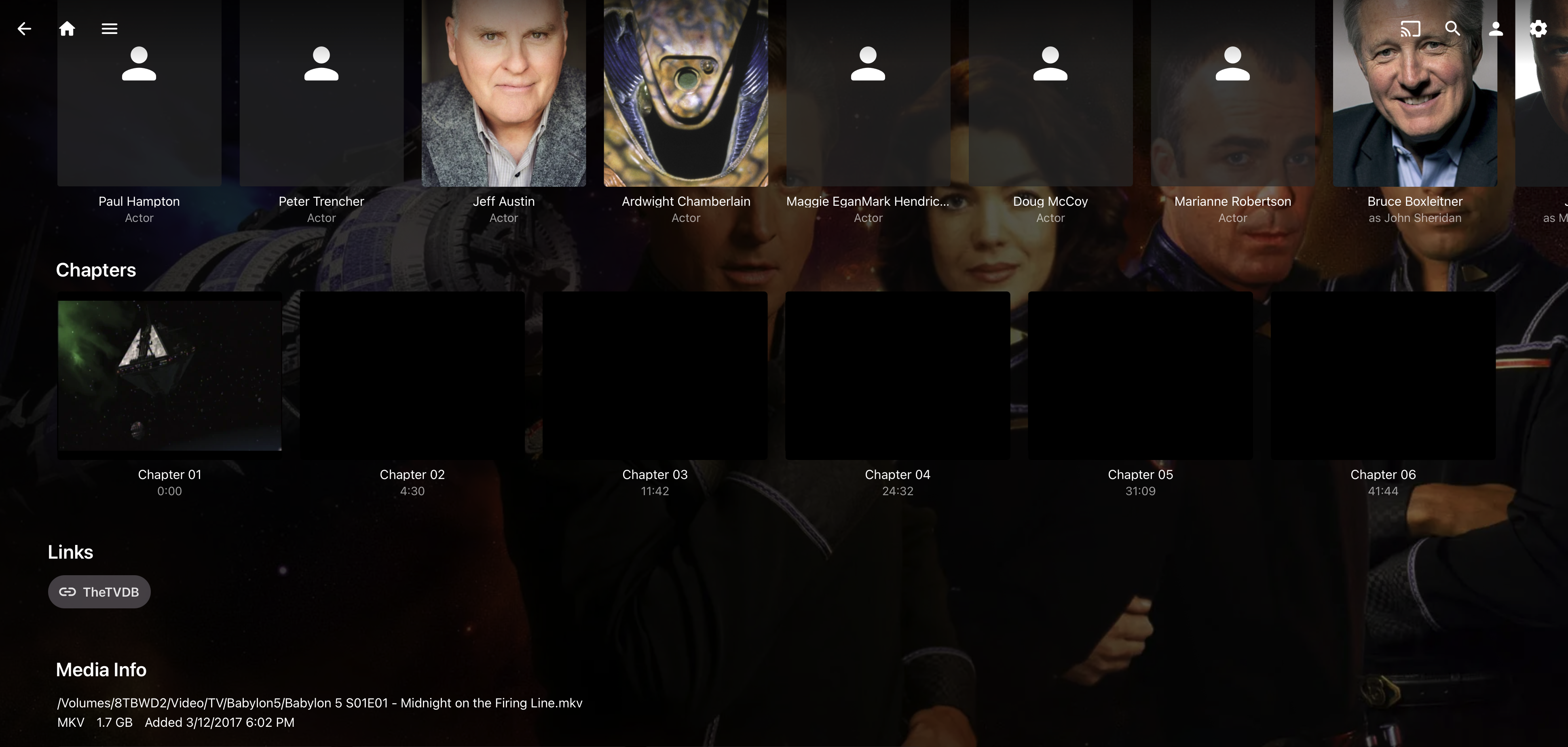

blgentry 51 Posted October 7, 2023 Author Posted October 7, 2023 On 10/5/2023 at 9:41 AM, rbjtech said: I'm pretty sure the extraction for thumbnails IS offset by a second or so for this very reason. There was a discussion about it with sw I believe when I was looking at the HDR thumbnail extraction - just need to find it .. haha @softworkz A debug log of those chapters extraction and the chapter points may be useful to track this one down. Let me see if I understand: 1. Thumbnails are supposed to be extracted several seconds after the actual chapter marks. 2. Something about HDR chapters might apply. This is from a 480p DVD source so HDR should not be involved. 3. A log of the thumbnail chapter extraction might have some clues. The thumbnails were done quite some time ago. How do I get Emby to do that again so that I can post a log? I'm attaching two screen shots. One of Emby showing S1E1 of Babylon 5 with the chapter thumbnails and times. The second is from MKVToolNix showing the exact same chapter times. So I don't think the offset is configured or working. Thanks for the help. Brian.

blgentry 51 Posted October 10, 2023 Author Posted October 10, 2023 5 hours ago, Luke said: Has this answered your question? Thank you for asking. My issue is unresolved. Apparently Emby is supposed to make thumbnail images a few seconds after the chapter markers and that's not happening on my system as evidenced by the screen shots in my last post. I would like to delete the thumbnails associated with one or more of these and capture a log for you. However, I'm unable to find instructions on how to locate the thumbnails so I can remove them and then re-run the thumbnails scheduled task. Based on my poking around, I suspect that the image thumbnails are referenced by a database ID of some sort. I found an ID in the URL of the TV show episode, but it does not seem to correspond to the large hex numbers in the Emby metadata directory. This issue isn't super important and if it requires lots of effort then I can just drop it for a while. I'm much more interested in a few other things I've asked about like the Mac server beta for example. Thanks for your help. Brian.
