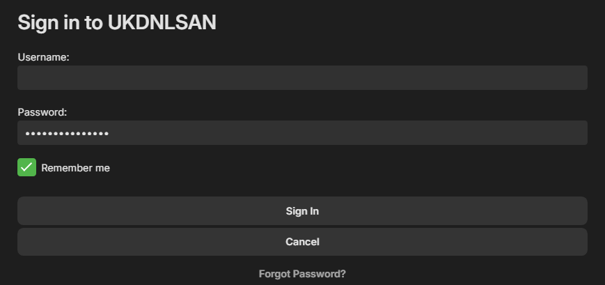

Fademidun 3 Posted November 19, 2024 Posted November 19, 2024 (edited) Hello I need help! using emby for the first time, installed on my nas DS920+, version 4.8.8.0 and it's asking me to login to my nas after finished install and open it, I have tried all sorts of accounts, go to permission and grant access and still no joy, can someone please help, I have tried forgot password but no reply from anywhere?? What userid/login details is it asking for? Edited November 19, 2024 by Fademidun More info
Neminem 1623 Posted November 19, 2024 Posted November 19, 2024 You need to use the credentials you setup Emby server with during the install process. From you screenshot, you did not input username.
Fademidun 3 Posted November 19, 2024 Posted November 19, 2024 Didn't ask for one when installing it, double click the package and said downloading then installing
Fademidun 3 Posted November 19, 2024 Posted November 19, 2024 I think I'm able to login now, after using WinSCP, navigate to the directory on forgot password message and all good

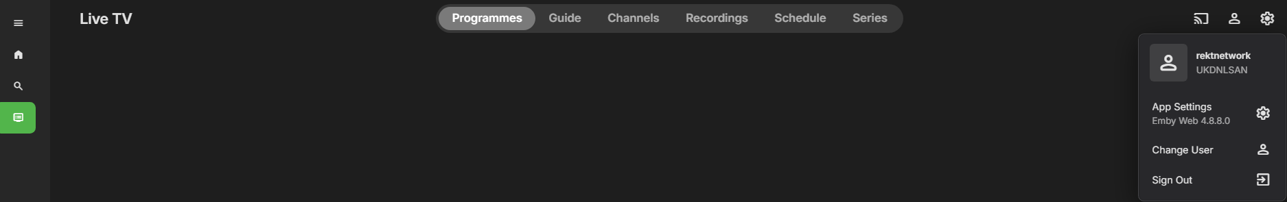

Fademidun 3 Posted November 19, 2024 Posted November 19, 2024 How do I create user/change user password, this is all I can see from the dashboard and settings
ebr 16334 Posted November 19, 2024 Posted November 19, 2024 6 minutes ago, Fademidun said: How do I create user/change user password, this is all I can see from the dashboard and settings Hi. Looks like you are in a Live TV library there. Click the "cog" icon very top right.
Fademidun 3 Posted November 19, 2024 Posted November 19, 2024 Actually, the reset password gave me 4 different account name, the current logged on account is read only, I changed user and got full access, now I've been able to change the password, create new user and add my local network nas folder as media folder.. Thanks so very much 1

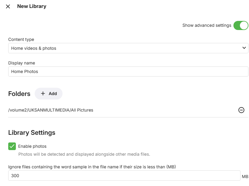

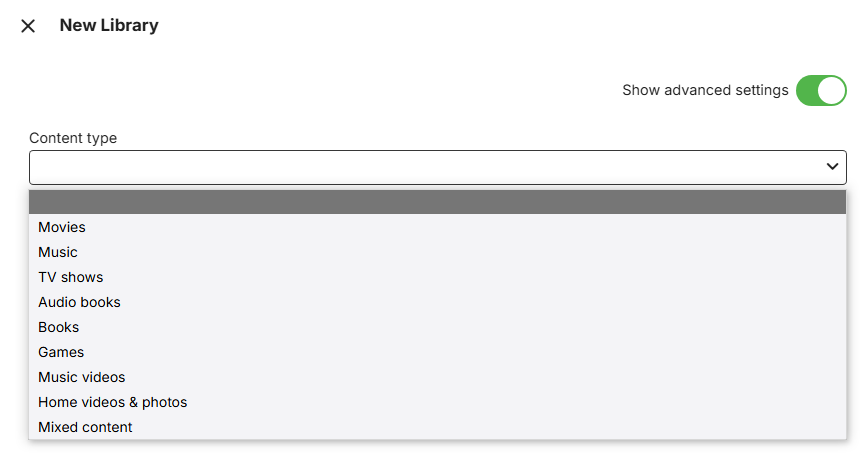

Fademidun 3 Posted November 20, 2024 Posted November 20, 2024 Hi sorry to bother you again everyone, I'm so new to this. I can't seems to get the pictures/photos display/sync at all, I created new library using the 2 options in the screenshot attached - Mixed contents and Home videos & Photos, after scanning, the folders for the images/photos were all present but no photos/pictures all folders empty excepts videos, is there any thing I need to do/missing/ adjust or setup in settings? I have a lots of photos from holidays which I usually see via my TV and need to get this right, everything else seems to be fine including music excepts photos

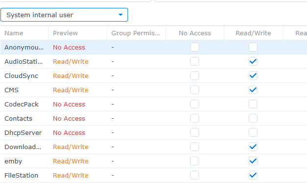

Carlo 4561 Posted November 20, 2024 Posted November 20, 2024 Hi @Fademidun You need to set permissions to any content areas you will use in Emby Server. Check out this Knowledge Base article with more information on this topic. https://emby.media/support/articles/Synology-Set-Permissions.html Let us know if this was your issue or not. Carlo
Fademidun 3 Posted November 20, 2024 Posted November 20, 2024 Hi @Carlo Thanks for reply, I believed I already done all that please see the screenshot attached, I'm rebuilding everything again and will see what happens. The video, music and photos are all in same shared drive/folder, videos and music are ok excepts photos

Carlo 4561 Posted November 20, 2024 Posted November 20, 2024 6 hours ago, Fademidun said: I can't seems to get the pictures/photos display/sync at all, I created new library using the 2 options in the screenshot attached - Mixed contents and Home videos & Photos, after scanning, the folders for the images/photos were all present but no photos/pictures all folders empty excepts videos, is there any thing I need to do/missing/ adjust or setup in settings? I have a lots of photos from holidays which I usually see via my TV and need to get this right, everything else seems to be fine including music excepts photos Except for camera upload, there is no syncing done to load content on the server. Some clients (with permission) can download content to watch offline and will update watched status on the server. There are also a couple of plugins available such as Trakt that can sync watch status for a user to an external server, but it doesn't sync content. FYI: The library type: Mixed content is not a "free for all" or use for any content but has special meaning. The mixed content type is for use when content could be either a movie or TV show format. This library type will use both movie and tv show metadata providers when searching for the metadata. You will want to follow our guidelines closely when using this format to keep movies in a 2-level hierarchy and TV Show types in a 3-level hierarchy on disk. You may want to use the Mixed Library type for something like a Documentary Library as an example. Many single or two part documentaries will be found search movie metadata providers while other documentaries even unrelated to each other are part of a series and produced by the same studio and will be treated as a show, so the metadata will be found for these using a different provider that is considered a TV Show series. 1
Carlo 4561 Posted November 20, 2024 Posted November 20, 2024 OK you have two libraries setup, and you have granted permission to the internal Emby user. Assuming you have content in the directories of the library folders what do you see when you view the Emby Libraries? If they are blank the problem is most likely the files themselves. Besides the internal user permissions you may have to change the ownership of the media itself to be owned by user Emby and owned by group Emby. 1
