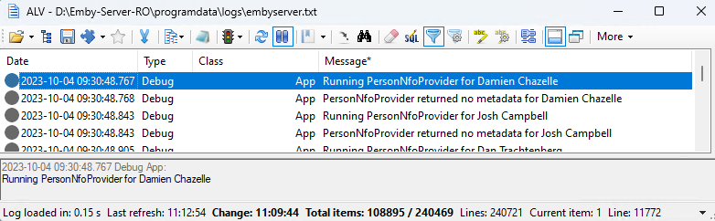

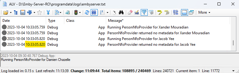

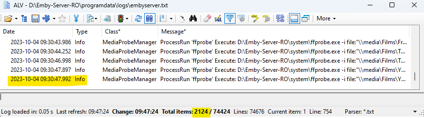

rbjtech 5345 Posted October 4, 2023 Posted October 4, 2023 (edited) On 03/10/2023 at 07:16, GrimReaper said: You shouldn't, you should have only one server writing artwork/NFOs and have the other one only read them, disable all providers/fetchers on second server. Because Emby is still reaching out to internet, as said above disable all providers (or kill internet connection altogether, as I do when rebuilding) before rebuild, if you already have all data stored with media, that will improve initial scan speeds immensely. I The reply from @GrimReaperis spot on. As an interesting exercise - It's actually pretty easy to see how long a scan with the optimal settings takes by using a decent log viewer where you just filter by MediaProbeManager. On a test brand new emby spinup - with a single movie library of 1760 Movies (some with extras) - pointing to my main emby library (local HDD storage) with only NFO Reader enabled and nothing else - it took my system from 09:13 to 09:31 to do the main ffprobe and build the library - that's 18 minutes ... Start ... End ... This will get you a full populated library - and you use from this point. However - The 'Scan' is still going - as 'People' are still being populated - creating NFO files locally. I'll update this thread with those timings when that finishes and the scan media library task is 100% complete... edit/update ok - so it looks like it's the People Providers that are slowing it down. Remembering that there are no Providers selected - so no 'People' metedata nor images are being downloaded here - it still took from 09:30 to 10:33 - for 54,448 People. (!) (note, 2 lines per query in the log) Start ... End .. As expected - when viewing a Movie, the Cast/Crew is empty. So in summary - Task Duration Item build using ffprobe 18 mins People provider (no metadata collected as it's turned off) 62 mins Total 81 mins or 1Hr 20 mins This corrolates with the task time in the main Scheduler. Conclusion Scanning the existing items with NFO, Images, BIF(thumbs) data held locally is not the long task, the long task is building the 'People' part of the database and populating the local metadata cache, because people are not held with the media. Remember that even with the People metadata NOT being fetched - it still took over an hour to scan through them. Next Steps I'd like to repeat this when I have time, and turn ON the providers - to see what the duration differences are. For the ffprobe, I would hope there is not much difference, as all the metadata is already with the media, there is no need to download anything. But for the People metadata, then it's going to need to download all NEW metadata/images - as they do not exist. This is likely going to be highly dependent on the speed of your internet connection and any throttling done by the providers. Also would like to see how BIF's are processed. Questions - Why is People metadata attempting to be retrieved if there are no providers selected ? The scan would be 'complete' in 18 mins if you added this logic. Is there any benefit in keeping the 'people' data with the Media - rather than saved locally ? @ebr @Luke Edited October 4, 2023 by rbjtech 4

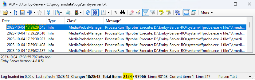

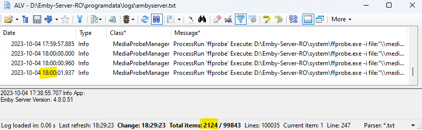

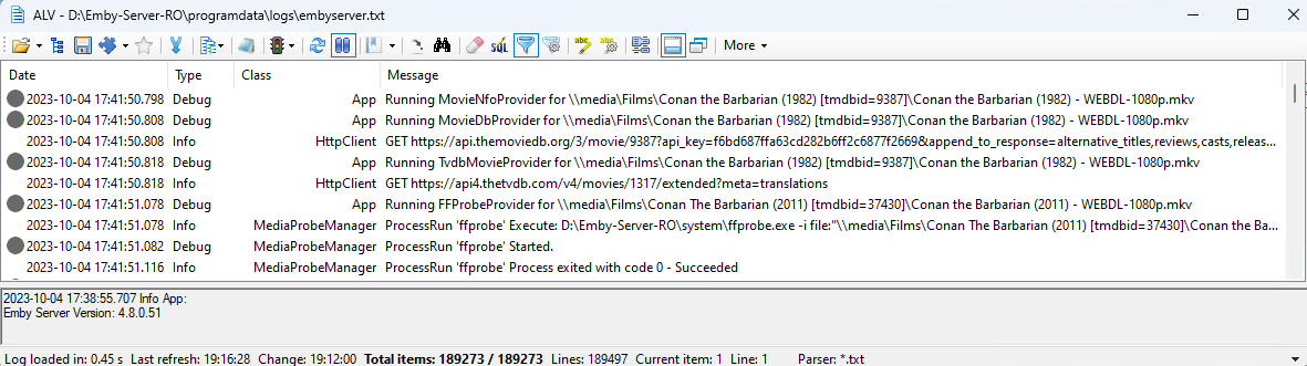

rbjtech 5345 Posted October 4, 2023 Posted October 4, 2023 (edited) So same test, this time with the standard metadata providers enabled - fresh install. 17:39 - 18:00 21 minutes this time, so 3 minutes slower than with no providers enabled. So for each movie, the logging is saying it is querying the Providers, despite already having the data with the media, but I do note that nothing is actually being downloaded. So maybe it's just doing a lookup on what is 'available' and then checking if it's already available locally - if it is, then it simply moves on. Maybe @ebror @Luke could verify the logic here ? The full scan has now finished - and surprisingly, it is 1hr 22 mins and 60 seconds (lol) - so 1hr 23 mins. People is identical - 18:00 - 19:02 - so 62 mins again. So I don't think it's downloading anything at this stage. So in summary - Task Duration Item build using ffprobe 22 mins People provider (no metadata collected as it's turned off) 62 mins Total 84 mins or 1Hr 24 mins The extra 3 minutes needed for the comparison to the local data - I think. Any thoughts ? Edited October 4, 2023 by rbjtech
