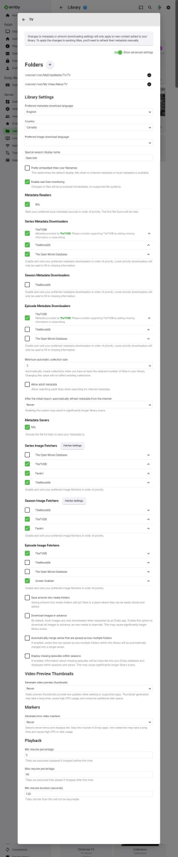

RalphK 0 Posted October 2, 2023 Author Posted October 2, 2023 Hi Luke. Thank you for the quick response. I've attached a screen shot of the library's settings. -- Ralph

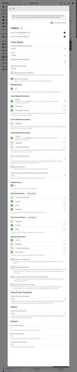

RalphK 0 Posted October 2, 2023 Author Posted October 2, 2023 That screen shot looks terrible. I've attached a PNG
Luke 42185 Posted October 2, 2023 Posted October 2, 2023 OK so the answer is tvdb. Did you check to see what data they have for the series in question?

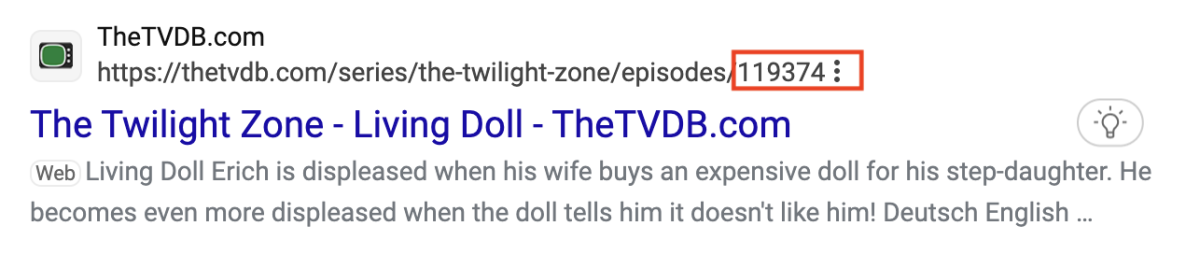

RalphK 0 Posted October 2, 2023 Author Posted October 2, 2023 Yes. I checked. They have cast and crew information. For example, https://thetvdb.com/series/the-twilight-zone/episodes/119374#castcrew
Luke 42185 Posted October 2, 2023 Posted October 2, 2023 OK, please try refreshing the metadata on that episode and see if that helps bring in new information.

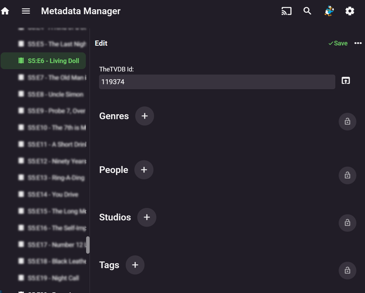

RalphK 0 Posted October 6, 2023 Author Posted October 6, 2023 It looks like "People" is unlocked. However, it is empty.
Luke 42185 Posted October 7, 2023 Posted October 7, 2023 Is that tvdb id for the episode correct? Try blanking it out and saving and then refreshing the metadata for the episode again.
