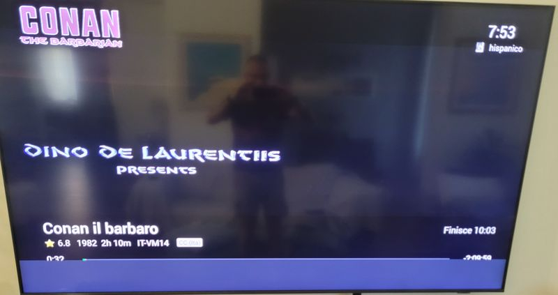

Hispanico957 23 Posted October 1, 2023 Posted October 1, 2023 (edited) Many 4K files on the FireTV have problems as they display another portion of the screen on the right as you can see from the screenshots. Going over them with DVDFAB the problem is fixed and this is the attached txt report before and after.. I also tried trying to use the video/audio correction option but the menu doesn't appear, see other screenshot On the computer these 4K films do not highlight this problem I tested these movies in 4K on 3 other firesticks and they highlighted the same problem. I have a Samsung QE75Q70AATXZT TV and the other 2 Sony and a Samsung UE55ks7000 TV Thank Hispa mkv original.txt mkv dvdfab.txt Edited October 1, 2023 by Hispanico957

ebr 16307 Posted October 2, 2023 Posted October 2, 2023 Hi. This is probably going to come down to the odd resolution as we've seen the Fire have trouble with that in the past. Note the vertical resolution went from 1608 to 1632.

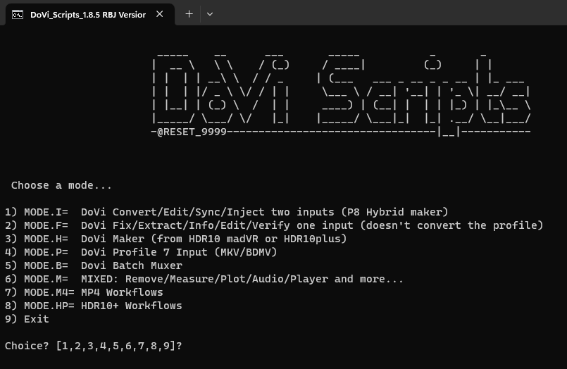

rbjtech 5335 Posted October 3, 2023 Posted October 3, 2023 22 hours ago, Hispanico957 said: Thanks to my friend LicDom, found how to solve the problem that Emby encountered with movie 4K HDR10+ and I prepared a tutorial that I attach here for everyone Kira is Here HDR10+ Metadata Deletion Tutorial.pdf 1.36 MB · 3 downloads Yep - DV8 and HDR10+ is a problem on the FireTV 4K max - it's a known issue already with Amazon and Google. btw - you can automate removing the HDR10+ with a script found online (search for @reset_9999) - I added #8 below - you drag and drop the the file onto the Window and it does it all for you - resulting in a DV8 + HDR10 file - which works perfectly on the Fire TV 4K max.. 1

Hispanico957 23 Posted October 4, 2023 Author Posted October 4, 2023 On 10/3/2023 at 7:06 PM, rbjtech said: Yep - DV8 and HDR10+ is a problem on the FireTV 4K max - it's a known issue already with Amazon and Google. btw - you can automate removing the HDR10+ with a script found online (search for @reset_9999) - I added #8 below - you drag and drop the the file onto the Window and it does it all for you - resulting in a DV8 + HDR10 file - which works perfectly on the Fire TV 4K max.. Thank a lot mate but i search file to automate removing the HDR10+ ...reset_9999 but i see many post but not the file Can you help me to find it ? Thank Hispa
rbjtech 5335 Posted October 4, 2023 Posted October 4, 2023 31 minutes ago, Hispanico957 said: Thank a lot mate but i search file to automate removing the HDR10+ ...reset_9999 but i see many post but not the file Can you help me to find it ? Thank Hispa I can't provide the link on here - but search on the makemkv forums - and you'll find it.. 1
