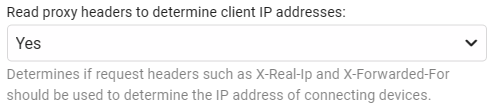

Q-Droid 1002 Posted October 1, 2023 Posted October 1, 2023 What version of Emby? Current stable ignores them. There's a selection in beta to configure handling of headers. 1
TeamB 2440 Posted October 1, 2023 Author Posted October 1, 2023 36 minutes ago, Q-Droid said: What version of Emby? Current stable ignores them. There's a selection in beta to configure handling of headers. yeah it looks like it ignores them if they are not external IPs looking at the beta now, found the setting under network in the settings, it looks like you can force to always use them so hopefully that will solve my issue. 1 1
TeamB 2440 Posted October 2, 2023 Author Posted October 2, 2023 just confirmed this is working as expected in the Beta (4.8.0.49) All internal local address are reported correctly as the connecting device 1 1
anthonws 42 Posted November 27, 2023 Posted November 27, 2023 On 10/2/2023 at 5:45 AM, TeamB said: just confirmed this is working as expected in the Beta (4.8.0.49) All internal local address are reported correctly as the connecting device Are you by any chance using NGINX? If yes, could you share the relevant config to make this work? I am using NGINX NPM and added this to the "Advanced" tab: proxy_set_header X-Real-IP $remote_addr; proxy_set_header X-Forwarded-For $proxy_add_x_forwarded_for; With the above config and the Emby option enabled to read proxy headers, it is still not working for me (only shows the NGINX NPM docker container IP). Thanks!
TeamB 2440 Posted November 27, 2023 Author Posted November 27, 2023 8 hours ago, anthonws said: Are you by any chance using NGINX? If yes, could you share the relevant config to make this work? I am using NGINX NPM and added this to the "Advanced" tab: proxy_set_header X-Real-IP $remote_addr; proxy_set_header X-Forwarded-For $proxy_add_x_forwarded_for; With the above config and the Emby option enabled to read proxy headers, it is still not working for me (only shows the NGINX NPM docker container IP). Thanks! sorry, i was using iis on windows this thread should have some info 1
anthonws 42 Posted November 28, 2023 Posted November 28, 2023 20 hours ago, TeamB said: sorry, i was using iis on windows this thread should have some info All good! I sorted the issue. All configs where correct. I just had to take the NGINX NPM container out of its specific network and place it in host, SxS with Emby container (which was already using the host interface). 1
