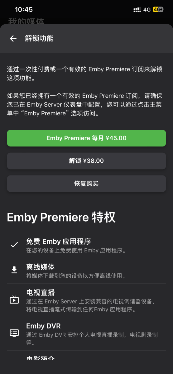

Luke 42287 Posted September 29, 2023 Posted September 29, 2023 26 minutes ago, yoooooua said: 密钥填上了,还是出现订阅页面,不能观看,iso版。 Hi, have you setup your own Emby Server? Are you trying to connect to your Emby Server, or someone else's?

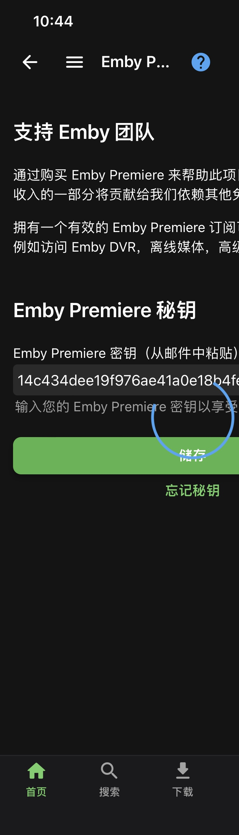

yoooooua 1 Posted September 29, 2023 Author Posted September 29, 2023 设置了自己影视库,密钥也填上了,就是看不了。。285139724@qq.com 这是我的账号,你能帮我解决一下吗?谢谢。

Luke 42287 Posted September 29, 2023 Posted September 29, 2023 4 hours ago, yoooooua said: 重新获取密钥,填上之后,还是不行。 How about these parts: Check your Firewall and router settings. Be sure nothing is blocking the server application's access to mb3admin.com Disable or remove any browser add-ins. Some security add-ins (like Privacy Badger) can block our ability to validate the key

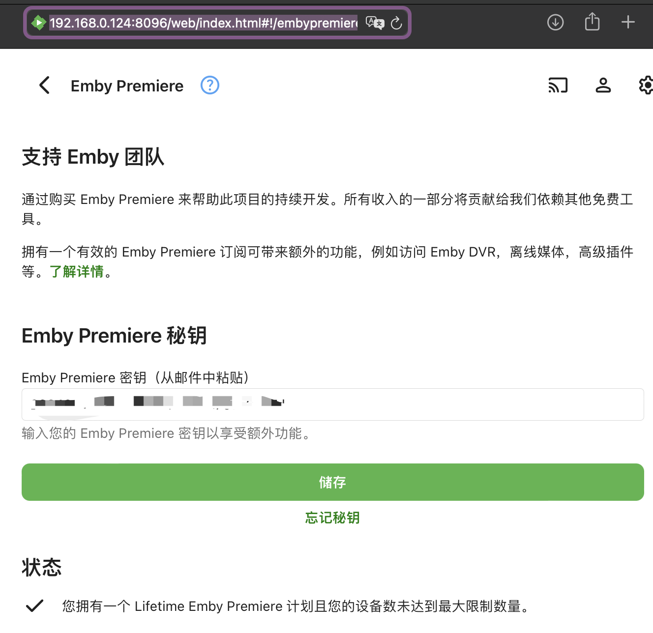

y965706254 0 Posted June 16, 2024 Posted June 16, 2024 兄弟,问题解决了。 在确保服务器和手机都能访问mb3admin.com的前提下。 打开软件,最后手机app打开,进入premiere菜单,先把输入框密钥移除,然后保存。当提示密钥移除成功,重新下服务器,然后再次填入密钥就可以了

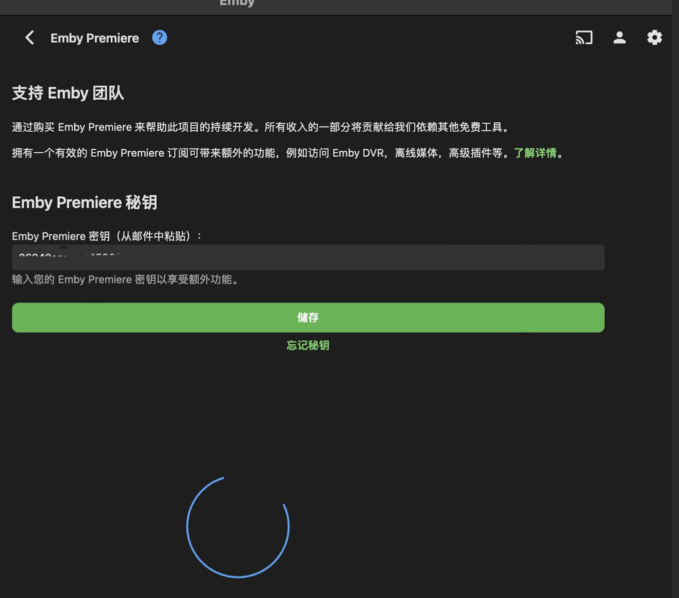

AckHuang 0 Posted June 16, 2024 Posted June 16, 2024 我也有同样的问题。我的EmbyServer之前安装在群晖NAS的docker中,使用正常。今天我卸载了docker中的EmbyServer,以NAS套件的方式重新安装在群晖NAS中。安装后我在通过浏览器设置了Embyserver的Premiere密钥、显示正常,并且通过浏览器可以播放硬盘,但通过Emby客户端播放时,提示我需要购买EmbyPremiere。并且通过客户端查看Premiere密钥时、虽然显示正确的密钥、但是没有显示密钥状态,界面上一直显示一个蓝色转圈。重新启动Embvserver后仍然是这样。移除密钥保存,显示移除成功,再填写密钥也没用。
AckHuang 0 Posted June 16, 2024 Posted June 16, 2024 已经解决。 1. 通过浏览器登录sever控制台,清掉密钥,保存。 2. 重启server。 3. 通过客户端登录server控制台,确认密钥是空的,然后填入密钥,保存。

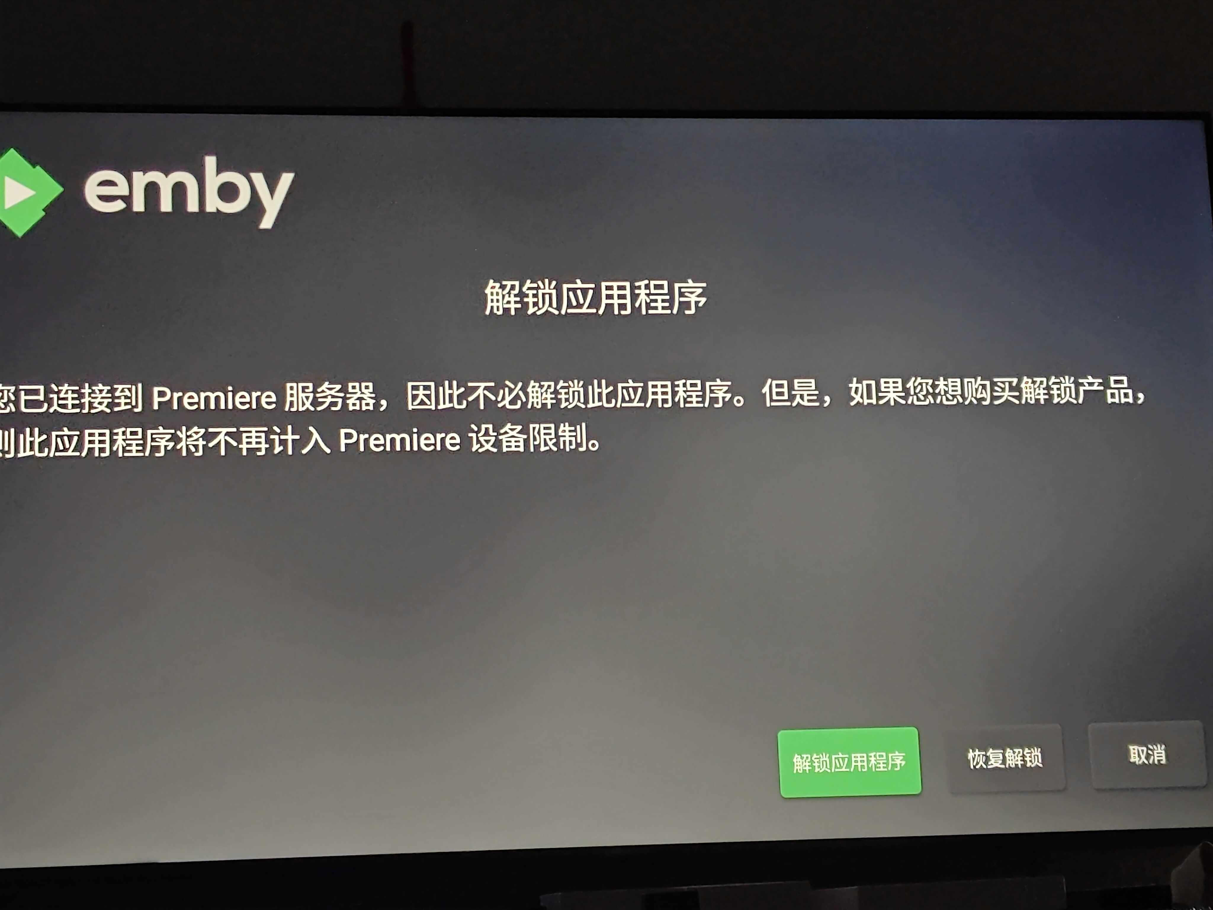

bbb100 0 Posted June 17, 2024 Posted June 17, 2024 我的google tv 中客户端。总提示还有几天就不能试用了,要订阅,其他客户端没发现。我是docker服务器。如何解决呢?谢谢。

bbb100 0 Posted June 18, 2024 Posted June 18, 2024 我秘钥是输入在服务器端,我已经输入了。手机客户端,电脑客户端使用都没问题。只是google tv 客户端 出现这种情况。按上边朋友的一些方法试过了,取消密钥,再重新添加,都试过了。没解决。
pwhodges 2039 Posted June 18, 2024 Posted June 18, 2024 Then this is almost certainly a problem with the client not having full access to the Internet - because the Premiere validation is done from each client, not just the server. Paul
ebr 16354 Posted June 18, 2024 Posted June 18, 2024 3 hours ago, pwhodges said: Then this is almost certainly a problem with the client not having full access to the Internet - because the Premiere validation is done from each client, not just the server. Paul Correct. Please be sure the device can reach our servers over the internet.
bbb100 0 Posted June 18, 2024 Posted June 18, 2024 So what should I do to get full access? My Google TV has no problem accessing the Internet because it has many other apps, all running normally and connected to the Internet.
