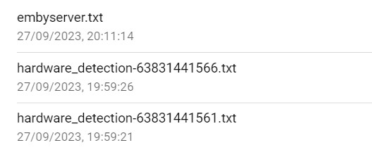

RobG69 2 Posted September 27, 2023 Author Posted September 27, 2023 OK I've send the log from the app at 20:09 UK time (UTC+1) and the user was Robin. The file playing at the time was: His Dark Materials - S3E01 - The Enchanted Sleeper.mkv I think you can ignore the server log I attached earlier. These are the logs that are available on the server from this evening but I don't know which one you need:
RobG69 2 Posted September 27, 2023 Author Posted September 27, 2023 I've attached embyserver.txt file anyway embyserver.txt
