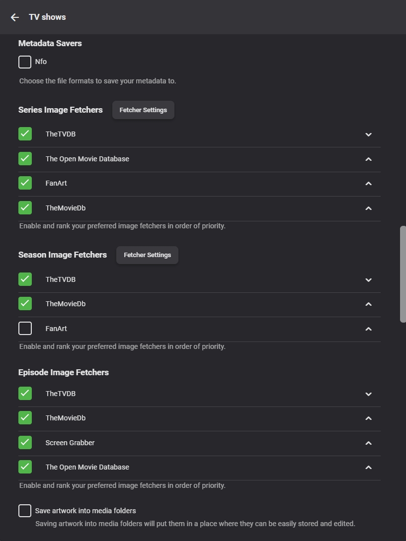

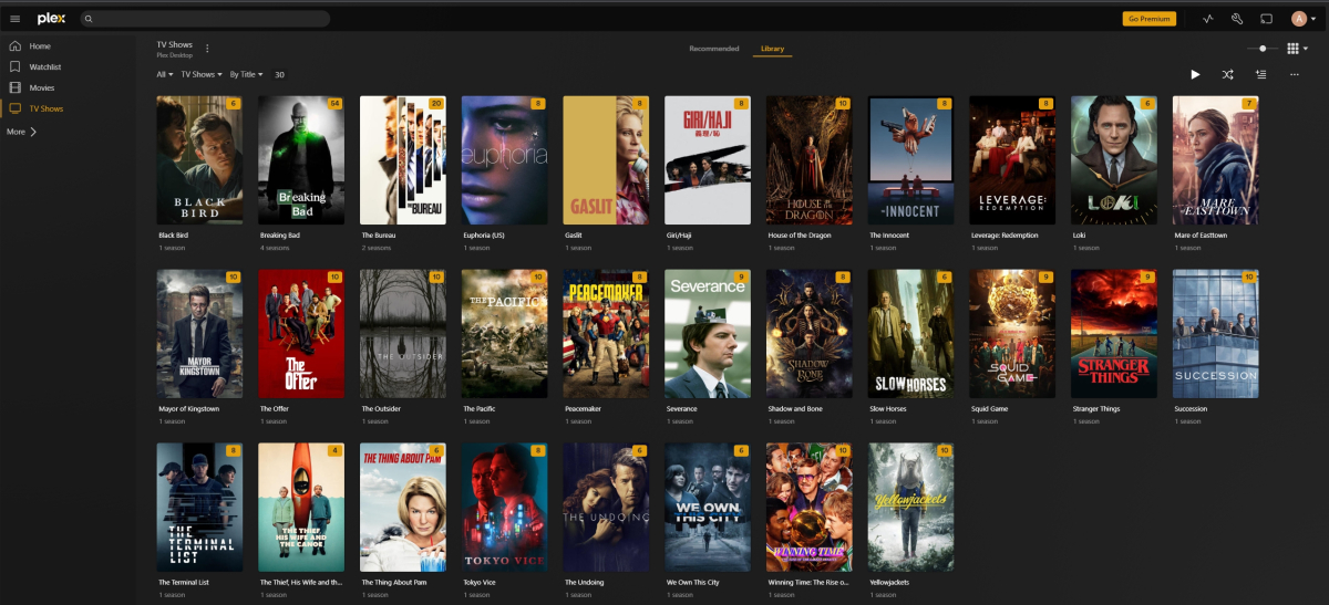

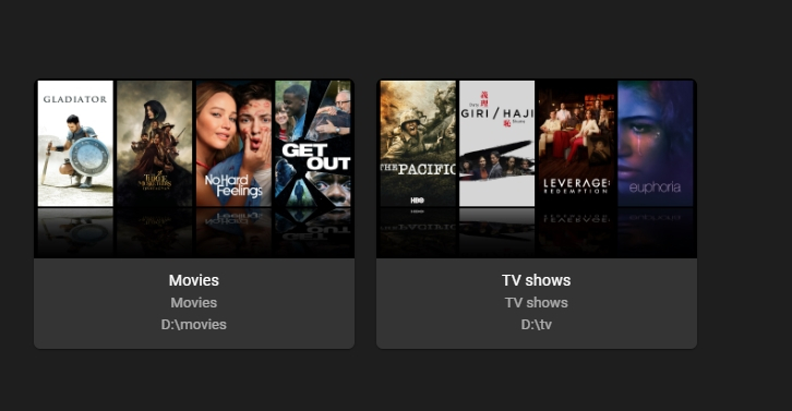

aldriglikvid 4 Posted September 23, 2023 Posted September 23, 2023 Hi, I have a problem that I want to "get to the bottom with" because I've decided to become permanent Emby user - It's a great application. But I have one issue... Emby never identifies my TV Shows, only Movies. Let's troubleshoot this: I have a folder of TV Shows on D:\TV The folders are D:\TV\SeriesName.S01.2160p.HDR.DTS-Group Here are the settings for TV Shows (3 pictures) : Everything above returns this below. I believe 1 show was identified automatically, all the identified you see here are manual: I spent 5-10 minutes installing Jellyfin and Plex just to benchmark. Standardsettings. Same folders. They identified everything. Jellyfin Plex As mentioned earlier, my fileserver is as following: D:\TV\SeriesName.S01.2160p.HDR.DTS-Group Below that folder, all the episodes are in one folder, like this: D:\TV\SeriesName.S01.2160p.HDR.DTS-Group\SeriesName.S01.EP01.2160p.HDR.DTS-Group.MKV Appreciate all the help. Thanks

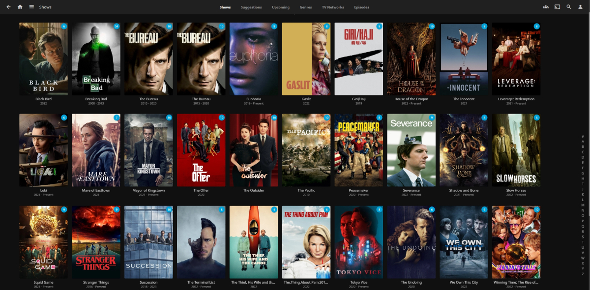

aldriglikvid 4 Posted September 29, 2023 Author Posted September 29, 2023 (edited) As requested by @LukeI did a full uninstall and new install of the beta version that was released today. Emby managed to identify 5 of 38 shows, with folders as per scene-standard and folders per a standard that Plex and Jellyfin can identify 100% without manual inputs. Not criticism, simply a statement. i.e: Disk \ Tv-Shows \ Show-name \ episode-file Edited September 29, 2023 by aldriglikvid

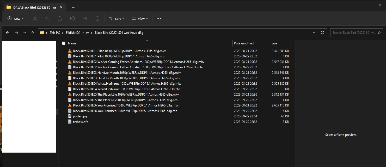

aldriglikvid 4 Posted September 29, 2023 Author Posted September 29, 2023 Blackbird identified, Euphoria not. Thinking of it, I believe I manually identified Blackbird last install so it might be that meta-data was saved in the folder. Can't confirm.
rbjtech 5335 Posted September 29, 2023 Posted September 29, 2023 So the immediate observation is that there is no Season folder but as you are using the latest beta, I believe this should no longer be an issue but I have not tested this myself. File naming itself looks perfectly fine. Once I test the beta, I'll be able to help further - or somebody else who has managed to use the .48 beta may be able to help...
