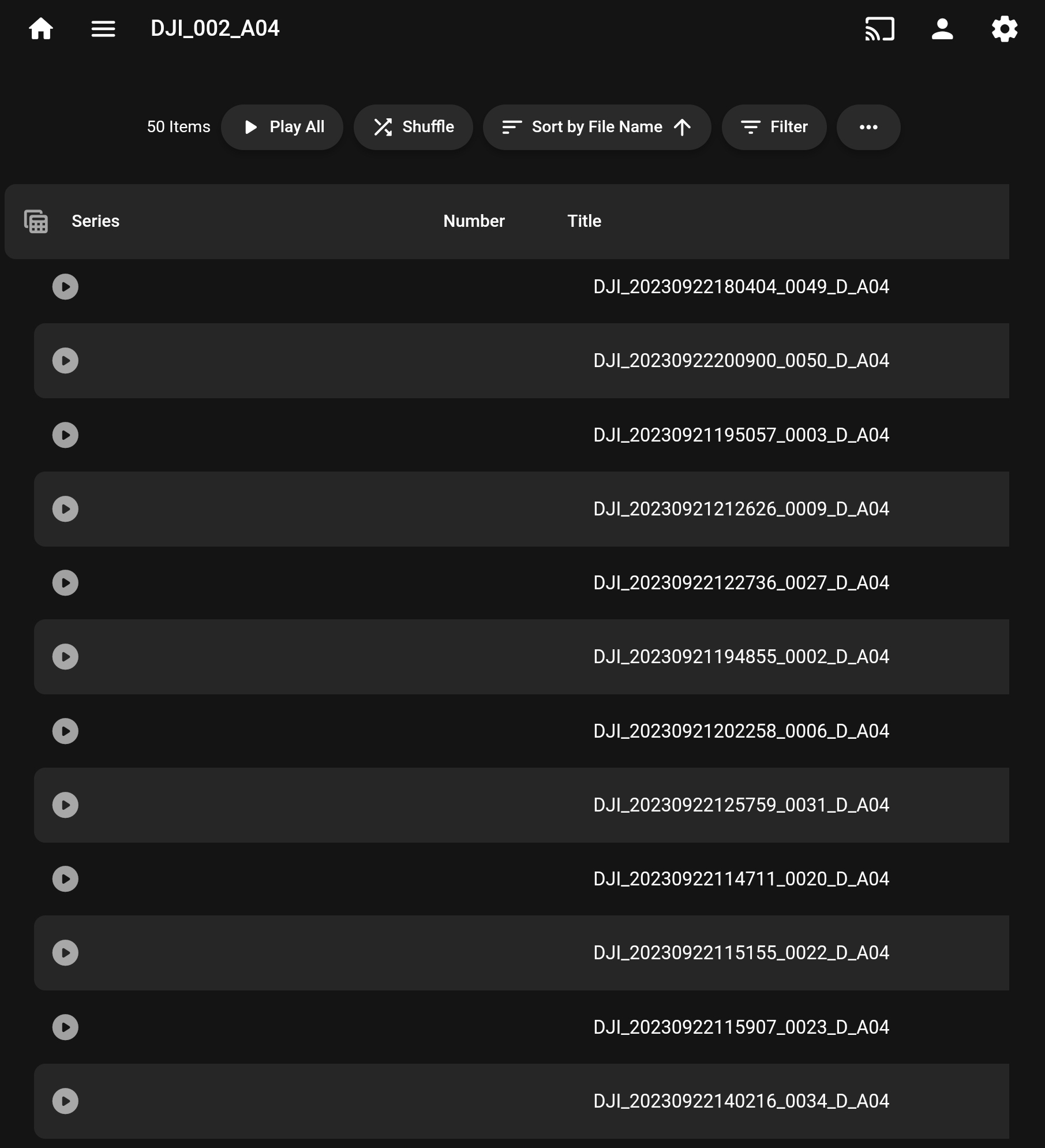

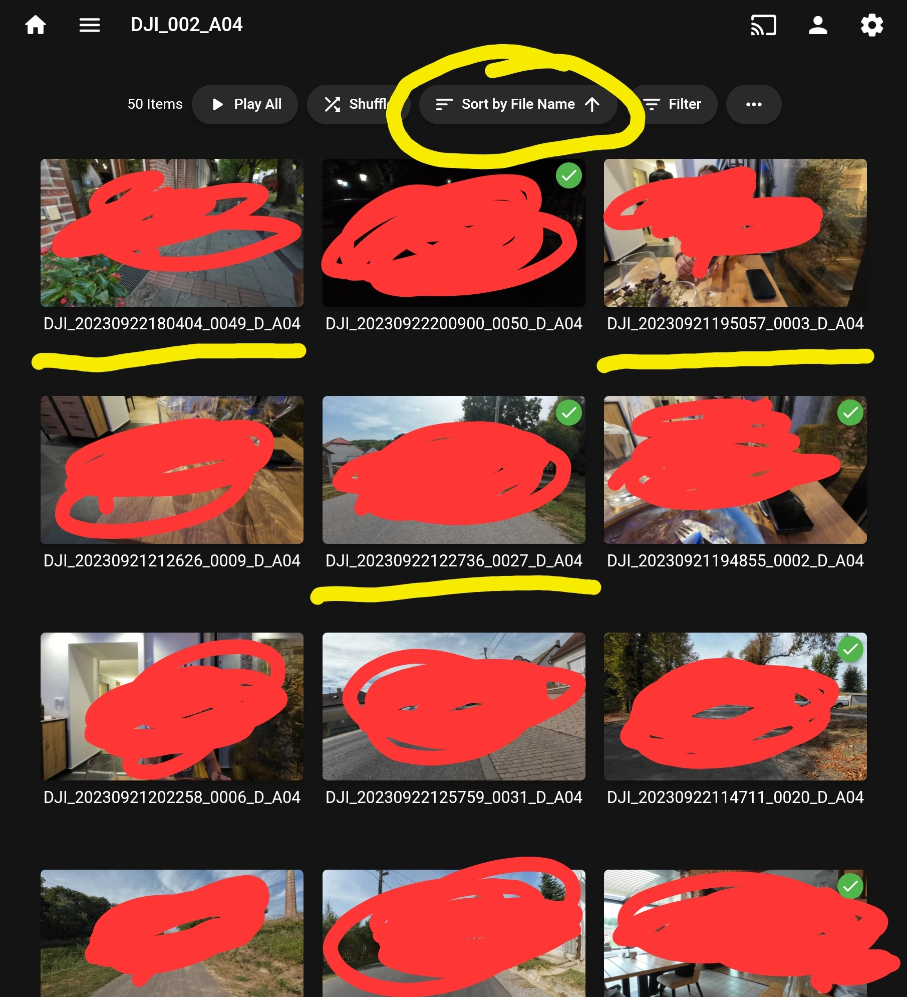

danergo 40 Posted September 23, 2023 Posted September 23, 2023 Hi, I'm using Emby 4.7.14.0. My library contains videos from a DJI camera. Nowadays they switched to a full date and time filenames, see my attached screenshot. The problem is sorting doesn't work at all (both sort by filename AZ and ZA results this screenshot). I'm also attaching the debug log. Can you spot something in it? Thank you! embyserver (2).txt

Luke 42185 Posted September 23, 2023 Posted September 23, 2023 2 hours ago, danergo said: Here is the directory listing: Table view is also buggy (ordering doesn't work at all), PLS see my attached image. What ordering doesn't work? There is no column ordering in table view, not yet at least.
Luke 42185 Posted September 23, 2023 Posted September 23, 2023 Anyway, I believe this sorting should be improved in the upcoming 4.8 server release. Thanks.
danergo 40 Posted September 24, 2023 Author Posted September 24, 2023 On 9/23/2023 at 8:26 PM, Luke said: What ordering doesn't work? There is no column ordering in table view, not yet at least. There is "Sort by filename up" selected, and files are in randomized order. I believe long filenames are the problem.

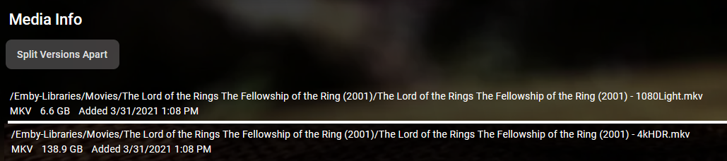

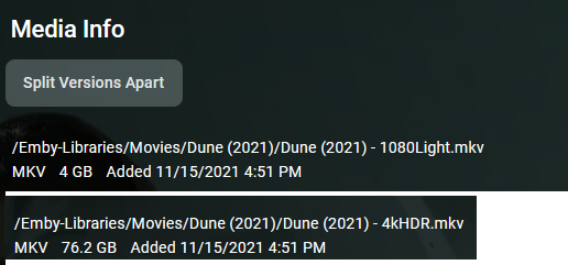

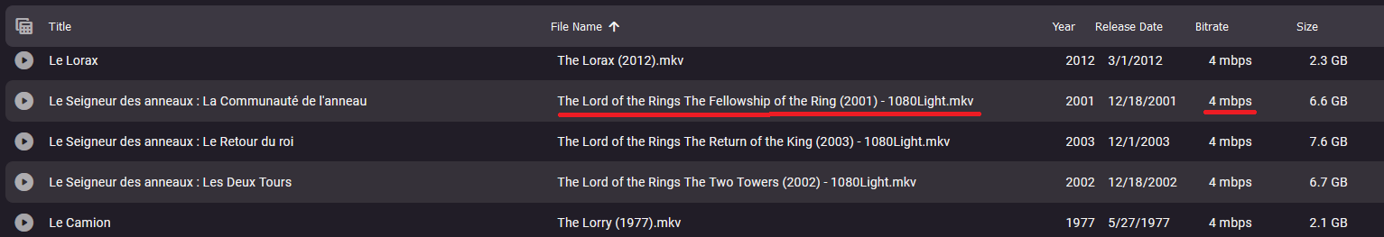

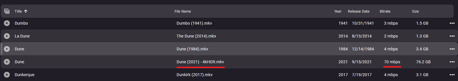

Okeur75 7 Posted October 5, 2023 Posted October 5, 2023 Hello, For information the issue appears also with "sort by bitrate" and "sort by size" with multi-version media. From what I've seen, emby takes into account the last version of the media you add. So if you have a 1080p version and a 4k version of the same movie, you copy the 4k version, then you copy the 1080p version, Emby will sort based on the information from the 1080p version. It is somehow confirmed by the Table view where you can see only one version of the media being taken into account. Below is an example with Dune (2021) for which I added the 4k version after the 1080p version, as well as The Lord of the Rings for which I did the opposite (added the 1080p version after the 4k one). I have of course both versions in the same folder as we can see for Dune (2021): PS: The "added" date is not accurate and takes into account the date the movie was added to emby, not the date of the file itself. 3988983 -rwxr-xr-x 1 emby emby 4302517115 Nov 15 2021 'Dune (2021) - 1080Light.mkv' 75882492 -rwxr-xr-x 1 emby emby 81804695212 Oct 4 21:36 'Dune (2021) - 4kHDR.mkv' I hope it can help improving the 4.8 server release
