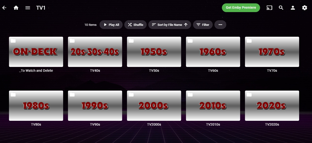

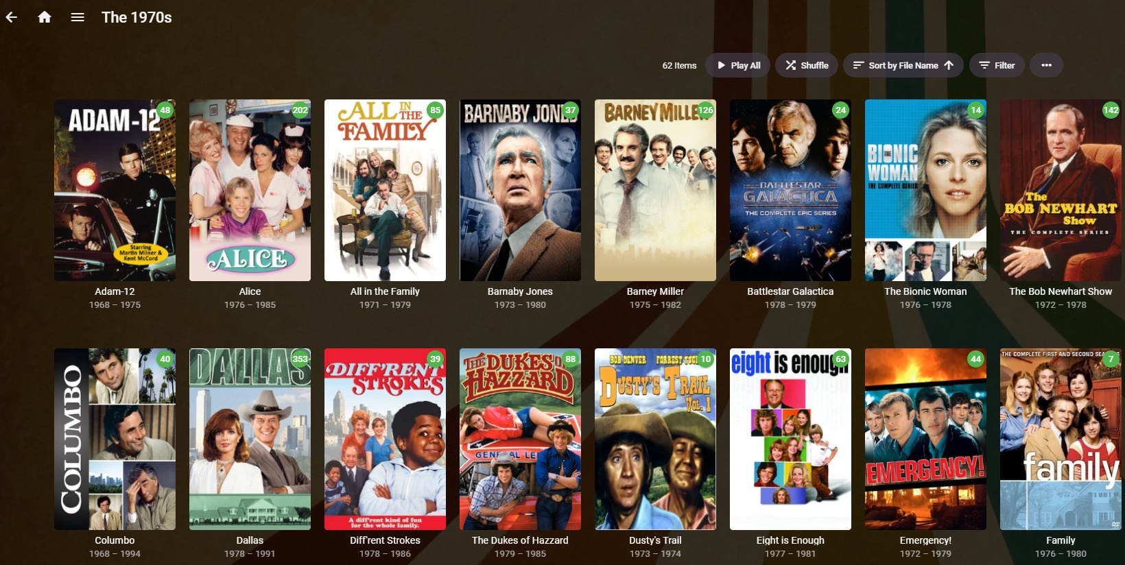

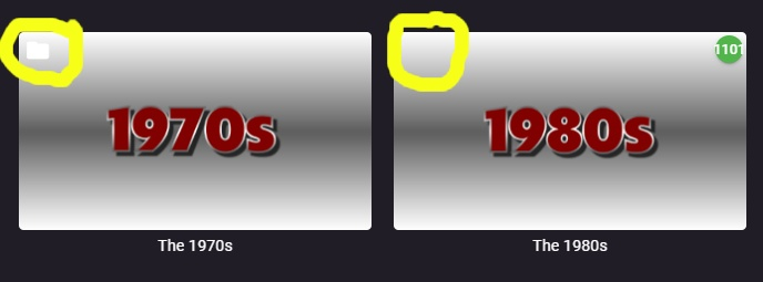

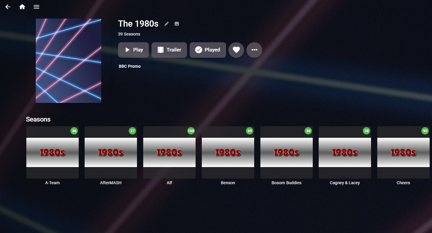

Daniel1966 6 Posted September 19, 2023 Posted September 19, 2023 I have several identical TV folders with Shows in sub-folders but they are being treated differently. Example 1: First thing to notice is how the main folder looks different Example 2: When I open 1970s, it looks how I would expect, and how I want all TV folders to open. Each Sub-Folder appears as a Show: Example 3: But when I open up 1980s, each show appears as a "season" of the non-existent show it thinks is "The 1980s": The folder structure of both folders is the same: I looked at the metadata and there are different fields for each folder....so it's like they are being treated as different "types" of content....even though they are the same. What do I edit to get them all to be treated the same? Thanks!

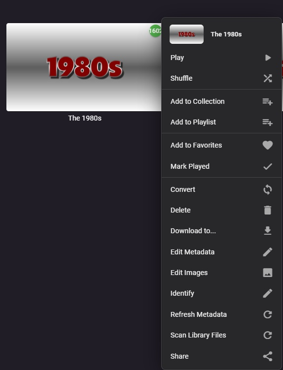

rbjtech 5335 Posted September 19, 2023 Posted September 19, 2023 It is picking up 'the 1980s' as an actual show - thus thinking each sub-folder under it is a season. Try adding 'The' infront of the folder name - and then force emby to remove identification (in the context drop down menu on the item) - and then it should re-identify. I would test with a small test library first.
Daniel1966 6 Posted September 19, 2023 Author Posted September 19, 2023 Thanks 5 minutes ago, rbjtech said: force emby to remove identification (in the context drop down menu on the item) - and then it should re-identify. Thanks for a fast reply! I don't know how to "remove identification"....Here is what I see....and don't see that as an option...

rbjtech 5335 Posted September 19, 2023 Posted September 19, 2023 3 minutes ago, Daniel1966 said: Thanks Thanks for a fast reply! I don't know how to "remove identification"....Here is what I see....and don't see that as an option... Ah maybe that is a Beta only option - are you on beta or the main release ? I have a 'remove identification' option ... 1

Daniel1966 6 Posted September 19, 2023 Author Posted September 19, 2023 Main release. Thanks. 14 minutes ago, rbjtech said: force emby to remove identification (in the context drop down menu on the item) - and then it should re-identify. Thanks for a fast reply! I don't know how to "remove identification"....Here is what I see....and don't see that as an option...
rbjtech 5335 Posted September 19, 2023 Posted September 19, 2023 ok - so if you just rename the folder '1980's' to 'The 1980's' - or something like that, then emby will see it as 'new' and hopefully not pick that up as a 'show' and then it will move to the sub-folders where it will start picking those up as 'shows' - which is what you want. A manual 'scan' once you have made the changes, will push things along - it may take a few minutes for things to sort themselves out .. 1

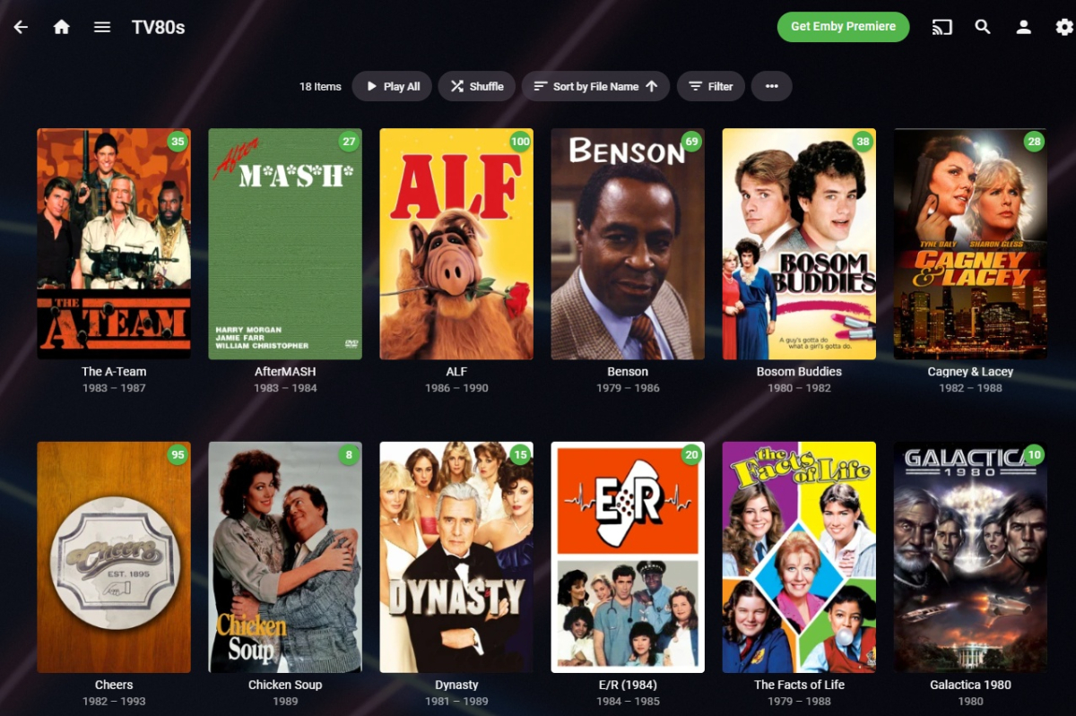

Daniel1966 6 Posted September 20, 2023 Author Posted September 20, 2023 If anyone is interested, it was a sub-folder titled "Galactica 1980 (1980)" that caused it to stop being read correctly. When I changed it to "Galactica Nineteen Eighty (1980)", it went back to normal..... Can anyone guess why having 1980 in the title, in addition to being the year it came out, messed things up?
