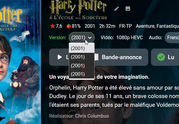

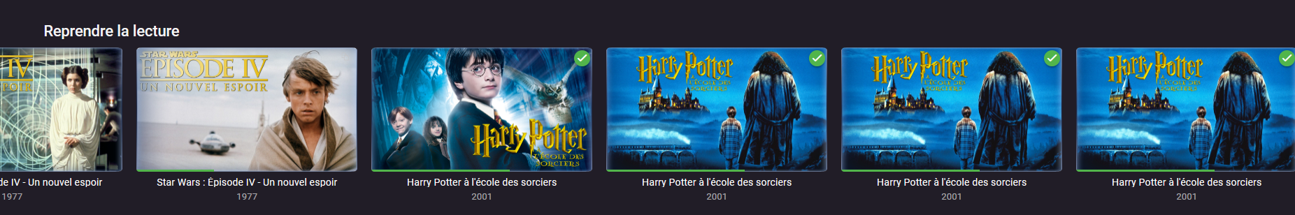

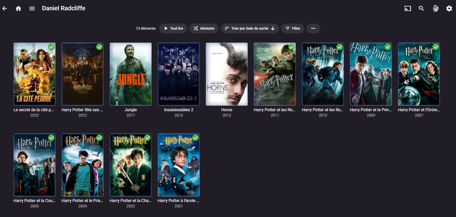

blap 3 Posted September 18, 2023 Posted September 18, 2023 Hi ! I encountering a problem in emby. In a search, Actor page ( or genre, or any detail ) even in resume section i have a lot of duplicate entry. I haven't any duplicate movie i send many exemple with Harry potter saga, but it's the same with a lot of another movie. Is there any solution ? i've try DB cleanup unsuccesfully. My serveur is on windows 10, up to date ( 4.7.14.0 ) The movie Library had 2 distinct folder. Each movie file has its own folder.

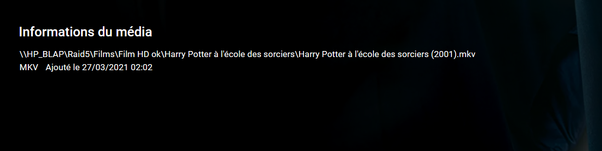

speechles 2060 Posted September 18, 2023 Posted September 18, 2023 What is the path shown for those? Is the same identical path shown for every one? You can find the path under the "Media Info" at the bottom of each items detail page. Can you show us what those paths are? Have you nested libraries?
blap 3 Posted September 18, 2023 Author Posted September 18, 2023 (edited) It's the same path for all t he four entry. A difference, however, after the moving / re-add action, the 3 extra entry only contain the path and no audio / video / subtittle information Edited September 18, 2023 by blap

blap 3 Posted September 18, 2023 Author Posted September 18, 2023 Yes, it's only for movies. In the navigation "folder" , there isn't any duplicate. It's only with a search or another detailed view. I already use the grouping function, but manually. Here, i don't want multiple version ( see attach exemple ). Is there any sql manual request that i can execute to delete all duplicate entry ( base on named column ) ?
