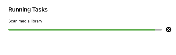

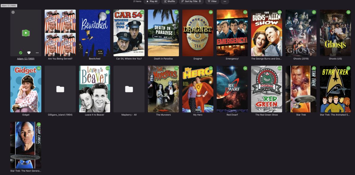

ImaginaryTango 2 Posted September 18, 2023 Author Posted September 18, 2023 Server log attached. It's close to 3 AM (yes, I'm a night person) and I'm pretty sure I started this scan before midnight. Here's a shot of the library I'm scanning: These are all shows I count on for non-disruptive background noise. When I started the scan, I had added Adam-12, Dragnet, and Gilligan's Island, so, all told, about 300-400 new episodes. It was over an hour before Dragnet showed all the episodes and the image showed up for it. The other two shows I added (Adam 12 and Gilligan) still show no episodes at all. For the past 2 hours (I think longer), this is the progress bar on the Dashboard: So it's looked like it was close to finishing for a good while, but just not finishing. Yesterday and the day before I found when I scanned the library again, after adding shows, it might see them within a few minutes, but would still take an hour or more before any of the new shows added would show any image to represent the show and it'd also take an extremely long time for Emby to provide any kind of episode count. embyserver.txt embyserver.txt
Luke 42185 Posted September 18, 2023 Posted September 18, 2023 Hi, it looks like its' just probing your media files for media info. I would just be patient and allow it to finish. I think this all should be slightly faster in the upcoming 4.8 server release. Thanks.
