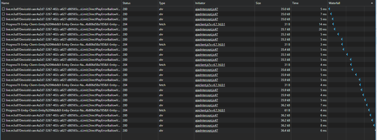

bruor 43 Posted October 13, 2023 Author Posted October 13, 2023 (edited) Started playback from the same channel. VLC directly via the provider's URL, as well as 3 devices via Emby with this morning. Limited them all to 4 or 5 mbps possible. Playback on chrome for windows froze, VLC direct, Roku, and CCwGTV are still playing. logs attached for the frozen stream. embyserver (1).txt ffmpeg-transcode-46651692-594c-4abd-a4db-7e370492e5af_1.txt Chrome console shows that the web client is still attempting to play, but the video/audio have stopped: Edited October 13, 2023 by bruor
