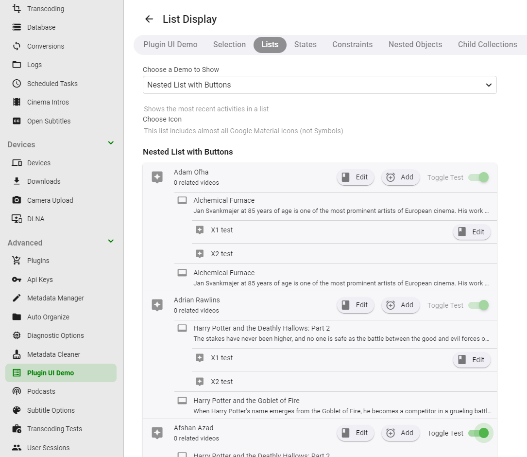

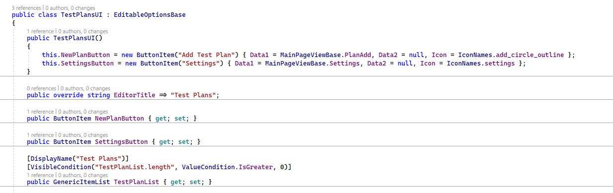

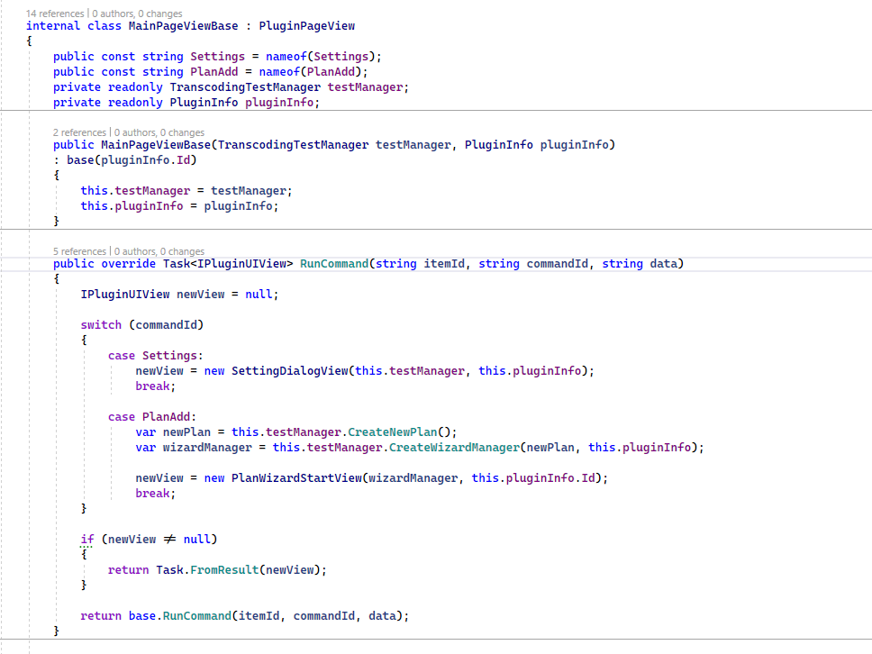

softworkz 5133 Posted September 20, 2023 Posted September 20, 2023 Oh, I see - there's no good example yet for buttons. Here's the code for the two buttons on the 2nd screenshot. The UI class: And the view class: Buttons are always causing a postback.What's important is to specify a commandId for the Data1 property. Then you just need to handle RunCommand in the view class.

bakes82 167 Posted September 20, 2023 Author Posted September 20, 2023 (edited) It tells me the command isnt found. NM: it wasnt returning and it was falling thru to the base. @softworkz public ButtonItem SplitMoviesButton { get; set; } = new ButtonItem { Data1 ="SplitMovies", Data2 = null, Caption = "Split Movies", Icon = IconNames.splitscreen }; public override bool IsCommandAllowed(string commandKey) { if (commandKey is "PostBack" or "SplitMovies" or "SplitTv" ) return true; return base.IsCommandAllowed(commandKey); } public override Task<IPluginUIView> RunCommand(string itemId, string commandId, string data) { if (commandId == "PostBack") { _logger.Info("in postback"); PluginUi.PathsToIgnore.RemoveAll(e => e.FolderPath.IsNullOrEmpty()); PluginUi.PathsToIgnore.Add(new FolderPathEO()); return Task.FromResult((IPluginUIView)this); } if (commandId == "SplitMovies") { _logger.Info("in split movies"); var manager = new MergeVersionManager(_libraryManager, PluginUi, _fileSystem, _logger); manager.SplitMovies(new Progress<double>()); } if(commandId == "SplitTv") { _logger.Info("in split tv"); var manager = new MergeVersionManager(_libraryManager, PluginUi, _fileSystem, _logger); manager.SplitEpisodes(new Progress<double>()); } return base.RunCommand(itemId, commandId, data); } Edited September 20, 2023 by bakes82

softworkz 5133 Posted September 20, 2023 Posted September 20, 2023 3 hours ago, bakes82 said: It tells me the command isnt found. You need to return the view which should be shown next. If the view should remain the same, you need to do like in the PostBack case: return Task.FromResult((IPluginUIView)this);
