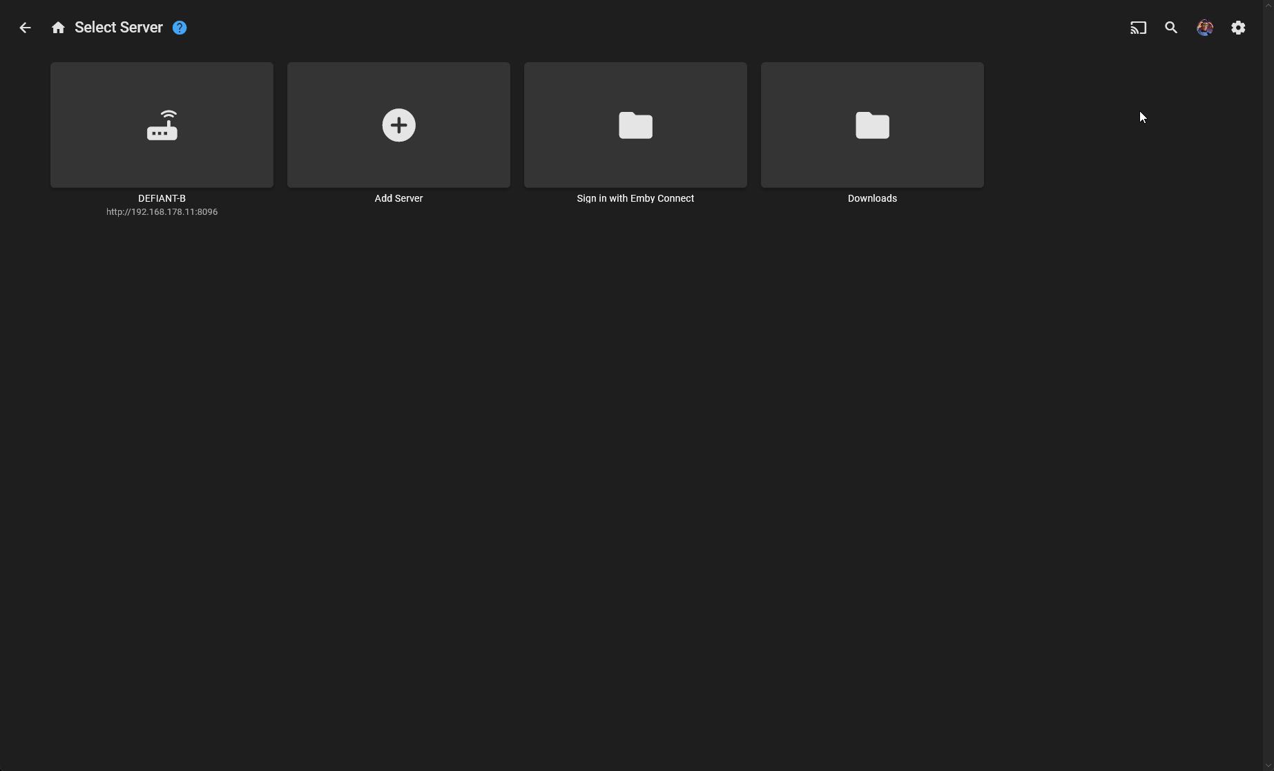

thevoidatlas 6 Posted October 30, 2023 Author Posted October 30, 2023 (edited) This problem has started up again. I can't delete a server that is in my list no matter how many times I try in the web app along with emby theater. I mainly use the web app though and I'd like to really be able to remove the server that no longer works as the url changed. Edited October 30, 2023 by thevoidatlas

thevoidatlas 6 Posted October 30, 2023 Author Posted October 30, 2023 It must be a new server install. My friend keeps changing things but he finally seems to have a stable build going. When i try to delete the server, nothing happens. The menu to delete the server doesn't show up, just the initial drop down. After that nothing happens when you click delete, It just closes.

thevoidatlas 6 Posted October 30, 2023 Author Posted October 30, 2023 4 hours ago, jaycedk said: @thevoidatlas From your latest post, it sounds like you don't manage the server, right ? I would call your friend and ask what up. Correct, I already asked him and he isn't sure why its still showing up. 1 hour ago, Luke said: What do you mean by this exactly? What is the initial drop down? Its the image I attached. The one that says, connect, delete and view server info. That works, but when you click delete nothing else pops up. It just closes and the dead server is still listed. I tried clearing cache, etc and that didn't help. Even used an alternative browser.
thevoidatlas 6 Posted November 2, 2023 Author Posted November 2, 2023 So i was able to delete one server but when i tried to delete another it stopped working again. Doesn't work in emby theater either. Is there a fix for this? This happens even when attempting to delete the server that is working, so its not because of the that. Just the second menu to approve the deletion never pops up.
Luke 42288 Posted November 15, 2023 Posted November 15, 2023 On 11/2/2023 at 2:40 PM, thevoidatlas said: So i was able to delete one server but when i tried to delete another it stopped working again. Doesn't work in emby theater either. Is there a fix for this? This happens even when attempting to delete the server that is working, so its not because of the that. Just the second menu to approve the deletion never pops up. Can you please try it from the hosted web app and then provide the contents of the browser debug console? http://app.emby.media Thanks.
