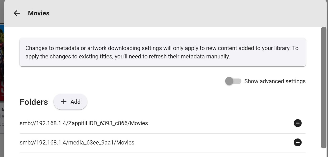

Luke 42245 Posted September 16, 2023 Posted September 16, 2023 6 hours ago, danpol said: ok I've added smb share can you check log and see if there are any problems thanks embyserver (3).txt 3.43 MB · 1 download What did you enter? System.ArgumentException: System.ArgumentException: First Section Requires IP-Address Format: zappiti4kdv at EzSmb.Paths.PathSet.Parse(String fullPath) at EzSmb.Node.GetNode(String path, ParamSet paramSet, Boolean isDirectory) at Emby.Server.Implementations.IO.SmbFileSystem.GetDirectoryInfo(String path) at MediaBrowser.Controller.IO.FileData.GetFilteredFileSystemEntries(IDirectoryService directoryService, String path, IFileSystem fileSystem, IServerApplicationHost appHost, ILogger logger, ItemResolveArgs args, Int32 flattenFolderDepth, Boolean resolveShortcuts) Source: Emby.Server.Implementations TargetSite: EzSmb.Paths.PathSet Parse(System.String) I would use the ip address in the path and not the name of the server machine.
Luke 42245 Posted September 18, 2023 Posted September 18, 2023 11 hours ago, danpol said: this is the way i did it That’s strange. I would have expected that to work. Can you try using unc paths instead?
danpol 12 Posted September 18, 2023 Author Posted September 18, 2023 It is working but i still see some errors in log
