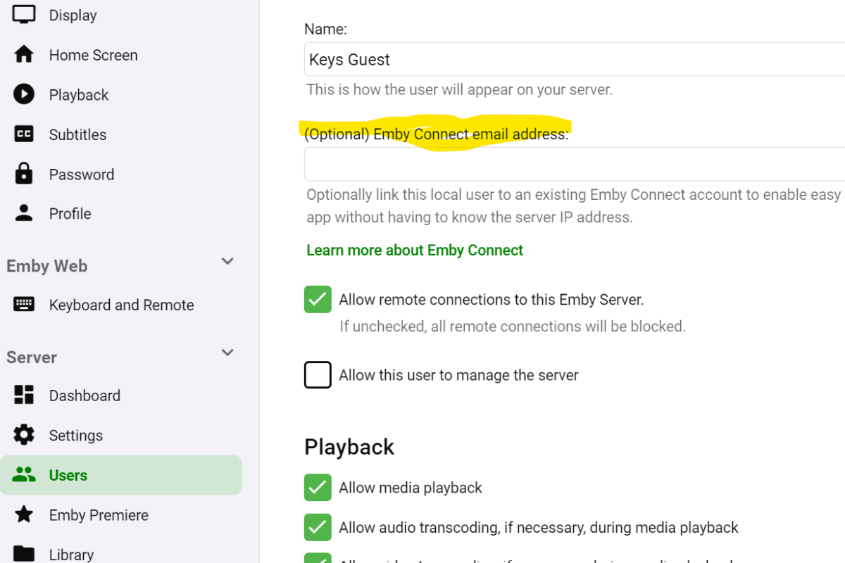

ebr 16337 Posted September 15, 2023 Posted September 15, 2023 Hi. On the server that is not working, try blanking out the Connect email address on the user setup and saving and then re-entering it and saving.
ebr 16337 Posted September 16, 2023 Posted September 16, 2023 3 hours ago, BGrind said: Where do I do this?

ebr 16337 Posted September 23, 2023 Posted September 23, 2023 13 hours ago, BGrind said: The same thing. I must login manually. When you re-entered the Connect email address, did you also click the link that was emailed to that address? Did it tell you it worked?
BGrind 0 Posted September 23, 2023 Author Posted September 23, 2023 Yes, I even deleted the account twice.
