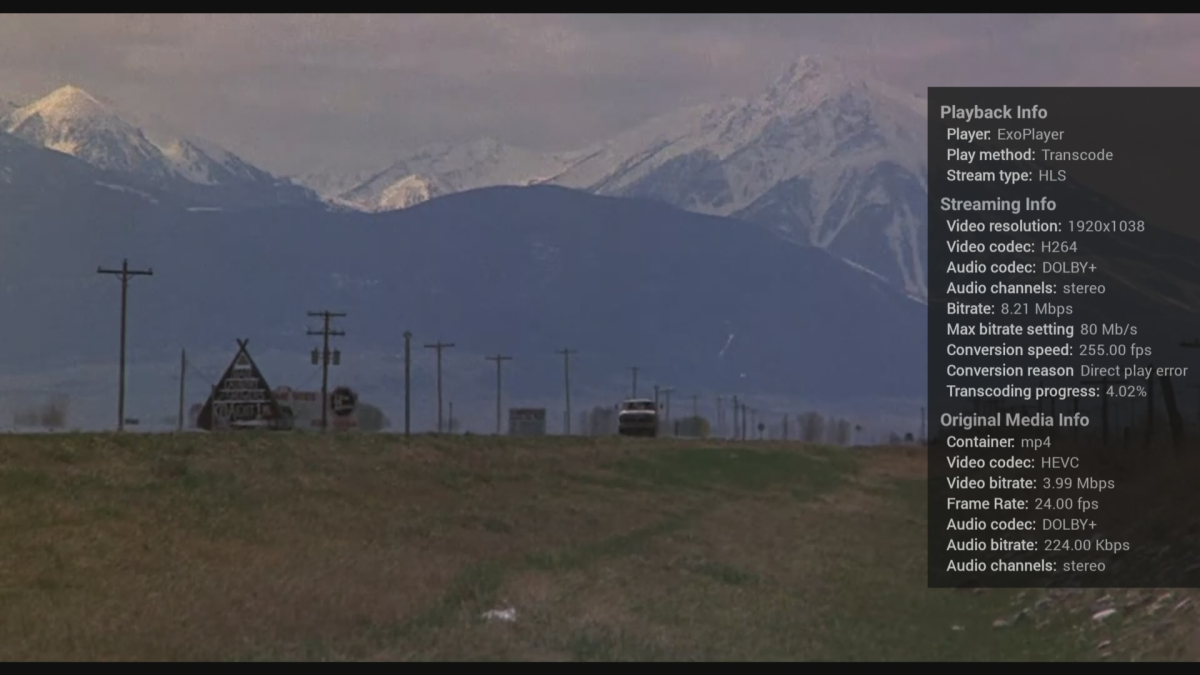

davidb7170 26 Posted September 13, 2023 Posted September 13, 2023 (edited) I noticed that since last weekend, my Emby for Fire Stick app is streaming some but not all video in Transcode mode, rather than Direct Play. I've narrowed down the issue to those rendered with a NUC i3 with Intel Iris Plus 665 play in Direct Play mode, while those rendered with my newer Intel A380 6 GB GPU are all being Transcoded. Stats for Nerds indicates the reason for Transcoding is Direct Play Error. My standard MP4 files are rendered in H.265 (HEVC) at 10 Bit depth, and AC3 or E-AC3 audio, depending on the source file. All are rendered on Handbrake. I am on the current version 1.6.1 (2023012300), but have been using it for several years. I replaced all my Fire Sticks with the 4K version so that Emby could Direct Play the HEVC files, and not tie up my server's GPU. On looking into this, I looked up the Emby for Fire Stick app on my app store, and they indicated the version I currently have in my 4 Fire TV Stick 4K units are on Emby For Fire Stick Version 2.0.93a. The app store info indicated the last update was September 9, 2023, last Saturday. I did not see the update happen, so it must have occurred automatically in the background on my Fire Sticks. The odd thing is that the Direct Play works on version 2.0.93a on the NUC-rendered files, but not on the A380 GPU rendered files. I purchased the A380 GPU in February 2023. It renders more than twice as fast as the NUC and does a very good job, but apparently there is a difference in the files that the Emby For Fire Stick App now chokes on, where it did not in the prior version. I also have an LG smart TV with Emby for LG Version 1.0.39 that currently plays all of these same files in Direct Play with no issues. My Fire TV Stick 4K's are on Fire Stick's Fire OS 6.2.9.7 (N56297/4660), except for one that during this process of discovery, I updated to Fire OS 6.2.9.8 (N56298/4758) as it was available and I wanted to see if that would clear the issue. It did not. I also know that this Fire Stick OS update is fairly recent, last couple of weeks, but the Direct Play problems didn't appear until last weekend. I included the Fire Stick OS info in case that may be a factor, but the timing would point more towards the Emby for Fire Stick version 2.0.93a as a likely issue. Please advise. Thanks, Dave Edited September 13, 2023 by davidb7170 typo

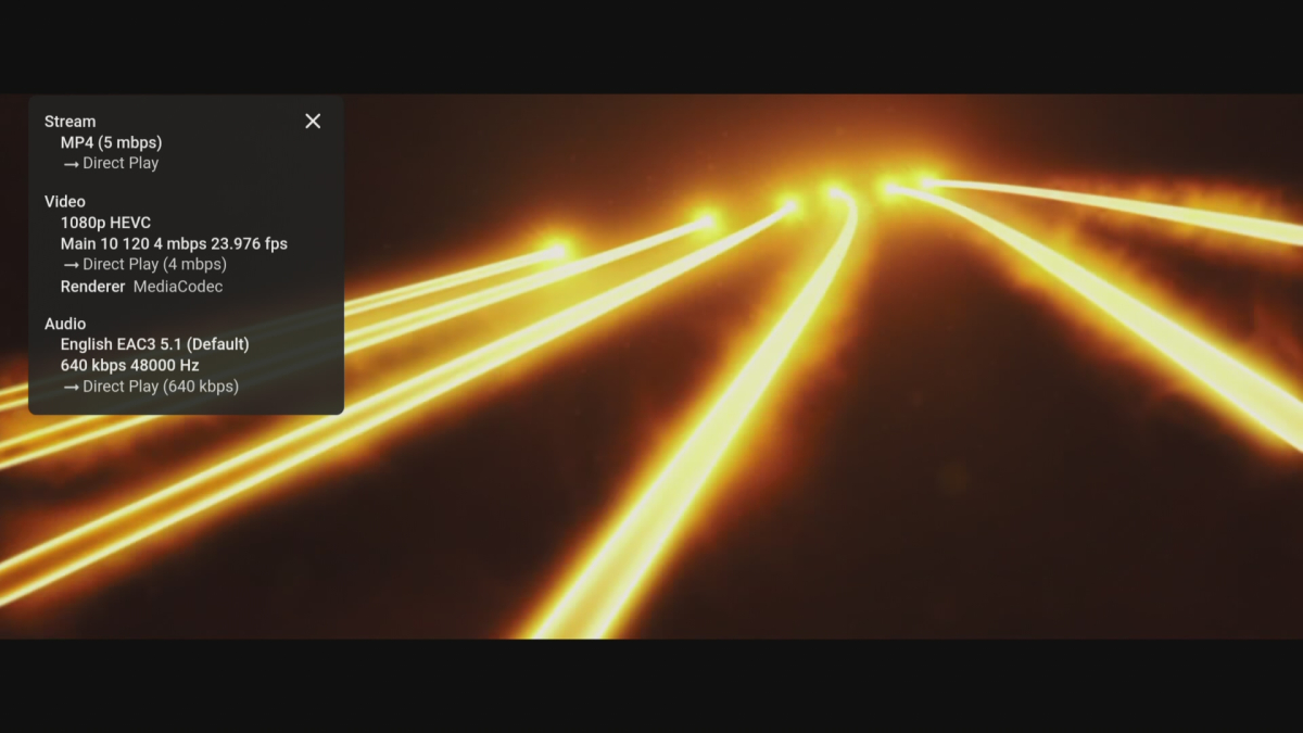

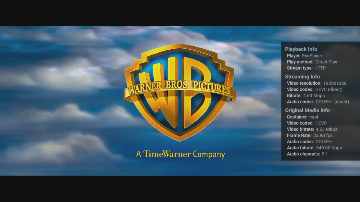

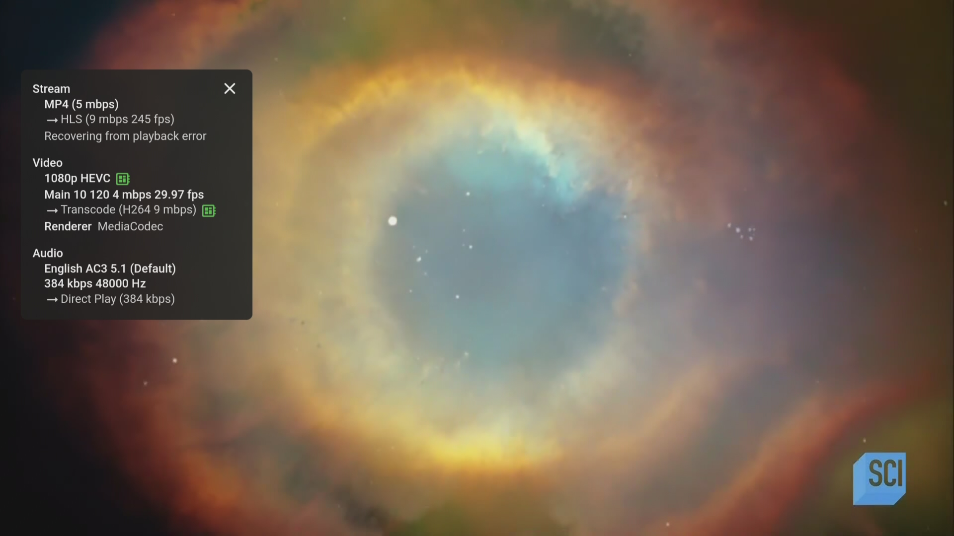

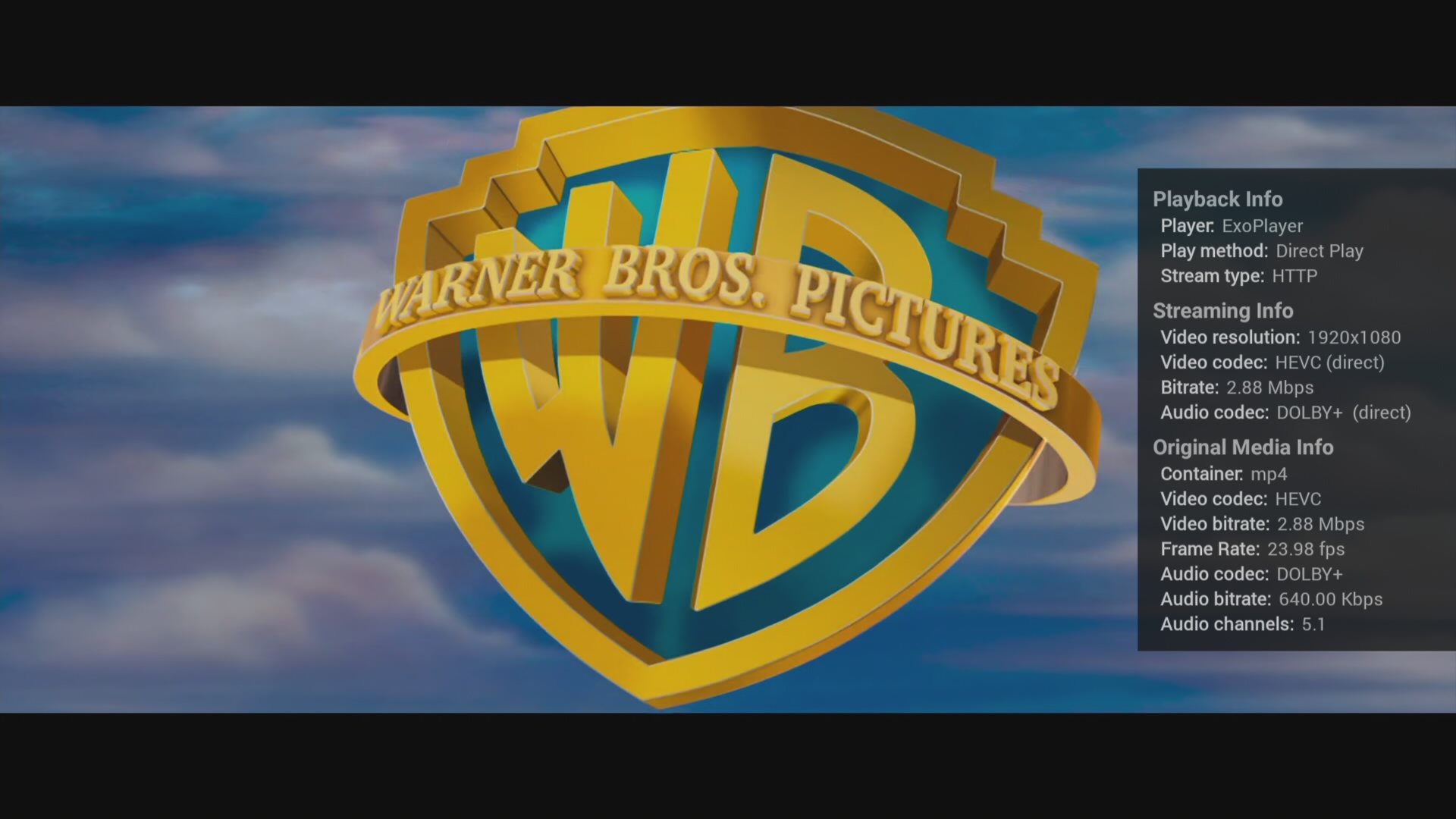

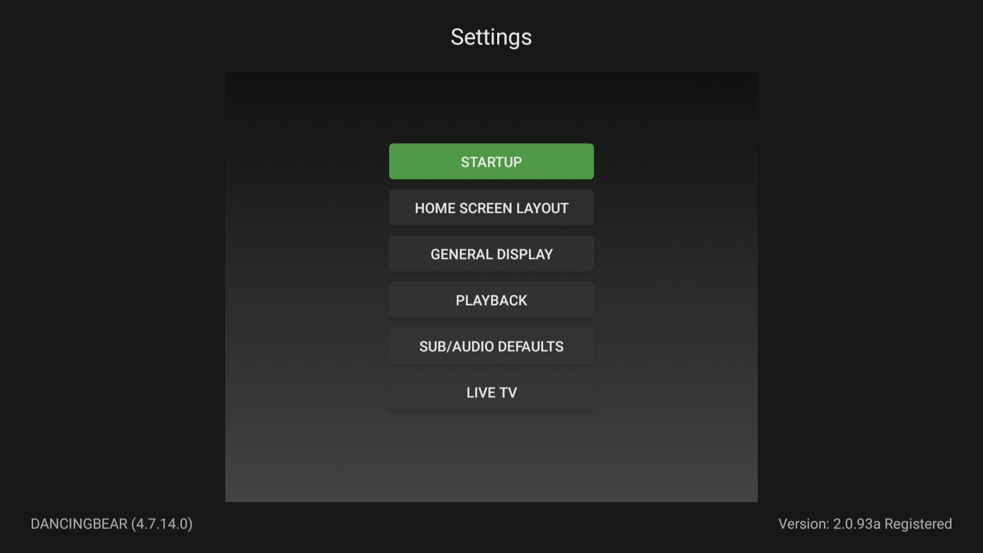

davidb7170 26 Posted September 14, 2023 Author Posted September 14, 2023 Yes, when playing them again, they still transcode if they did before. I was able to take screen shots (see attached jpg's) of the Fire Stick 4K outputs. The first image 0002 is the Emby Fire Stick app settings screen showing the current version 2.0.93a. The second and third 0003 and 0004 show Stats For Nerds data of files that transcode. The fourth and fifth 0005 & 0006 show files that Direct Play. All the Stats For Nerds captures are from different files. I flipped through my library and found files that play direct and files that transcode. In every case I checked, the transcoding files show Stream Type: HLS and Conversion Reason: Direct play error. The files that play direct all showed Stream Type: HTTP. I know that HTTP is a network protocol that is familiar, assuming it means what it usually means, but I'm not familiar with HLS, though. It's not a rendering difference I made from file to file that I'm aware of. Ok, looked it up: HTTP Live Streaming (HLS). Now I'm confused, so does Stream Type: HTTP mean HLS anyway? I found some files that were rendered before I changed from the NUC to the Intel Arc A380 GPU to render with, so it's not only A380 files that don't stream direct, but some NUC files as well... It's just that all the A380 GPU rendered files don't play direct at this point. That was my first impression that something was different with the A380 GPU output, but that theory kind of goes out the window, I guess, when I found NUC rendered files that also need to transcode for some reason. Were you able to find anything in the log files? Thanks for your looking into this. Dave

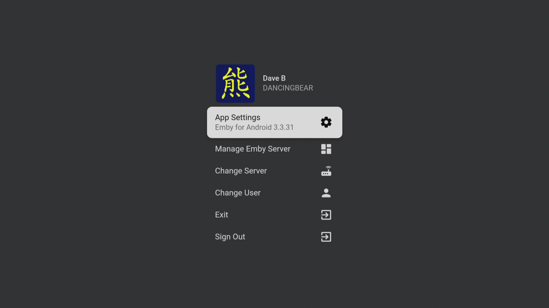

davidb7170 26 Posted September 15, 2023 Author Posted September 15, 2023 I got the arm7 apk sideloaded successfully, and it functions, but the same outcome occurs on the same sets of files. The ones that Direct Played on the Firestick Emby 2.0.39a App still played on the Android 3.3.31 version. and the ones that transcode on FS app still transcode on the Android app, so think they both have issues, was worth a try... I uninstalled the FS app and cleared the cache prior to sideloading the Android version, just to be safe. They both just identify as "Emby", so didn't want to confuse the issue when using it. Since the android app sideload had the same issues, I will probably uninstall it and reload the FS 2.0.39a version until a revised version comes out that fixes the issue. If you wish, I can re-render a short section maybe 5 or 10 minutes of a file on both my NUC and my Intel A380 GPU. I did this in my investigation with some files, the NUC ones Direct played and the A380 ones transcoded when played. That's why I went down that line of thought initially, but I did find a rare few that were NUC files that also transcode when played on the current Emby for Firestick and the android app. The A380 files transcoded whether it was HEVC 8 bit or 10 bit depth. Please advise. Thanks Dave

davidb7170 26 Posted September 19, 2023 Author Posted September 19, 2023 If you're referring to the apps' Stats for Nerds, yes each time. The firestick app always says "Direct Play error", and the android app always says "Recovering from Direct Play error", so not much info there... No other details. Dave

davidb7170 26 Posted September 20, 2023 Author Posted September 20, 2023 (edited) Ok, finally found the place to enable it to send debug logs direct on the Fire TV app, and sent you one directly. It's from my PC room Fire Stick 4K on a 4K LG pc monitor a couple of minutes ago. Also to correct my replay to Luke above "...android app always says "Recovering from Direct Play error", so not much info there..." actually the android app always says "Recovering from playback error" when it transcodes... I remembered it wrong when I wrote my reply. Thanks Dave PS - the Ling Room TV is still the only one where the Fire TV app is Direct Playing, and the android app is Transcoding, still today. I watched a full movie on Fire TV Direct Playing this morning. Only one of my 4 Firestick 4K's that is in that state... Edited September 20, 2023 by davidb7170 added a comment
