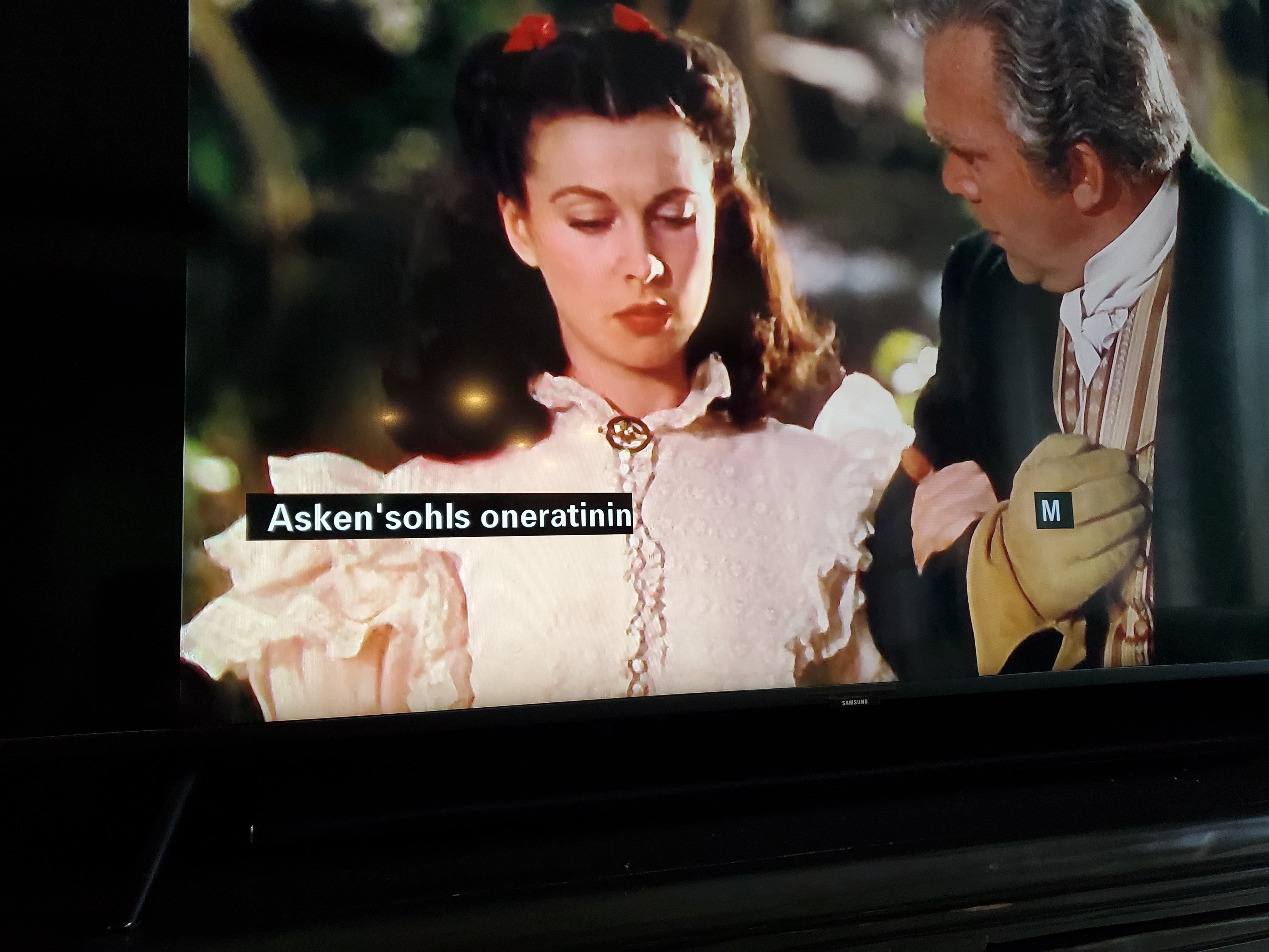

Ronstang 294 Posted September 12, 2023 Posted September 12, 2023 This is happening on a Samsung Smart TV at my parents' house. I don't own any Samsung TVs and I have never seen this issue so I assume it's a Samsung thing. All my movies are MKV and HEVC. The files I am having issue with are all from TCM. I'm getting gibberish subs that are black boxes with white letters. I have no control over them through emby as turning off the SRT subs (which are displaying correctly) does not make the problem subs go away so they are on all the time but are random letters and unintelligible. I have included a picture. I am still at my parents so later when home I will add the log but I don't think this is emby.....I think this is a Samsung issue bur I don't own any so I have no way of.experimentong at home. Maybe there is a a setting that I need to change on the TV but I have no idea.

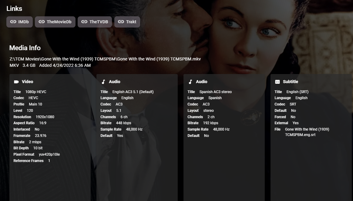

Ronstang 294 Posted September 12, 2023 Author Posted September 12, 2023 Here you go Luke, is this what you want?
Luke 42239 Posted September 12, 2023 Posted September 12, 2023 OK, have you checked the contents of the srt to double check that it doesn't contain that text? This wasn't hevc recorded from live tv, was it? The only other thing I can think of is if the video has closed captions embedded, which usually we detect so it would have shown up in this screenshot.
Ronstang 294 Posted September 13, 2023 Author Posted September 13, 2023 4 minutes ago, Luke said: This wasn't hevc recorded from live tv, was it? Yes, 90% of my current content is recorded from Cable TV, mostly Turner Classic Movies. No, that text is not in the SRT file, I just verified that even though I knew it wasn't. I have played my content on many different devices now as testing and this is the first time I have had this problem and these gibberish subs show regardless of whether subs are turned on or off in emby. Now...I will say that if I open my files in MPV directly they all show 1 more subtitle track than they actually have which are more than likely embedded and most times it is just the same as the SRT file if it even plays while sometimes it won't show and sometimes it shows gibberish. I just checked this file that I had trouble with and sure enough the second sub track that MPV shows does play and it is the exact same gibberish as what I experienced at my parents. But this is the first time this has ever happened so it is still a bug in the app on the Samsung.
Luke 42239 Posted September 13, 2023 Posted September 13, 2023 1 minute ago, Ronstang said: Yes, 90% of my current content is recorded from Cable TV, mostly Turner Classic Movies. No, that text is not in the SRT file, I just verified that even though I knew it wasn't. I have played my content on many different devices now as testing and this is the first time I have had this problem and these gibberish subs show regardless of whether subs are turned on or off in emby. Now...I will say that if I open my files in MPV directly they all show 1 more subtitle track than they actually have which are more than likely embedded and most times it is just the same as the SRT file if it even plays while sometimes it won't show and sometimes it shows gibberish. I just checked this file that I had trouble with and sure enough the second sub track that MPV shows does play and it is the exact same gibberish as what I experienced at my parents. But this is the first time this has ever happened so it is still a bug in the app on the Samsung. If it is closed captions then it could be that they're not showing elsewhere because they just don't support it with hevc yet.
Ronstang 294 Posted September 13, 2023 Author Posted September 13, 2023 (edited) 9 minutes ago, Luke said: If it is closed captions then it could be that they're not showing elsewhere because they just don't support it with hevc yet. Not supported? These are even present in h.264 files and they don't show in emby. They only show in MPV when selected. They are not selected in emby so they should not be playing but they play all the time, there is no option to turn them off......so this is a BUG in the app, it cannot be anything else. Unless it has something to do with the version of the video player on the Samsung TVs. Either way, it's a bug. This does not happen on my Sony TVs, nor my LG TVs, nor on my Firesticks. It's a bug not a feature. LOL Edited September 13, 2023 by Ronstang

Ronstang 294 Posted September 14, 2023 Author Posted September 14, 2023 10 minutes ago, SamES said: I've tried numerous players but can see any issues. Maybe Luke might have more success? Play it in MPV, and these are embedded CCs obviously so they don't show in most players and are off by default in MPV but the subs tab will say 0/1 so you then click on it and turn them on, then they display. And these are exactly what I am seeing always using the Samsung TV.
SamES 1084 Posted September 14, 2023 Posted September 14, 2023 41 minutes ago, Ronstang said: Play it in MPV, and these are embedded CCs obviously so they don't show in most players and are off by default in MPV but the subs tab will say 0/1 so you then click on it and turn them on, then they display. And these are exactly what I am seeing always using the Samsung TV. What model TV? Can you attach a server log from playback on the TV? The server log you posted earlier doesn't have any Samsung TV playback events. What version number of the Samsung TV app are you using?
SamES 1084 Posted September 14, 2023 Posted September 14, 2023 I can only see these in handbrake, no other tool sees them They are EIA-608 captions and they're part of the video stream. https://en.wikipedia.org/wiki/EIA-608 Apparently the only way to remove them is to re-encode the video and strip them out. https://stackoverflow.com/a/51439554 Can you follow these instructions on you TV and make sure Closed Captions are off or disabled in the TV settings Closed captions and other accessibility settings for your Samsung TV
Luke 42239 Posted September 14, 2023 Posted September 14, 2023 Right, I think right now, the only video players and tools that can see those subtitles are going to be ones that have been updated to detect EIA-608 in hevc. So for us, on the server, that means in our ffmpeg build.
