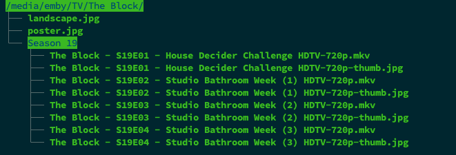

targetcom 1 Posted September 18, 2023 Author Posted September 18, 2023 On 15/09/2023 at 21:52, Luke said: Yes screenshots of the folders would be great. Thanks.
targetcom 1 Posted September 18, 2023 Author Posted September 18, 2023 On 15/09/2023 at 21:52, Luke said: Yes screenshots of the folders would be great. Thanks. Ok here is the screen shot, i have only added season 19 in otherwise it would be huge

Solution GrimReaper 4845 Posted September 19, 2023 Solution Posted September 19, 2023 The only think that comes to mind is that it has already been merged with some other series so your latest scan before posting log wouldn't show anything. What you can try is: 1. Remove "The Block" series folder from your TV shows root 2. Run Scan media library scheduled task 3. Rename series folder to "The Block (2003) [tvdbid=74768]" 4. Put it back in TV shows root 5. Run Scan media library scheduled task (6. Post server log if it didn't appear). 1

targetcom 1 Posted September 19, 2023 Author Posted September 19, 2023 23 minutes ago, GrimReaper said: The only think that comes to mind is that it has already been merged with some other series so your latest scan before posting log wouldn't show anything. What you can try is: 1. Remove "The Block" series folder from your TV shows root 2. Run Scan media library scheduled task 3. Rename series folder to "The Block (2003) [tvdbid=74768]" 4. Put it back in TV shows root 5. Run Scan media library scheduled task (6. Post server log if it didn't appear). Ok so i did these steps and something weird happened, it picked up the series but the images were from a different series to i did a refresh on the meta data and it corrected it self. so it does look like it was some sort of conflict. what could have caused this and should we not have some sort of series editor so that we can manually fix this like sonarr's series editor ?

GrimReaper 4845 Posted September 19, 2023 Posted September 19, 2023 1 minute ago, targetcom said: it picked up the series but the images were from a different series You likely have saving artwork into media folders enabled, and as said: 29 minutes ago, GrimReaper said: it has already been merged with some other series So you've had that series images stored with media and local metadata/artwork always takes precedence. 3 minutes ago, targetcom said: i did a refresh on the meta data and it corrected it self Yep, that's the correct procedure. 3 minutes ago, targetcom said: what could have caused this It's either the order of results returned from provider on the initial query OR some other already existing series with similar name; since "The Block" doesnt assist much in pinpointing when there are multiple possible results, adding (at least) Year and (preferably) ProviderID to series folder name goes a way toward eliminating misidentification.
