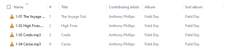

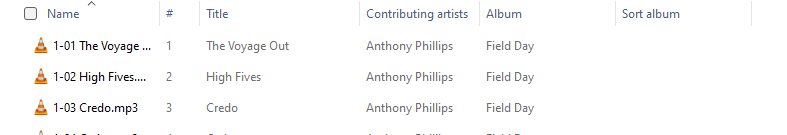

Raelone 19 Posted September 10, 2023 Posted September 10, 2023 I have Emby monitor my iTunes library folder. It picks up the songs, artists etc., but not as an album. I understand it reads from the tag information, but it seems that instead of the Album tag, it is reading the sort Album tag because if I go in and set the sort album tag it is now showing in Emby. By default though iTunes does not add the sort album tag when adding songs. Any way we can get it to use the album tag itself? This won't show as an album This does now show up

Raelone 19 Posted September 10, 2023 Author Posted September 10, 2023 Nope, all single artist. Everything without a Sort Album does not show, they all have an album. I have more than 2000 albums all the same problem - Album only does not show Album + Sort Album shows. Once I add the Sort Album name to the tag they show up in Emby as an album. Plex has no issues and I understand Plex also reads the idv tag. Every entry in my iTunes has the Album tag set. I also remove any contributing artists etc. so they only show for the primary artist. I tested it on ~25 albums last night, and every one of them would not show the album until I set the sort album for that album.

Solution Raelone 19 Posted September 11, 2023 Author Solution Posted September 11, 2023 Ok looks like it was a combination of Album Artist (Band in id3 terms) not being set (Artist, LeadArtist, being set was not enough) and the id3 being V2.4. Setting the first was not sufficient. I did have to bring the version back down to 2.3. iTunes was setting the Album artist too when setting the album sort and setting the version to 2.3 which is why I thought it was the album sort causing it. I'm not sure why you would not fallback to the first entry of the Artist if Album Artist is empty especially if there is only 1 entry in Artist. Seems logical especially considering there are probably setup like I am of putting everything into iTunes and just mirroring the iTunes directory. iTunes concentrates on Artist more than Album Artist. Just my opinion. I wrote a quick little app to do both of these things and mass update the 44,000+ files in my iTunes directory so after an hour I now see all the albums instead of just a few. If just 1 song on an album had it's album artist set the whole album appears complete.
