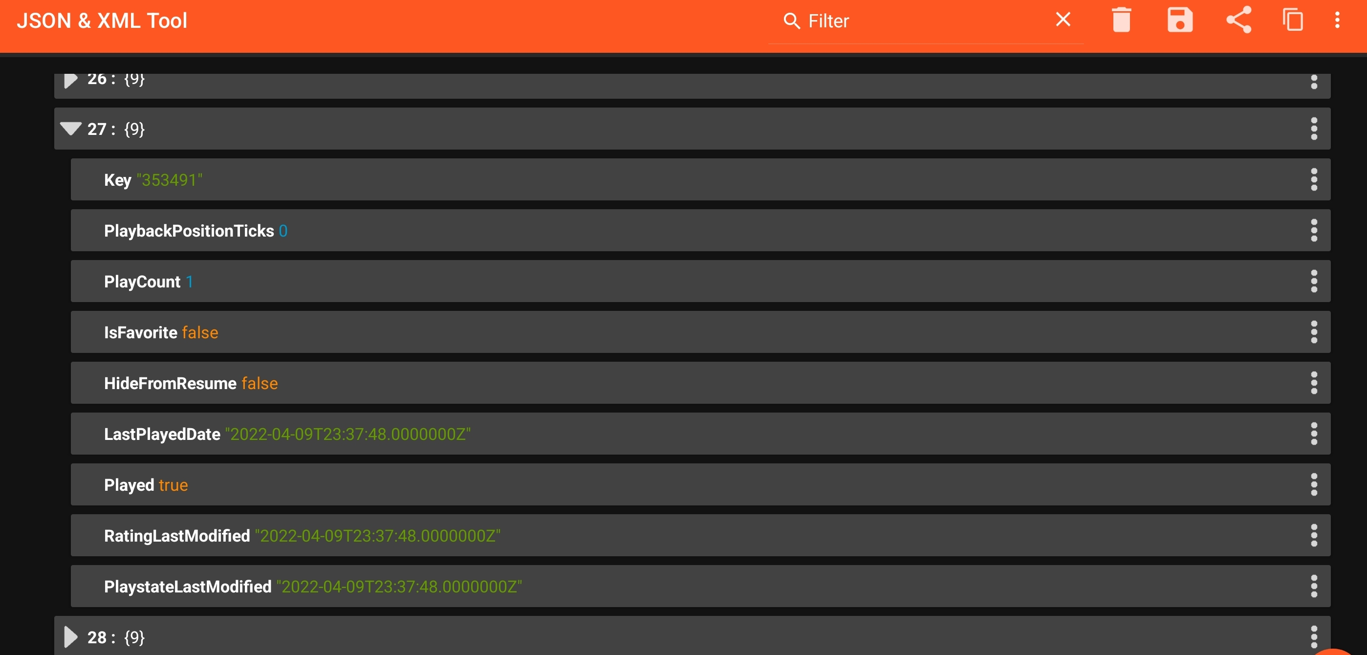

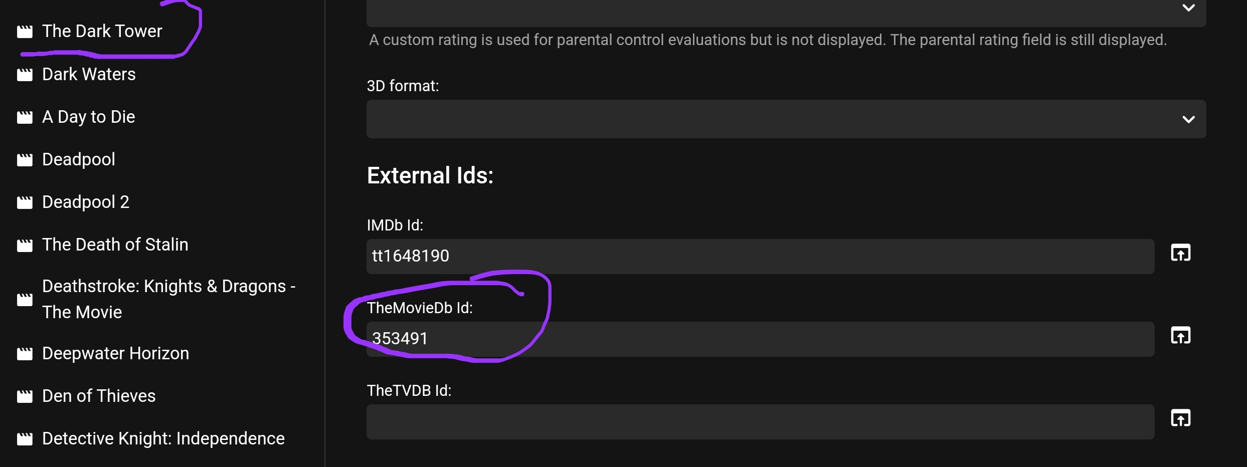

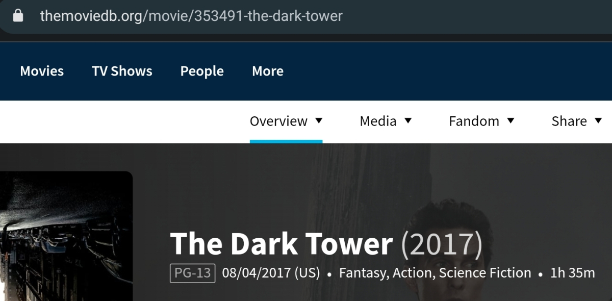

Sarge88 9 Posted September 5, 2023 Author Posted September 5, 2023 OK so I was able to look at the user watchvstatus from the db in a json format. From the looks of it it should be working but it's not. For example I picked a random entry that had played:true and grabbed the key which turned out to be the themoviedb id. Looked it up in the emby metamanager to be sure the id was there, which it was. However the movie still showed as unplayed.unplanned. pics added for ref
Sarge88 9 Posted September 5, 2023 Author Posted September 5, 2023 after some more digging in the DB and the JSON from the backup plugin i think i may have found the issue. for some reason my UserDataKey has changed and thus was given a new Id in the DB's UserDataKeys2 Table. So my account(and only my account now it seems) has somehow had its Id changed and now has a userId of 5 which only has 2258 records while my original userid of 1 has the correct amount of 5894 records(ie playcount:1). any thoughts on how to fix this? its a bit of an odd issue that im not aware wat may have caused it.
