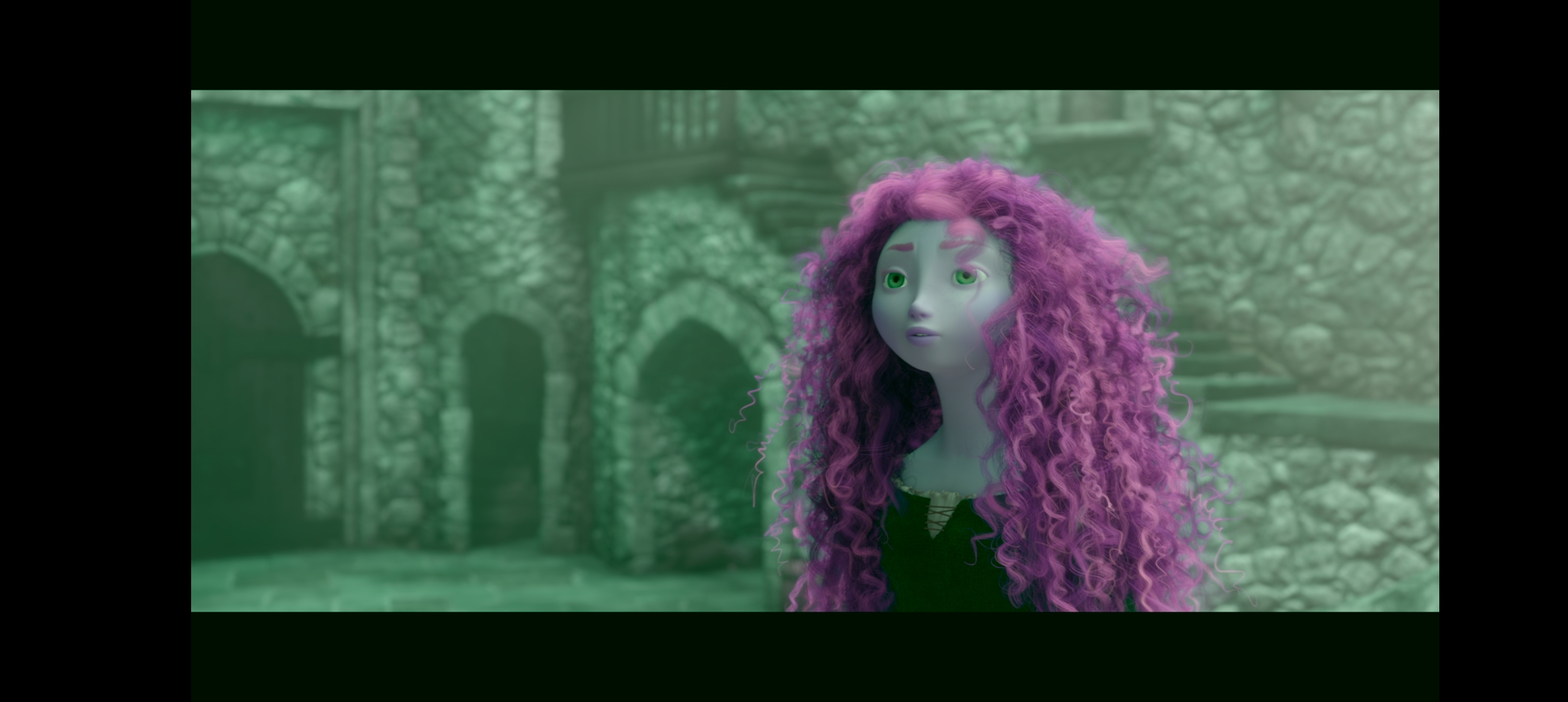

hoonlight 18 Posted May 18, 2024 Posted May 18, 2024 (edited) If the Emby team can't fix this issue for technical reasons for the time being, I think it would be better to force the emby app to transcode the video when it detects IOS + hdr (hdr10, DV). That would be better than Direct Play + weird green video. Additionally, this issue does not occur in the MAC Emby app. Edited May 18, 2024 by hoonlight

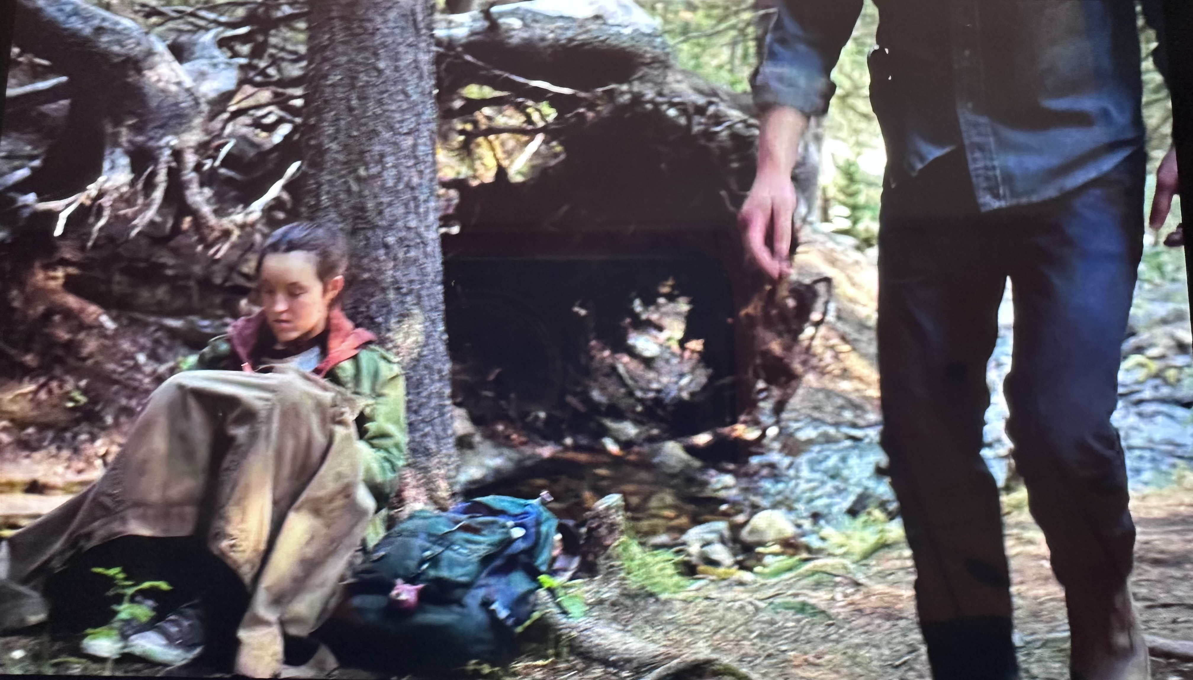

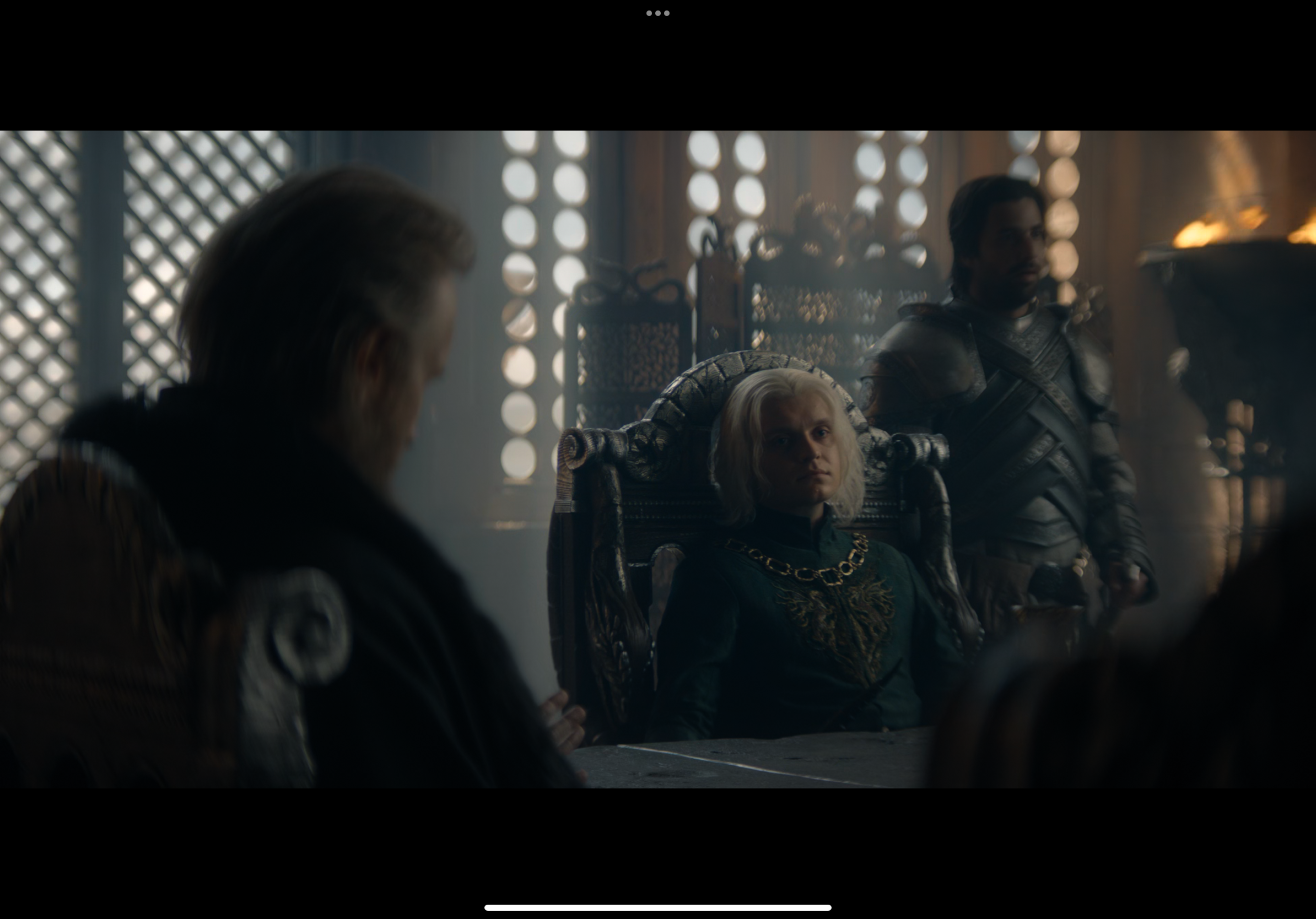

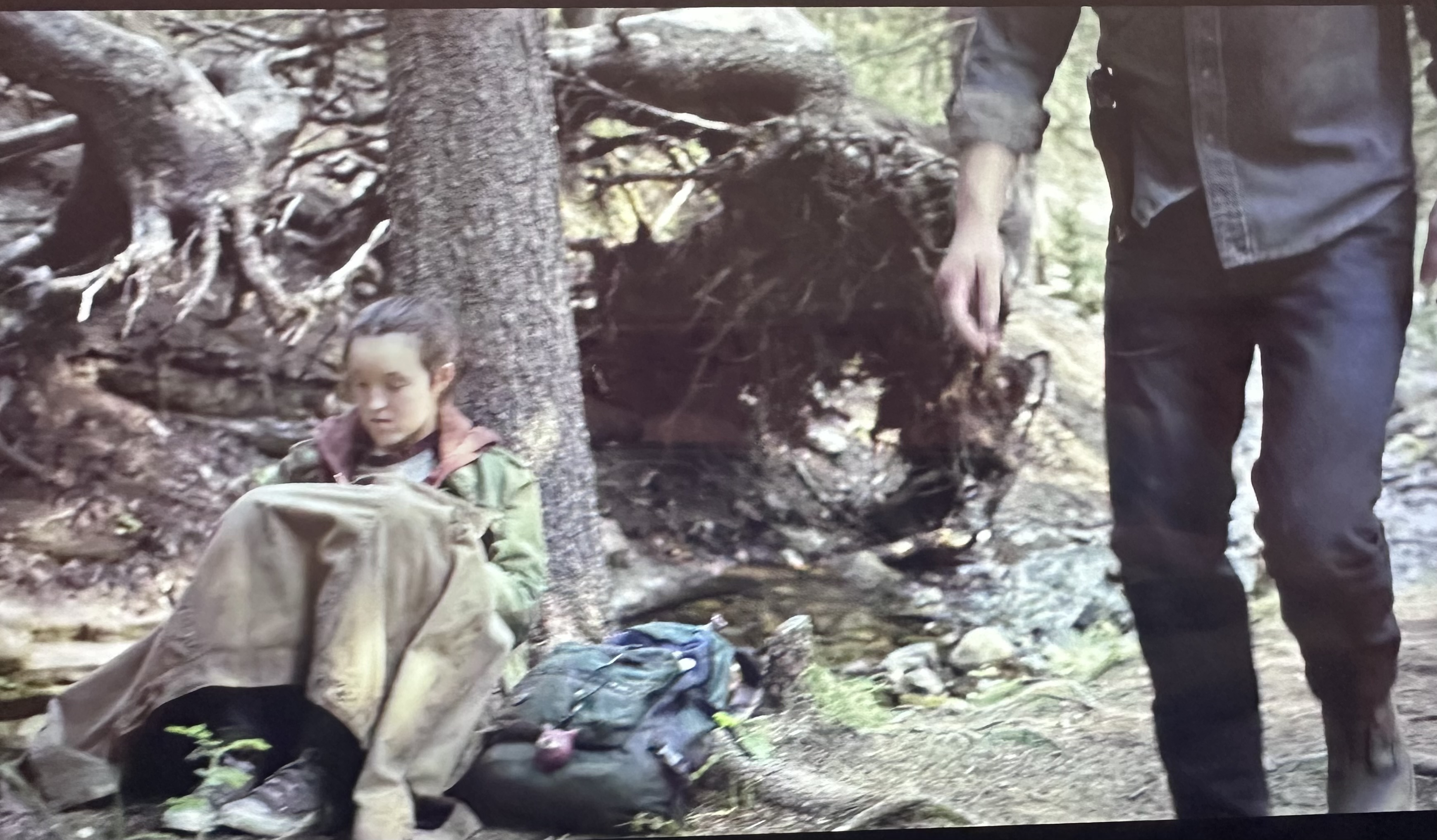

kira yamato 22 Posted August 5, 2024 Posted August 5, 2024 (edited) On 8/4/2024 at 1:38 PM, kira yamato said: wow wow wow finally they seem to fix, it with new emby ios ver.2.2.27 thank you so much The journey has come to an end. new problem found on ver2.2.27 HEVC 4k HDR a bit darker than normal with same brightness normal (1st pic)vs emby (2nd pic) look at shadow on the face Edited August 5, 2024 by kira yamato
Luke 42239 Posted August 5, 2024 Posted August 5, 2024 1 hour ago, kira yamato said: new problem found on ver2.2.27 HEVC 4k HDR a bit darker than normal with same brightness normal (1st pic)vs emby (2nd pic) look at shadow on the face Hi, we'll take a look at it. Thanks.
LoganJay 0 Posted August 15, 2024 Posted August 15, 2024 On 8/4/2024 at 2:38 PM, kira yamato said: wow wow wow finally they seem to fix, it with new emby ios ver.2.2.27 thank you so much The journey has come to an end. Sorry but for me it seems ios ver 2.2.28 the greenish issues still exist... sometimes. However, it seems that dragging the progress bar left & right a few times can solve this problem. Could you please take a look into that?
Luke 42239 Posted August 16, 2024 Posted August 16, 2024 On 8/15/2024 at 7:30 AM, LoganJay said: Sorry but for me it seems ios ver 2.2.28 the greenish issues still exist... sometimes. However, it seems that dragging the progress bar left & right a few times can solve this problem. Could you please take a look into that? HI, yes we'll take a look at it. Thanks.

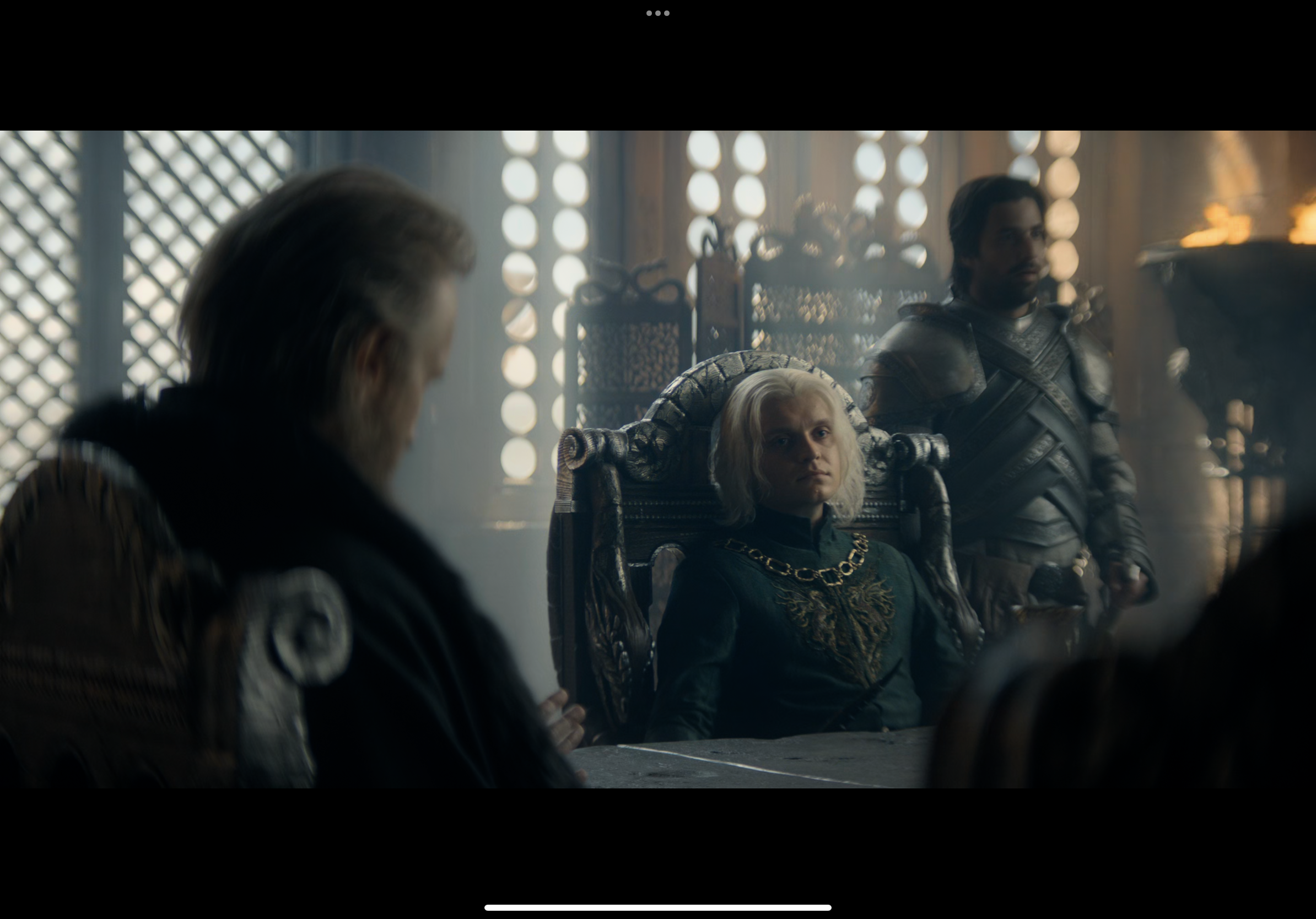

michaeltruncale 8 Posted March 3, 2025 Posted March 3, 2025 Is there a setting that was introduced to fix this issue? This is on an iPad, if I swipe down with my finger and slowly swipe upward I can see the true colors, once I let go of the screen it gets the haze treatment again. Works fine on my iPhone 14 Pro Max however. This is why I’m asking if there’s a setting that’s affecting this? Also what is Infuse? Is that a plugin for Emby or iPhone, iPad, or?
TZTZoro 26 Posted March 5, 2025 Posted March 5, 2025 On 3/3/2025 at 6:25 PM, michaeltruncale said: Also what is Infuse? infuse is a different playback app from a different company
Luke 42239 Posted March 6, 2025 Posted March 6, 2025 On 3/3/2025 at 12:25 PM, michaeltruncale said: Is there a setting that was introduced to fix this issue? This is on an iPad, if I swipe down with my finger and slowly swipe upward I can see the true colors, once I let go of the screen it gets the haze treatment again. Works fine on my iPhone 14 Pro Max however. This is why I’m asking if there’s a setting that’s affecting this? Also what is Infuse? Is that a plugin for Emby or iPhone, iPad, or? Hi, we'll take a look at that. Thanks.
