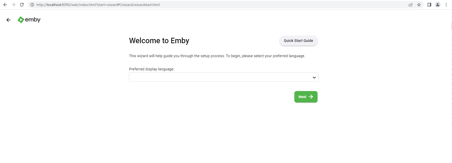

jsc1205 51 Posted September 2, 2023 Author Posted September 2, 2023 4 minutes ago, Luke said: Hi, what address is in the browser address bar? localhost:8096/web/index.html?start=wizard#!/wizard/wizardstart.html
Luke 42185 Posted September 2, 2023 Posted September 2, 2023 that's strange. Can you try clearing browsing data, and then just visiting http://localhost:8096

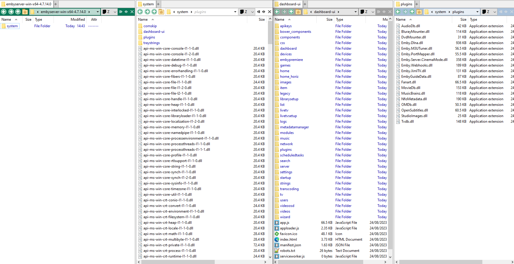

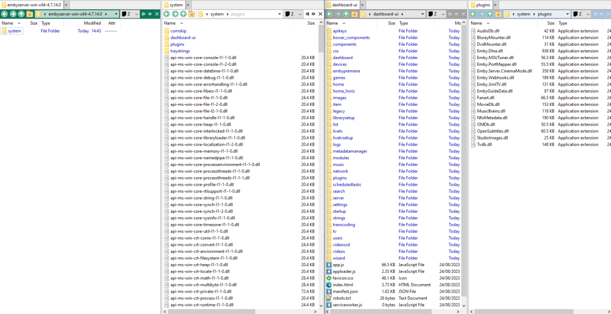

jsc1205 51 Posted September 3, 2023 Author Posted September 3, 2023 A ton of folders (all of which are completely empty) and a ton of files, If you download and unzip it on your end you'll see what I see.
GrimReaper 4845 Posted September 3, 2023 Posted September 3, 2023 (edited) 8 minutes ago, jsc1205 said: If you download and unzip it on your end you'll see what I see. I just downloaded same portable install, have no issues seeing all the files and running it. As said, most likely: 10 hours ago, Luke said: The only thing that comes to mind is antivirus or security software falsely tampering with the files. Edited September 3, 2023 by GrimReaper
