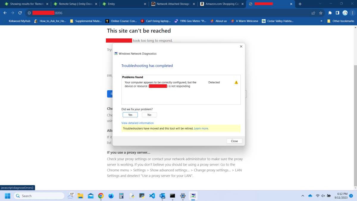

davelee 1 Posted September 11, 2023 Posted September 11, 2023 (edited) I'm gonna pop in on this post and ask about similar situation. The other day I went through the process of making sure that I had Windows Firewall, allowing IP addresses through from my devices that I want allowed to connect remotely to the remote(WAN) IP Address. I was able to connect from my phone. I also was able to connect successful from my daughter's laptop. I forgot about my school laptop. I tried today and obviously it didn't work. I added inbound and outbound rules for connecting. So now I'm home and got the IP Address added to the list. I tried to connect again and am getting the same time out error from the laptop. But this time, I opted to run the troubleshooter just to see what it would say. It claims I have everything set up correctly but the IP Address is not responding? I had a friend try it from their house the other day and they at least got their iphone to pull up the black screen with the Emby logo but it never loaded the library. Not as worried about that as my school laptop right now but just didn't know if that info would help or not. Any thoughts? I went through all the troubleshooting and changes as I went through it yesterday and am not finding the same success. Please let me know. Thanks. Edited September 12, 2023 by GrimReaper WAN IP hidden
pwhodges 2023 Posted September 12, 2023 Posted September 12, 2023 It seems you are operating a very restrictive policy in your Windows firewall. Nothing inherently wrong with that, of course. But it might be worth testing briefly with the firewall off to check that your Emby settings are correct, and you can connect through to it with any desired external device. If Emby is working OK, then the issue is specifically one of your Firewall settings. Phones, and laptops on other networks, are liable to have their IP address change regularly, using DHCP. This will make it hard to enable strict two-way rules through your firewall ("pinholes") which work consistently. But perhaps I have misunderstood something... Paul
davelee 1 Posted September 12, 2023 Posted September 12, 2023 Ah! That would actually make sense. And this laptop was a new one purchased for school. So I haven't done a lot with those settings. Other than, trying to add the rule exception for the IP address inbound. I have remote access set up now, via remote desktop connection, so when I'm on campus, away from home today I can test everything. But it sounds like it definitely would be an outbound rule or permission issue, as my other devices can all still connect remotely. I'll test it out with the firewall off and dig deeper to find which one is holding it up. Thank you!
visproduction 328 Posted September 12, 2023 Posted September 12, 2023 Davelee, for your security, you could edit the photo to remove your direct IP address. 1
davelee 1 Posted September 12, 2023 Posted September 12, 2023 @visproductionShoot! Thank you! I missed doing so. Thank you!!
