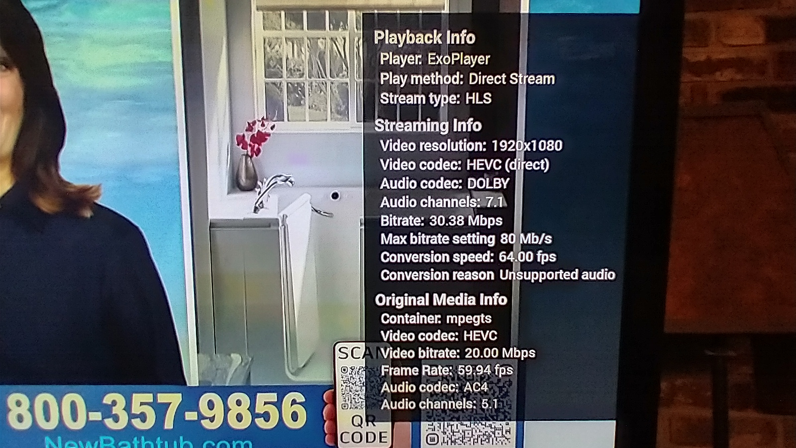

Nat Hill remote 8 Posted September 1, 2023 Posted September 1, 2023 (edited) My ONN box from Walmart shows the following using "stats for nerds." The broadcast is ATSC 3.0, and Emby has done a great job with the picture and sound. My questions are these 1) is the box actually showing HEVC and sending out AC4 sound? 2) What is the "Conversion reason" and "Direct option disabled" all about. HELP! Edited September 1, 2023 by Nat Hill remote accidently closed it
Nat Hill remote 8 Posted September 1, 2023 Author Posted September 1, 2023 (edited) Slight clarification for above question #1. Question #1 should have said: Is my television set, receiving a stream from my SiliconDust tuner and Emby server, showing me actual HEVC video and sending out actual AC4 audio? Edited September 1, 2023 by Nat Hill remote grammer amd clarification
Solution ebr 16337 Posted September 2, 2023 Solution Posted September 2, 2023 Hi. It is showing the video direct (HEVC) but I believe the audio is being converted to AC3 (straight Dolby). An ffmpeg log would confirm this. The reason for the remux is because you have not enabled the "Direct stream live TV" option in the app. You can try enabling this - which may get you direct playback but only if the box does support AC4. You also would lose the trick-play (seeking) ability in the stream if you do that though.

Luke 42245 Posted September 7, 2023 Posted September 7, 2023 OK so yes it looks like it's streaming the original video but converting the audio.
