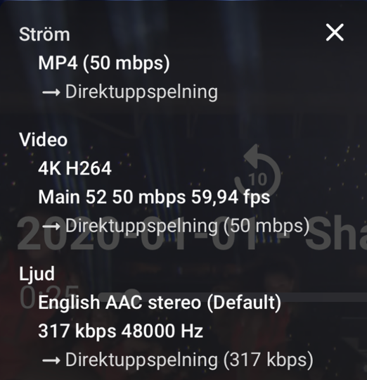

superdonpan 3 Posted August 27, 2023 Posted August 27, 2023 I'm having issues playing pretty much all 4k videos in Emby on my Sony XR65A90J. It takes a looong time to start playing and when it does it only plays a few seconds before starting to buffer again. If I try watching the same files in the browser on my computer or in the app on my iPhone then it works fine and flawless like any other video file. Looking at the short info it looks identical for both instances. I've attached the logs. In this example it's a big 5,5gig file for only a 15minute clip but as said it works flawless on the computer and phone. Is there a setting or something that I can change to get this working on my TV as well? Stats for Sony TV Stats for webplayer on computer ffmpeg-transcode-e5dfec0f-2b6f-4d97-96d1-fdfaefa358c5_1.txt

superdonpan 3 Posted August 30, 2023 Author Posted August 30, 2023 Just did some more tests. Played the video on webplayer but it didn't render a ffmpeg log. Disconnected my computer from lan and connected to my phones 5g instead and the video plays perfectly fine. However doesn't produce a log either. Only have the stats for nerds box to share from it. Disconnected my phone from wifi and played the video perfectly fine but didn't render an ffmpeg log either. Only have the stats for nerds info to share this time as well. Only logs that where updated during all of this was the embyserver log.
Solution rbjtech 5344 Posted August 31, 2023 Solution Posted August 31, 2023 As has been explained above - the web browser and phone are both playing the video without the need for transcoding - thus no ffmpeg log. However, the TV does not and thus it does need to transcode because it does not appear to support the h264 codec level required for 4K @ 60 fps. Unfortunately, your emby server does not have sufficient processing power to transcode the video to display at anywhere near the required 60fps - the log suggests it's only managing 9 fps. I am surprised however that the TV cannot play this codec natively, as it's a top end Sony OLED TV but the codec choice used in the video is not mainstream for this type of video. For 4K, especially 60fps content, HEVC (aka h265) is almost always used (and well supported) - but in this case, AVC (aka h264) is being used instead - which is the core of your problem.
