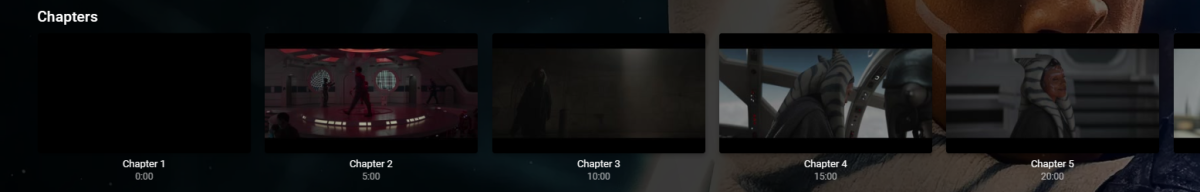

McMovies 7 Posted August 25, 2023 Posted August 25, 2023 This a complaining post, because i just lost my months of work in optimising my metadata. And im very upset. Q: How to stop emby overwriting my chapter images? all of my movies had proper chapter, either muxed from chaperdb or extracted from the disk itself. And by default emby - stores these images in the same size as the video, if the video is 3840 × 2160, it will save in that size ( i failed to understand this logic of saving higher rez image). Also majority of the times chapters are marked at crucial point and their images are black. Hence all of my chapter thumbnail were manually extracted after seeking all moves manually & added under ~/metadata/library/, for all 200+ titles. All resized to logical size of 640x360, compress with ImageMagick/tinyPNG. But it seems after certain period of time, emby deletes my custom thumbnail and writes it own. 80% of the thumbnail are overwritten for me, as i discovered it today. How to stop Emby doing this? Frustation #2 if im not happy with emby in some department - its the image handling. from day one i fellt its the dept where emby has lots of scope of improvement. I always have very much optimised backdrop/poster, compressed with tinyPNG/imagemagic, which hardly cross 256kb, but what emby does - it take the optimzed image and make it 4mb webp file and serve to the client!! How i stop this as well?

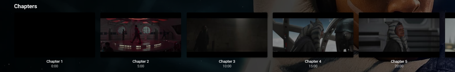

rbjtech 5335 Posted August 25, 2023 Posted August 25, 2023 Can I confirm by chapter images - you are referring to the images below (as an example ?)
McMovies 7 Posted August 25, 2023 Author Posted August 25, 2023 11 minutes ago, rbjtech said: Can I confirm by chapter images - you are referring to the images below (as an example ?) yes.
