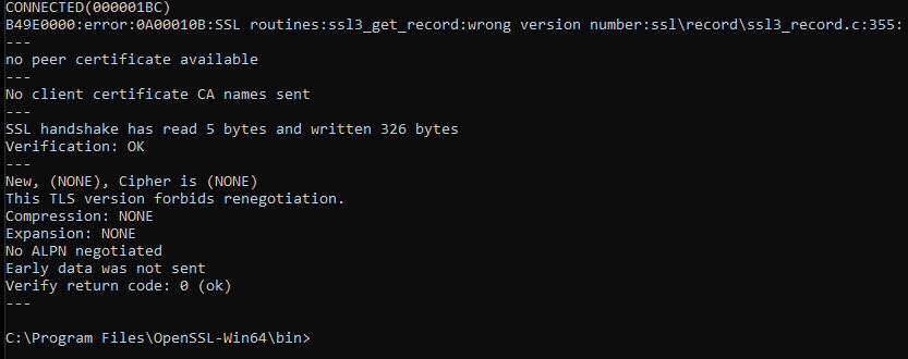

Zhadum101 2 Posted August 24, 2023 Author Posted August 24, 2023 and this is on a working app **next below this is the domain and the certificate chain this is on emby (note the get record wrong version number)

Solution Q-Droid 1011 Posted August 24, 2023 Solution Posted August 24, 2023 The Emby server appears to be okay with the pfx file. Are your port mappings correct for the HTTPS port in the container setup? The server is listening on 8920 as expected so it was able to open and use the certificate. The port you defined and mapped to 8920 should also be working or at least responding. Quote 2023-08-24 10:58:35.452 Info App: Adding HttpListener prefix http://+:8096/ 2023-08-24 10:58:35.452 Info App: Adding HttpListener prefix https://+:8920/ 1
