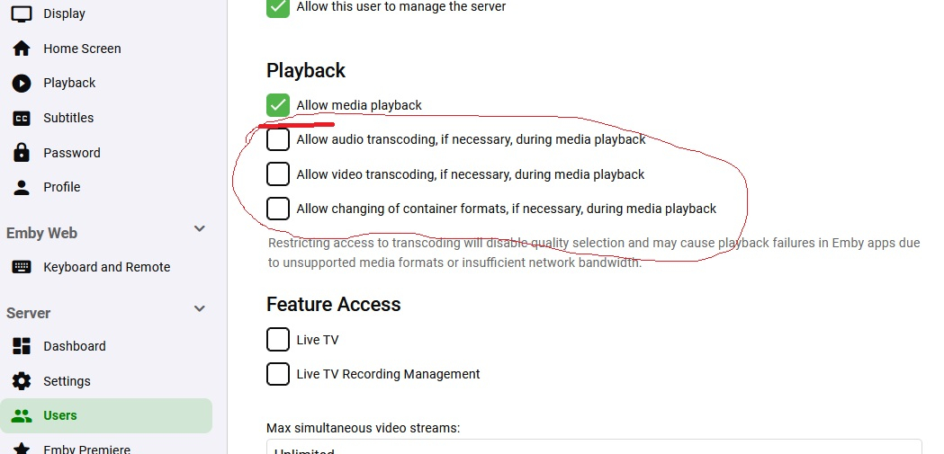

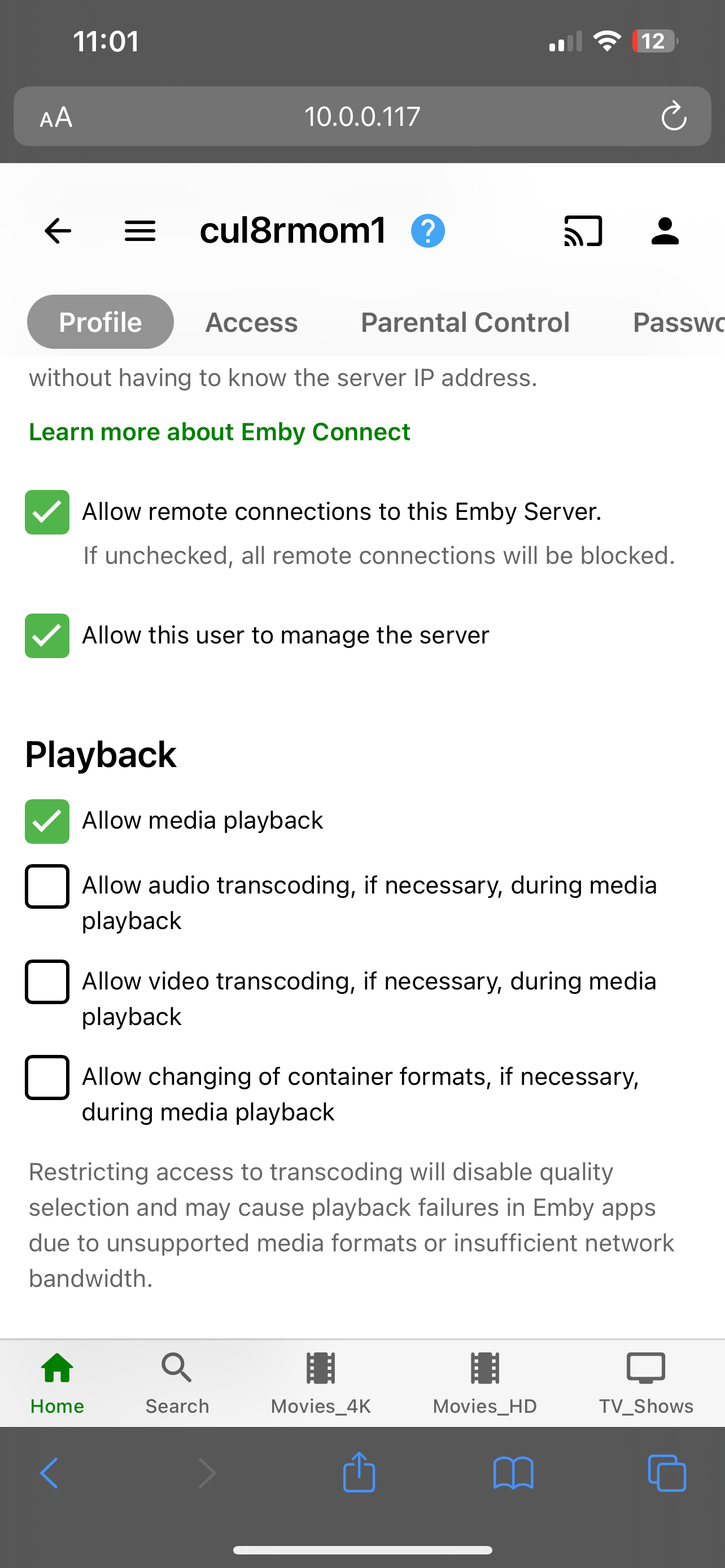

cul8rmom1 12 Posted November 27, 2023 Posted November 27, 2023 On 9/23/2023 at 10:13 AM, ShoutingMan said: I looked at that in the past and didn’t understand it. But I’ll try again in a few weeks when I’ve got time to experiment. I have had similar problems. Try going into your user name and taking the check marks off of Allow audio transcoding, if necessary, during media playback Allow video transcoding, if necessary, during media playback Allow changing of container formats, if necessary, during media playback I have a Denon AVR-A110 going to the latest appletv 4k. Any time i try to play anything interesting it always wants to transcode video and/or audio. When I take all the checkmarks off it direct plays. Wonder if the appletv profile doesn't differentiate between the different versions. (I know plex thought and xbox was an xbox was an xbox no matter what version you had.) Here is the output with those checkmarks on and off. You can direct play with appletv ... but emby doesnt know it can. Still it actually allows you to tell it dont transcode ... Plex doesnt let you do that except for chromecast ... the last time I checked. See if it makes a difference .. and if you think you are direct playing go look at your dashboard and see if it is actually transcoding audio. TrueHD, Atmos really seem to piss a lot of things off.

cul8rmom1 12 Posted November 28, 2023 Posted November 28, 2023 Vdatanet, .. the appleTV plays it if you tell Emby not to transcode. I thought the pictures were self explanatory. Please review them or clarify your statement please. Cheers,
