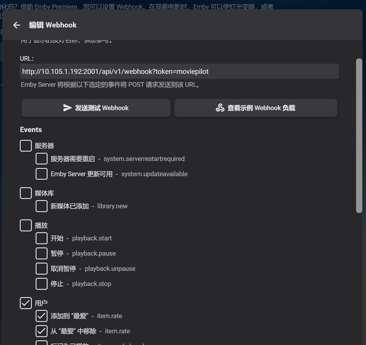

paysen 7 Posted August 20, 2023 Posted August 20, 2023 I set up Webhooks Add to Favorites - When I add some movie to Favorites Spoiler 2023-08-21 00:06:26.151 Info Server: http/1.1 Response 200 to host3. Time: 96ms. POST http://10.105.1.192:8096/emby/Users/xxxxx/FavoriteItems/41253/Delete?X-Emby-Client=Emby Theater&X-Emby-Device-Name=PC&X-Emby-Device-Id=PC&X-Emby-Client-Version=3.0.20&X-Emby-Token=x_secret4_x&X-Emby-Language=en-us 2023-08-21 00:06:26.981 Info Server: http/1.1 POST http://10.105.1.192:8096/emby/Users/xxxx/FavoriteItems/41253?X-Emby-Client=Emby Theater&X-Emby-Device-Name=PC&X-Emby-Device-Id=PC&X-Emby-Client-Version=3.0.20&X-Emby-Token=x_secret4_x&X-Emby-Language=en-us. UserAgent: Mozilla/5.0 (Windows NT 10.0; Win64; x64) AppleWebKit/537.36 (KHTML, like Gecko) EmbyTheater/3.0.20 Chrome/87.0.4280.141 Electron/11.5.0 Safari/537.36 2023-08-21 00:06:26.984 Error UserDataManager: Error in event handler *** Error Report *** Version: 4.8.0.42 Command line: /volume5/@appstore/EmbyServer/system/EmbyServer.dll -programdata /var/packages/EmbyServer/var -ffdetect /var/packages/EmbyServer/target/bin/ffdetect -ffmpeg /var/packages/EmbyServer/target/bin/ffmpeg -ffprobe /var/packages/EmbyServer/target/bin/ffprobe -nolocalportconfig -ignore_vaapi_enabled_flag -pidfile /var/packages/EmbyServer/var/EmbyServer.pid -defaultdirectory /volume1/Public -updatepackage emby-server-synology72_{version}_x86_64.spk -noautorunwebapp Operating system: Linux version 4.4.302+ (root@build7) (gcc version 12.2.0 (GCC) ) #64570 SMP Tue Jun 13 21:40:17 CST 2023 Framework: .NET 6.0.20 OS/Process: x64/x64 Runtime: volume5/@appstore/EmbyServer/system/System.Private.CoreLib.dll Processor count: 4 Data path: /var/packages/EmbyServer/var Application path: /volume5/@appstore/EmbyServer/system System.MissingMethodException: System.MissingMethodException: Method not found: 'System.String MediaBrowser.Controller.Entities.User.get_EasyPassword()'. at EmbyScripterX.Core.ScripterXContextFactory.User(User _user) at EmbyScripterX.EventManagers.ScripterXUserDataManager._userDataManager_UserDataSaved(Object sender, UserDataSaveEventArgs e) at MediaBrowser.Common.Events.EventHelper.FireEventIfNotNull[T](EventHandler`1 handler, Object sender, T args, ILogger logger) Source: EmbyScripterX TargetSite: EmbyScripterX.Core.ScripterXEventContext User(MediaBrowser.Controller.Entities.User) 2023-08-21 00:06:26.984 Info Server: http/1.1 Response 200 to host3. Time: 3ms. POST http://10.105.1.192:8096/emby/Users/xxxx/FavoriteItems/41253?X-Emby-Client=Emby Theater&X-Emby-Device-Name=PC&X-Emby-Device-Id=PC&X-Emby-Client-Version=3.0.20&X-Emby-Token=x_secret4_x&X-Emby-Language=en-us
paysen 7 Posted August 20, 2023 Author Posted August 20, 2023 8 minutes ago, Luke said: Hi, what exactly is the problem? I have a third’s tool need to receive webhooks from Emby about favorite or disfavored a movie/show . The test is ok but favorites information can not be sent
Luke 42301 Posted August 20, 2023 Posted August 20, 2023 What do you mean cannot be sent? That error is from the scripterx plugin and has nothing to do with webhooks. Try removing the scripterx plugin and that error will go away.

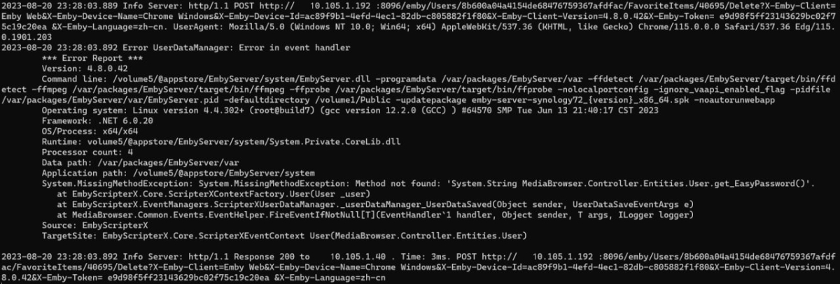

paysen 7 Posted August 21, 2023 Author Posted August 21, 2023 6 hours ago, Luke said: What do you mean cannot be sent? That error is from the scripterx plugin and has nothing to do with webhooks. Try removing the scripterx plugin and that error will go away. Thanks. But it is a little weird. When I try to add to favorites and my third tool cant not receive wehooks Before I delete scripterx plugin and the only information on logs is following the pictrue about scripterx plugin. Now I have delete scripterx plugin and wehooks sent is ok. So I will try to install scripterx again and test it

paysen 7 Posted August 31, 2023 Author Posted August 31, 2023 yes, I’m using 4.8.0.43 now But still have the same problem every single minute get the same error info The only thing I did just play video *** Error Report *** Version: 4.8.0.43 Command line: /volume5/@appstore/EmbyServer/system/EmbyServer.dll -programdata /var/packages/EmbyServer/var -ffdetect /var/packages/EmbyServer/target/bin/ffdetect -ffmpeg /var/packages/EmbyServer/target/bin/ffmpeg -ffprobe /var/packages/EmbyServer/target/bin/ffprobe -nolocalportconfig -ignore_vaapi_enabled_flag -pidfile /var/packages/EmbyServer/var/EmbyServer.pid -defaultdirectory /volume1/Public -updatepackage emby-server-synology72_{version}_x86_64.spk Operating system: Linux version 4.4.302+ (root@build7) (gcc version 12.2.0 (GCC) ) #64570 SMP Tue Jun 13 21:40:17 CST 2023 Framework: .NET 6.0.20 OS/Process: x64/x64 Runtime: volume5/@appstore/EmbyServer/system/System.Private.CoreLib.dll Processor count: 4 Data path: /var/packages/EmbyServer/var Application path: /volume5/@appstore/EmbyServer/system System.MissingMethodException: System.MissingMethodException: Method not found: 'System.String MediaBrowser.Controller.Entities.User.get_EasyPassword()'. at EmbyScripterX.Core.ScripterXContextFactory.User(User _user) at EmbyScripterX.EventManagers.ScripterXUserDataManager._userDataManager_UserDataSaved(Object sender, UserDataSaveEventArgs e) at MediaBrowser.Common.Events.EventHelper.TriggerAll[T](EventHandler`1 mainHandler, Object sender, T args, ILogger logger) Source: EmbyScripterX TargetSite: EmbyScripterX.Core.ScripterXEventContext User(MediaBrowser.Controller.Entities.User)
Solution Luke 42301 Posted August 31, 2023 Solution Posted August 31, 2023 2 minutes ago, paysen said: yes, I’m using 4.8.0.43 now But still have the same problem every single minute get the same error info The only thing I did just play video *** Error Report *** Version: 4.8.0.43 Command line: /volume5/@appstore/EmbyServer/system/EmbyServer.dll -programdata /var/packages/EmbyServer/var -ffdetect /var/packages/EmbyServer/target/bin/ffdetect -ffmpeg /var/packages/EmbyServer/target/bin/ffmpeg -ffprobe /var/packages/EmbyServer/target/bin/ffprobe -nolocalportconfig -ignore_vaapi_enabled_flag -pidfile /var/packages/EmbyServer/var/EmbyServer.pid -defaultdirectory /volume1/Public -updatepackage emby-server-synology72_{version}_x86_64.spk Operating system: Linux version 4.4.302+ (root@build7) (gcc version 12.2.0 (GCC) ) #64570 SMP Tue Jun 13 21:40:17 CST 2023 Framework: .NET 6.0.20 OS/Process: x64/x64 Runtime: volume5/@appstore/EmbyServer/system/System.Private.CoreLib.dll Processor count: 4 Data path: /var/packages/EmbyServer/var Application path: /volume5/@appstore/EmbyServer/system System.MissingMethodException: System.MissingMethodException: Method not found: 'System.String MediaBrowser.Controller.Entities.User.get_EasyPassword()'. at EmbyScripterX.Core.ScripterXContextFactory.User(User _user) at EmbyScripterX.EventManagers.ScripterXUserDataManager._userDataManager_UserDataSaved(Object sender, UserDataSaveEventArgs e) at MediaBrowser.Common.Events.EventHelper.TriggerAll[T](EventHandler`1 mainHandler, Object sender, T args, ILogger logger) Source: EmbyScripterX TargetSite: EmbyScripterX.Core.ScripterXEventContext User(MediaBrowser.Controller.Entities.User) That requires help from the ScripterX developer, so please report this in the main ScripterX topic in the plugins section. What I've done though is make sure that this error won't affect any other server functions like it was before. 1
