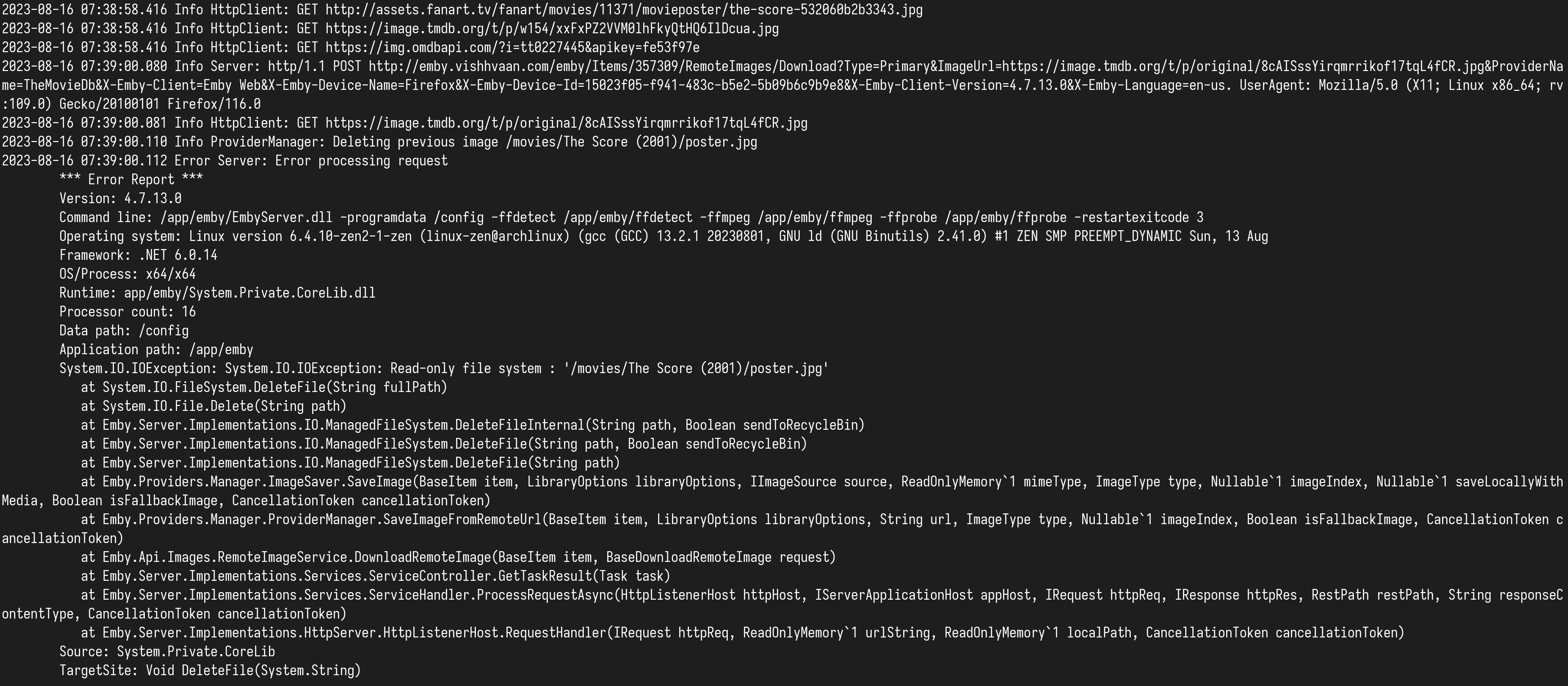

vishhvaan 0 Posted August 16, 2023 Posted August 16, 2023 Emby tries to delete the "poster.jpg" file on the filesystem even though the option of "Save artwork into media folders" is unchecked in the library setting. I have made the filesystem read-only when I mount in Docker to prevent accidental data loss. Instead of replacing the "poster.jpg" in the location of the movie, I would like Emby to save posters/art into the config folder along with thumbnails. Is there a way to do this? Thanks
pünktchen 1411 Posted August 16, 2023 Posted August 16, 2023 When you disable saving of artwork into your media folders and download some images from an online provider inside Emby, then the new image will be stored inside metadata\library. But after a library scan you will see your old image again because your local media files have always precedence. That's why Emby wants to delete your local image in the first place. 1
vishhvaan 0 Posted August 18, 2023 Author Posted August 18, 2023 Is it possible for Emby to keep track of the fact that the user downloaded a poster and instead use the downloaded one instead of the local image?
Luke 42243 Posted August 18, 2023 Posted August 18, 2023 2 hours ago, vishhvaan said: Is it possible for Emby to keep track of the fact that the user downloaded a poster and instead use the downloaded one instead of the local image? Ideally, yes, but until such time, the best thing to do is delete the existing image.
