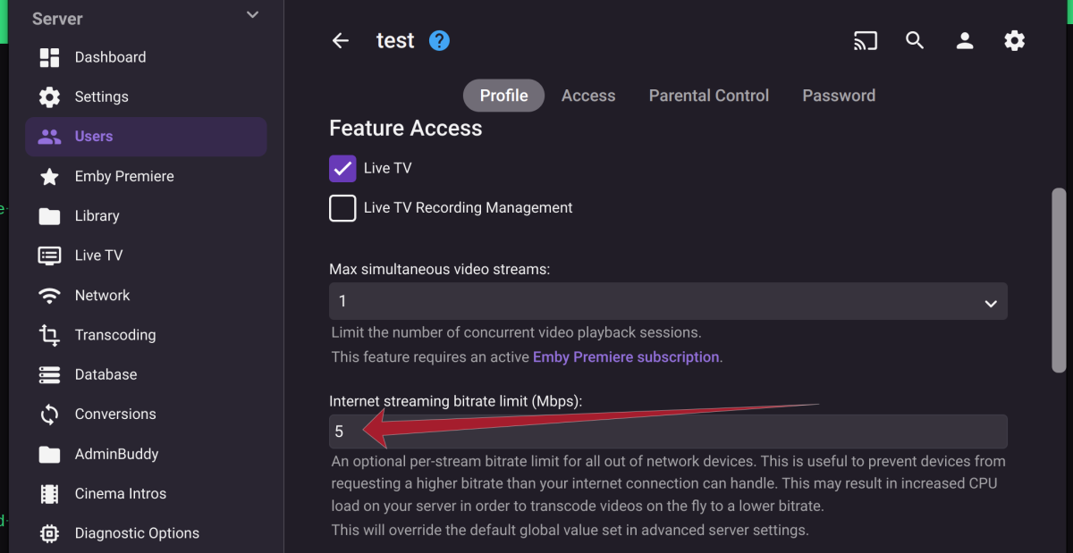

Teshvier 1 Posted August 17, 2023 Author Posted August 17, 2023 Thank you for that suggestion! I am currently doing something like that now. I installed caddy outside of Docker and then changed the limit of internet streaming bit rate to 2. Anything higher still gets Direct Play which is annoying. I tried having the client limit the speed and then it had to be 1.5 720p Do you have nginx in a Docker? Transcoding is not an issue because the PC is a Intel NUC 11 Enthusiast i7 which has a RTX 2060. I think that should be powerful enough. I believe it is the internet connection between the devices which are a problem.

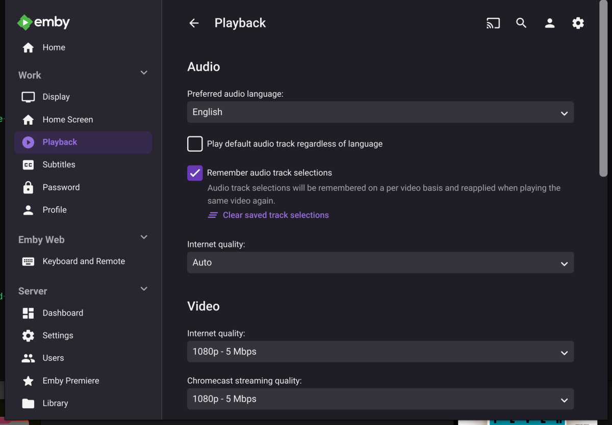

Luke 42185 Posted August 17, 2023 Posted August 17, 2023 I don't think the server log will help. If the server can only see 127.0.0.1, then there's nothing you can change in Emby Server to correct that .That would have to be in your reverse proxy and/or Docker. The best solution would be to fix this, however if you just want to ignore it and get your video playing, then try setting the chromecast quality option in the app that you're casting from. I wouldn't use the internet streaming limit in the server. It won't apply anyway if the server thinks the connection is over the local network.
