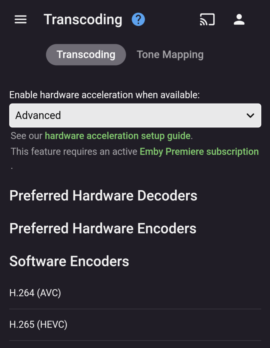

Benerages 1 Posted August 7, 2023 Posted August 7, 2023 I can't get HW Accel on my Intel NUC with an Intel Core i7-1360P and Intel IrisXE Graphic. Newest Intel Driver is installed and QSV is supported. Its a Barebone Install - not a Docker. I still don't get it to work and don't know why. lshw -c video *-display description: VGA compatible controller product: Intel Corporation vendor: Intel Corporation physical id: 2 bus info: pci@0000:00:02.0 version: 04 width: 64 bits clock: 33MHz capabilities: pciexpress msi pm vga_controller bus_master cap_list rom configuration: driver=i915 latency=0 resources: iomemory:610-60f iomemory:400-3ff irq:183 memory:6123000000-6123ffffff memory:4000000000-401fffffff ioport:3000(size=64) memory:c0000-dffff memory:611c000000-6122ffffff memory:6000000000-60dfffffff hardware_detection-63827042368.txt embyserver.txt

Benerages 1 Posted August 8, 2023 Author Posted August 8, 2023 I dont see any Hardware Decoder or Encoder. Its using the CPU.
Solution Luke 42245 Posted August 8, 2023 Solution Posted August 8, 2023 OK if you'd like to try the 4.8 beta server you may have a better experience there as it has updated Intel GPU support. 1
Benerages 1 Posted August 8, 2023 Author Posted August 8, 2023 That did the trick. It works now under 4.8. Beta. Thx alot! 1
