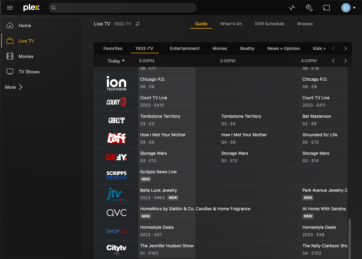

Daniel8192 6 Posted August 17, 2023 Author Posted August 17, 2023 Hi Luke, My Plex is my personal media server. I have my movies, my tv series all loaded onto my NAS which my Plex mounts and serves up, additionally I have 42 OTA channels through my tuners on my Plex server, as well as providing the EPG. I look at Emby every couple years, but Emby on Linux can't use my USB TV tuners and I need to use something like TVHeadend. I understand Emby on Windows can use them - it's not that I am anti-Windows, I just don't run it, not for desktop, and really not for a server. I gave it a day or two of testing, but the time slot is gone. Next year I'll look at it again.

Daniel8192 6 Posted August 18, 2023 Author Posted August 18, 2023 Hey come on, let’s keep this real. Plex knows the IP of my server, unless I block it. And knows my userId and email address. Much like what Emby knows about me. Plex has no clue what content I have on my server. A more compelling way to gain my interest is to support my UBS tuners on ‘nix.
