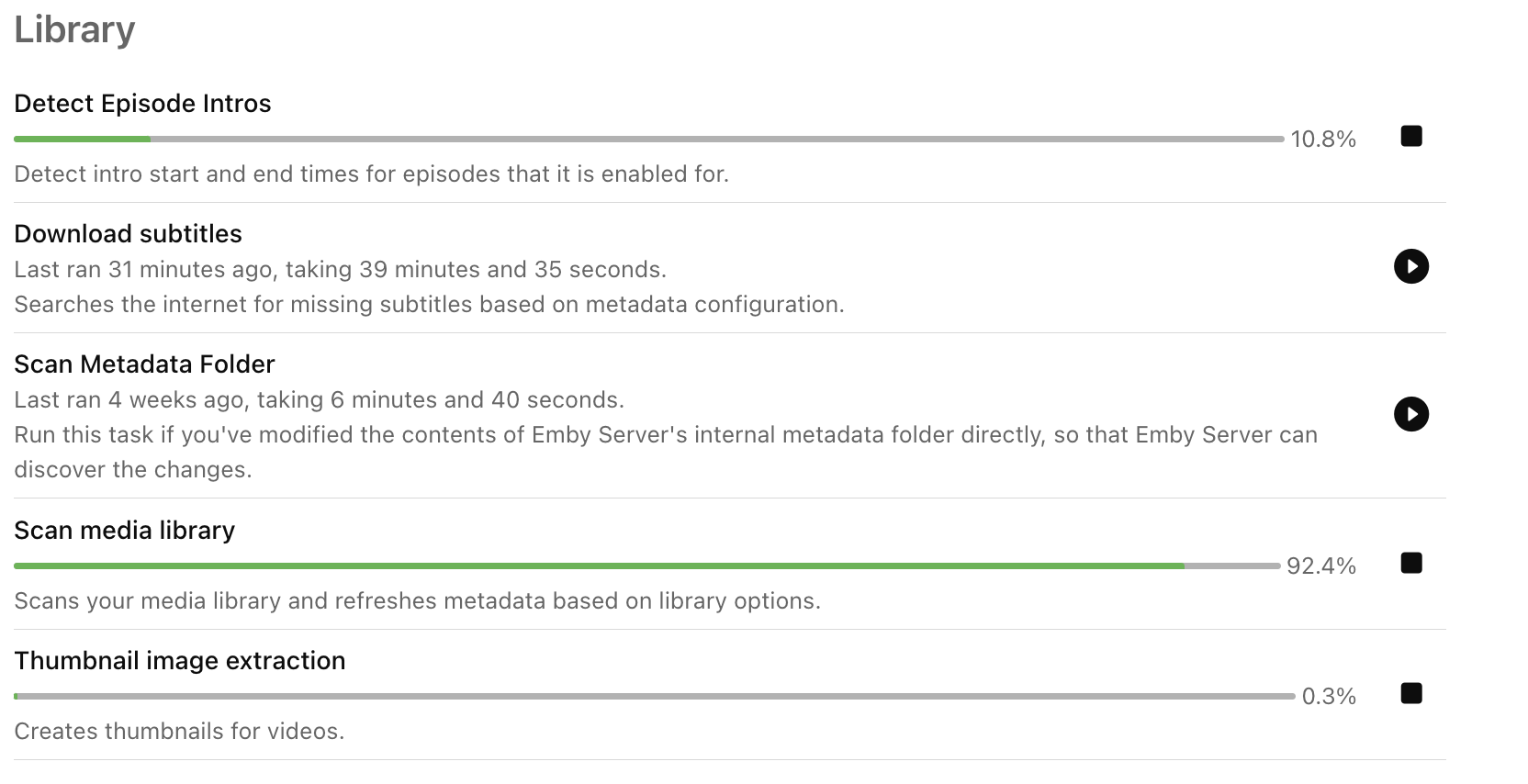

MrPaulo 8 Posted August 6, 2023 Posted August 6, 2023 On 04/08/2023 at 04:13, jsc1205 said: Not sure why or what is going on, but Emby is taking an extremely long time to scrape files. I recently cleaned up my files and had to remove all the drives mapped to the library. When I added them back, Emby is taking forever to add the movies back to the library. Its almost to the point where I have to use the "identify" function to get it to populate. BUT even doing that, Emby just sits and spins. Any ideas why??? Here is log file as well.embyserver (1).txt I would not worry about it - It was a surprise for me too when it first happened I though it was a bug or bad install. I would just let it work - wait a few days for it to complete. It is a one off exercise. Once complete it will be fine. As an example - I renamed all my tv shows folders to have the tvdbid on the name - I was getting a few mismatches for some content and took the plunge to reorganise. Below is a screenshot - the thumbnail extraction will probably take days, if not weeks. It is a docker container running on a decent server, quad core AMD CPU, 32GB ram, 6 spindles 20TB raid 6 and 2x1tb mirrored R&W ssd cache.
