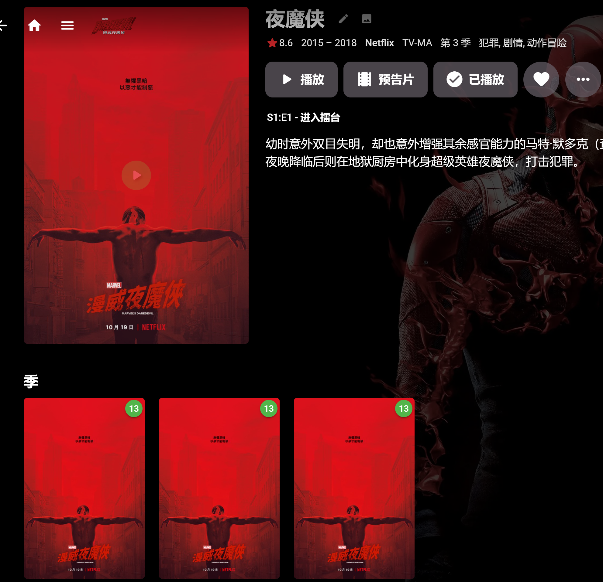

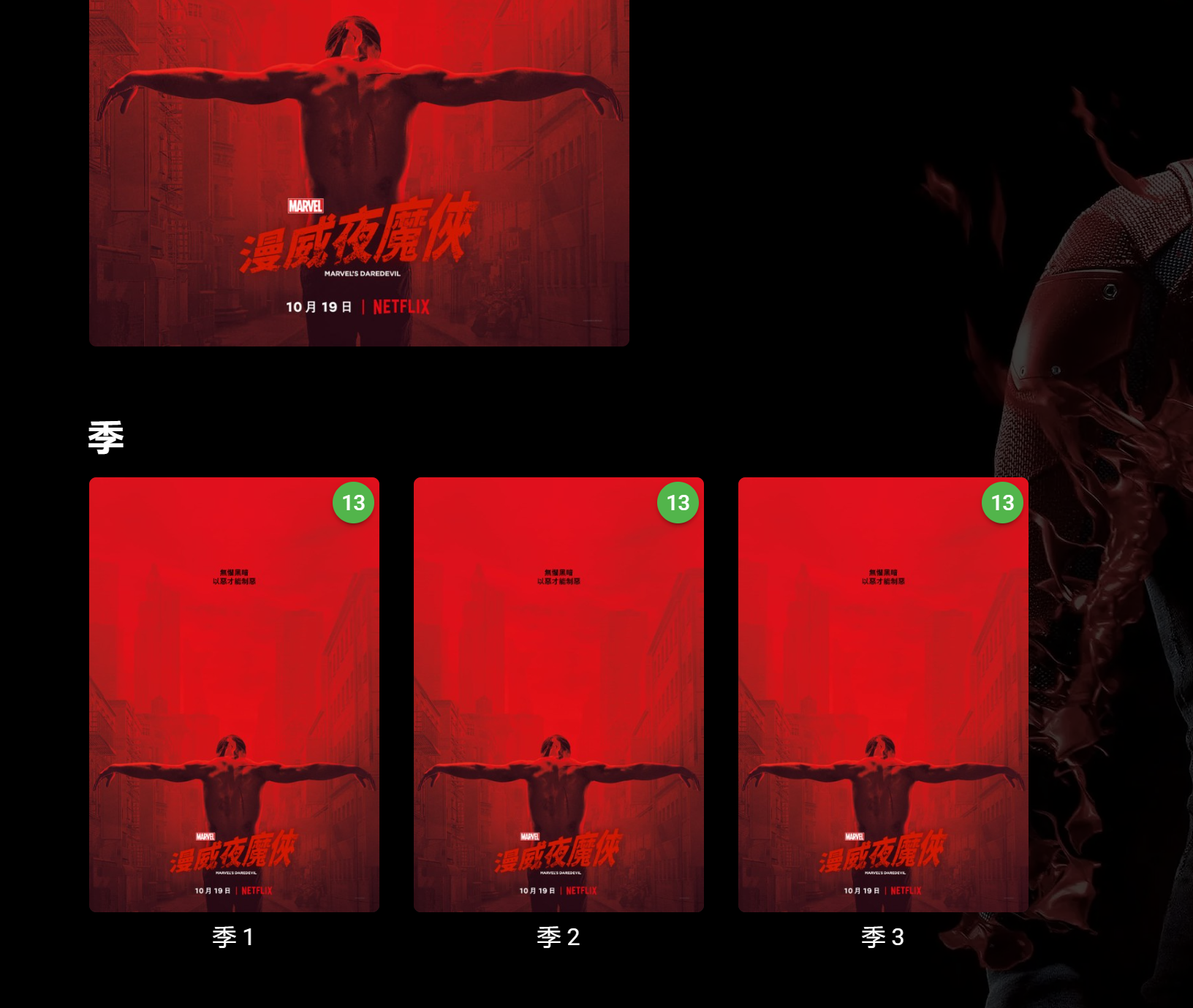

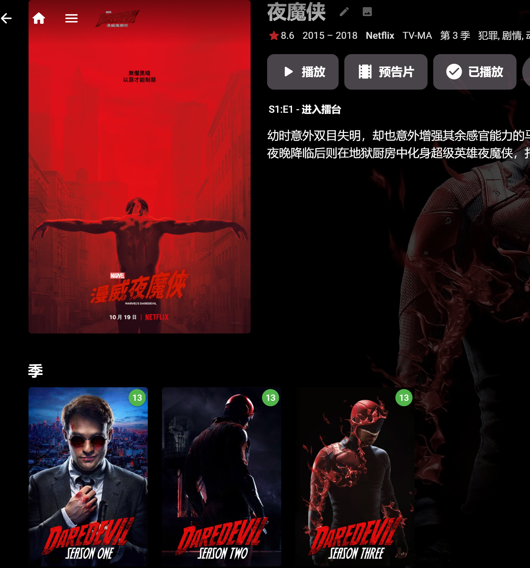

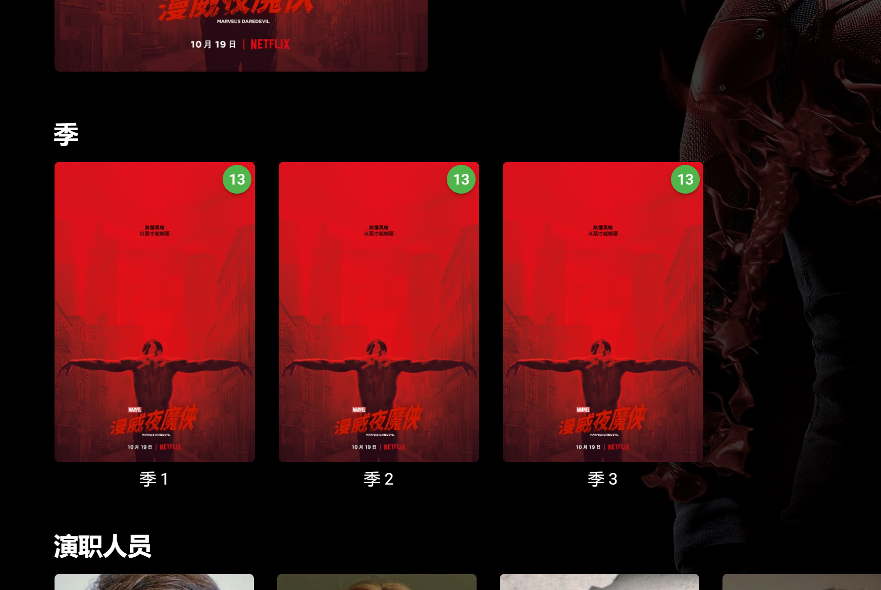

y29shi 8 Posted August 3, 2023 Posted August 3, 2023 Hi, I have dozens of shows in my emby server and they are all normal except for one -- if I change the images for some of their seasons, they keep the image. However, I have Daredevil from Netflix on my server as well, and it is very strange that each time I change the images for all 3 seasons to be like this: at the first few hours after I change them, it was ok. but after a few hours, they always automatically change back to be identical to the shows image: This has happened multiple times already. Sometimes I change them in the morning, and then when I checked them in the afternoon, they are back to be this one. Sometimes I change them before I went to bed but they would be back in the next morning. Does anyone have seen this kind of issue? How can I fix the image for them? Thanks!

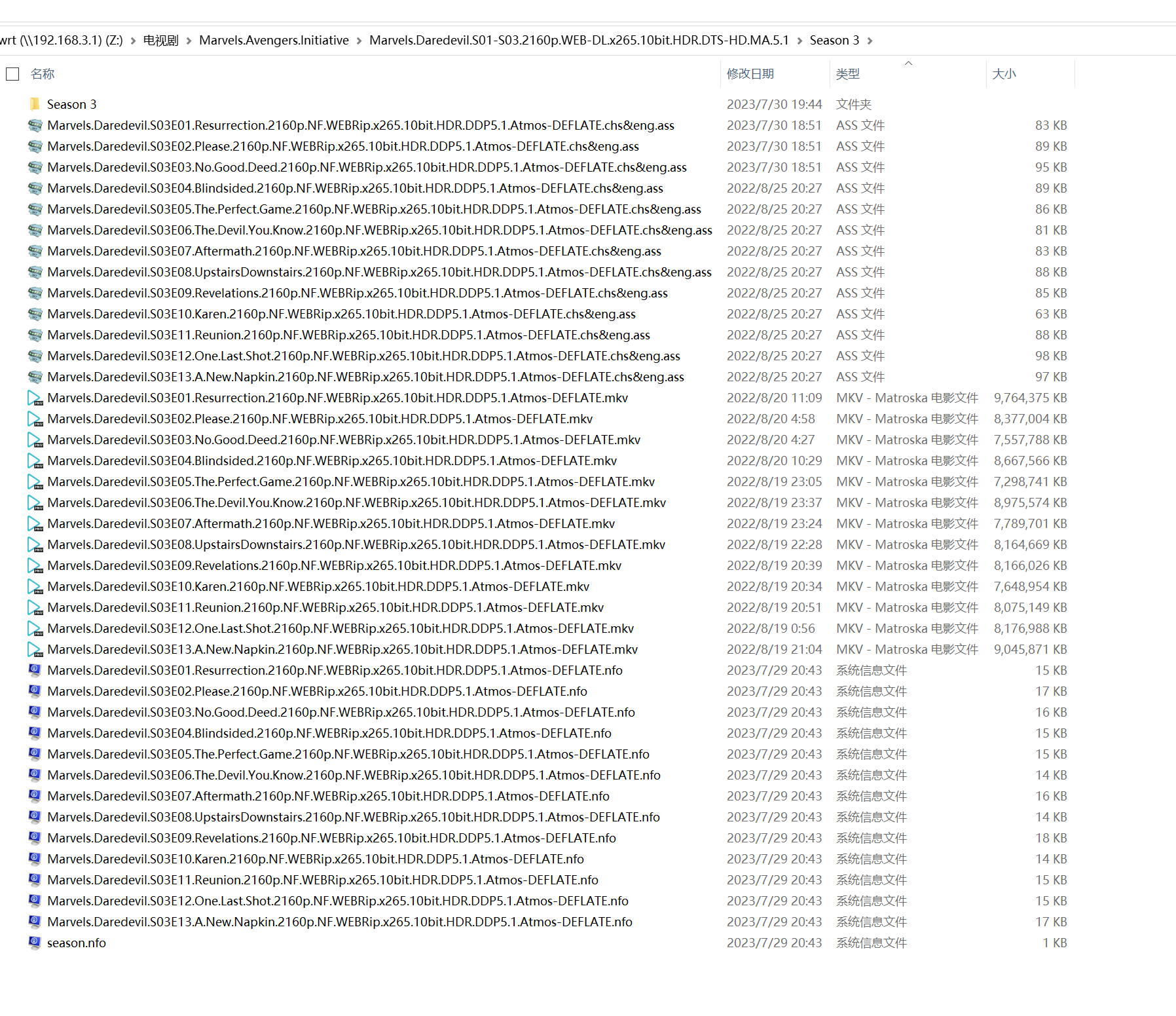

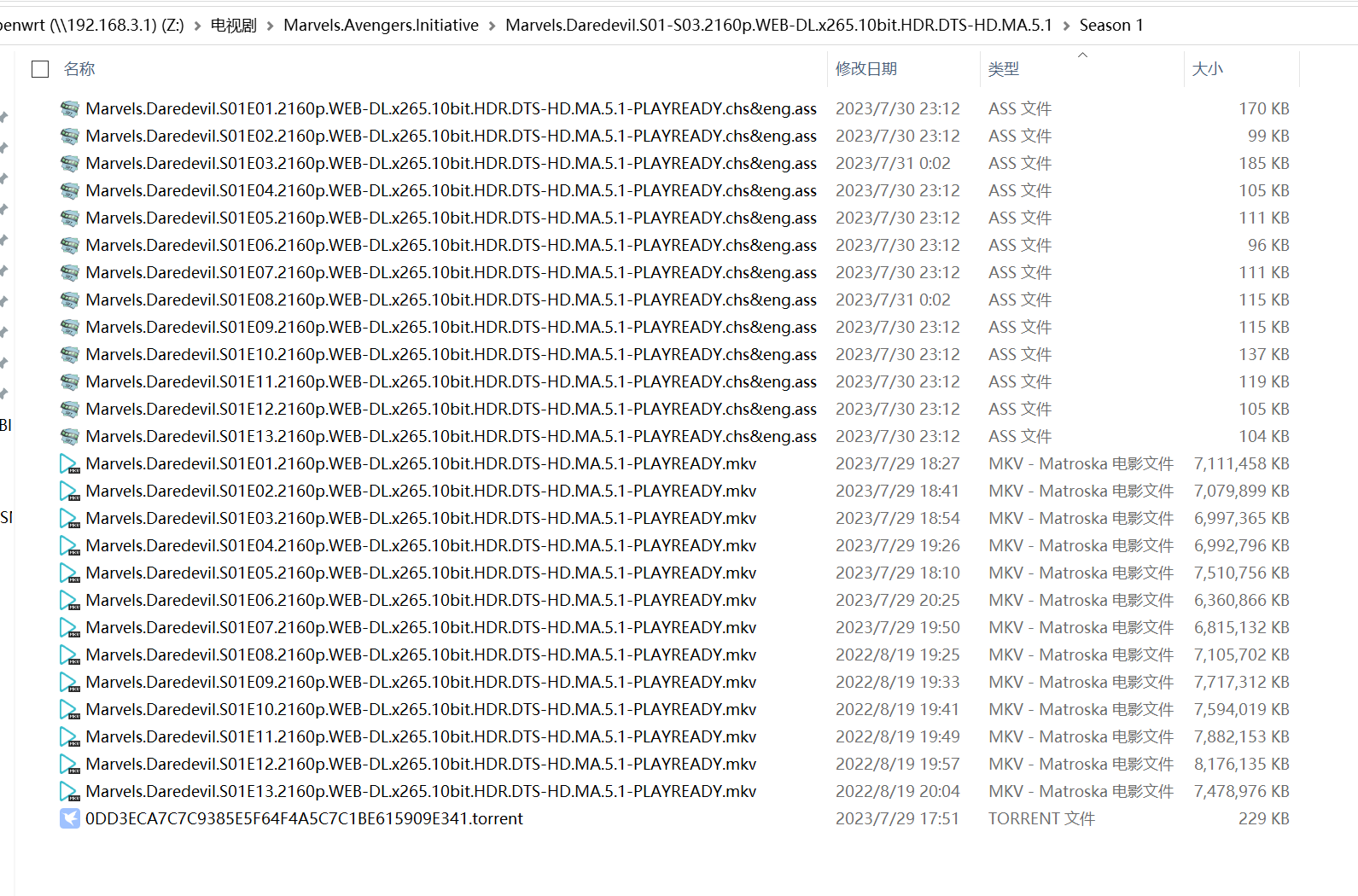

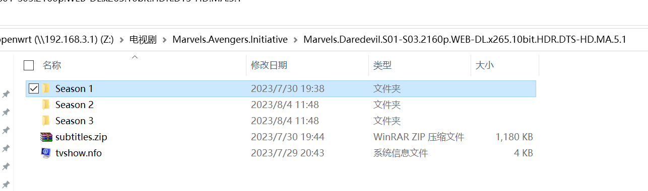

Luke 42290 Posted August 4, 2023 Posted August 4, 2023 23 minutes ago, y29shi said: I don't have season images in the folder Can you show the contents of the series folder? thanks.
y29shi 8 Posted August 4, 2023 Author Posted August 4, 2023 2 hours ago, Luke said: Can you show the contents of the series folder? thanks. sure:

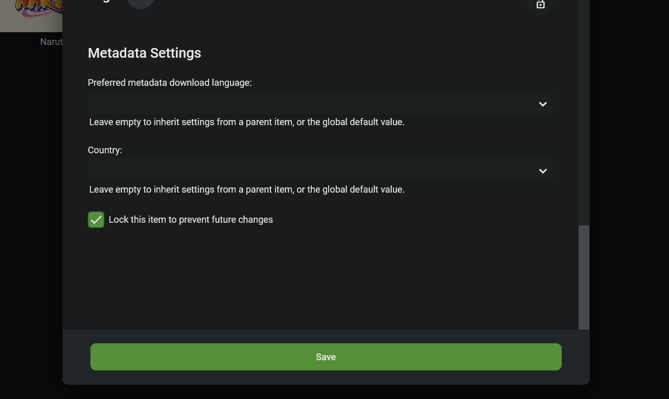

Darius 14 Posted August 4, 2023 Posted August 4, 2023 (edited) Maybe you can try to lock it to prevent future changes in the 'edit metadata' part of the context menu, it should not happen after that. Â That's what I do for these animes that have unofficial kai versions like One Piece and Naruto. Like that it avoids messing up the way the episodes, artwork and seasons are set up. Â Could just be that it gets replaced when you refresh the metadata especially if you had the option 'replace all images' ticked on when doing it. Edited August 4, 2023 by Darius

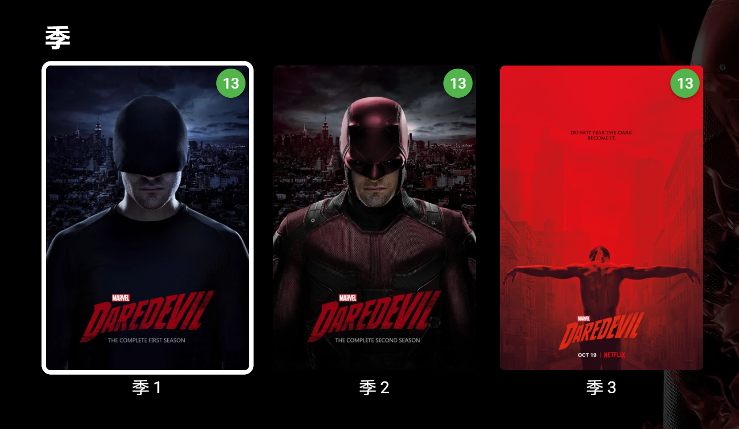

y29shi 8 Posted August 4, 2023 Author Posted August 4, 2023 1 hour ago, Darius said: Maybe you can try to lock it to prevent future changes in the 'edit metadata' part of the context menu, it should not happen after that. Â That's what I do for these animes that have unofficial kai versions like One Piece and Naruto. Like that it avoids messing up the way the episodes, artwork and seasons are set up. Â Could just be that it gets replaced when you refresh the metadata especially if you had the option 'replace all images' ticked on when doing it. actually it doesn't all change to the same pics when I manually scan the metadata with replacing existing images on, when I do that, it becomes this: so it is even stranger that after a while without doing anything, they all become that single one pic
y29shi 8 Posted August 4, 2023 Author Posted August 4, 2023 1 hour ago, Luke said: OK, please set the image back again, then run a scan of all libraries, then please attach the emby server log. thanks. I doute that this issue is the same as when I do manual scans. As you can see my post above, when I do manual scan for this single show, the seasons' images would indeed change, but they are not all the same and only the 3rd season would be identical to the show's image, the first two seasons are not. But this issue that I am talking about in this thread is that all of the 3 seasons' images become identical to the show's image. So I guess this behavior may not be logged when I do manual scan. Which file should I upload?
Darius 14 Posted August 4, 2023 Posted August 4, 2023 36 minutes ago, y29shi said: actually it doesn't all change to the same pics when I manually scan the metadata with replacing existing images on, when I do that, it becomes this: so it is even stranger that after a while without doing anything, they all become that single one pic That's when you should try to lock it to prevent future changes . That should stay persistent from my experience.
y29shi 8 Posted August 4, 2023 Author Posted August 4, 2023 26 minutes ago, Darius said: That's when you should try to lock it to prevent future changes . That should stay persistent from my experience. Yes I will try locking them and observe for a few days. I was just saying that this issue may not be related to metadata updates, since I tried manually updating the metadata and the result was not the same as the issue I saw...
y29shi 8 Posted August 4, 2023 Author Posted August 4, 2023 5 hours ago, Darius said: That's when you should try to lock it to prevent future changes . That should stay persistent from my experience. lol they changed again even if I locked all their metadata

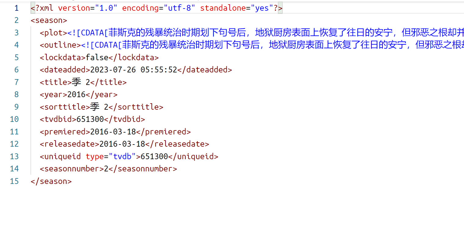

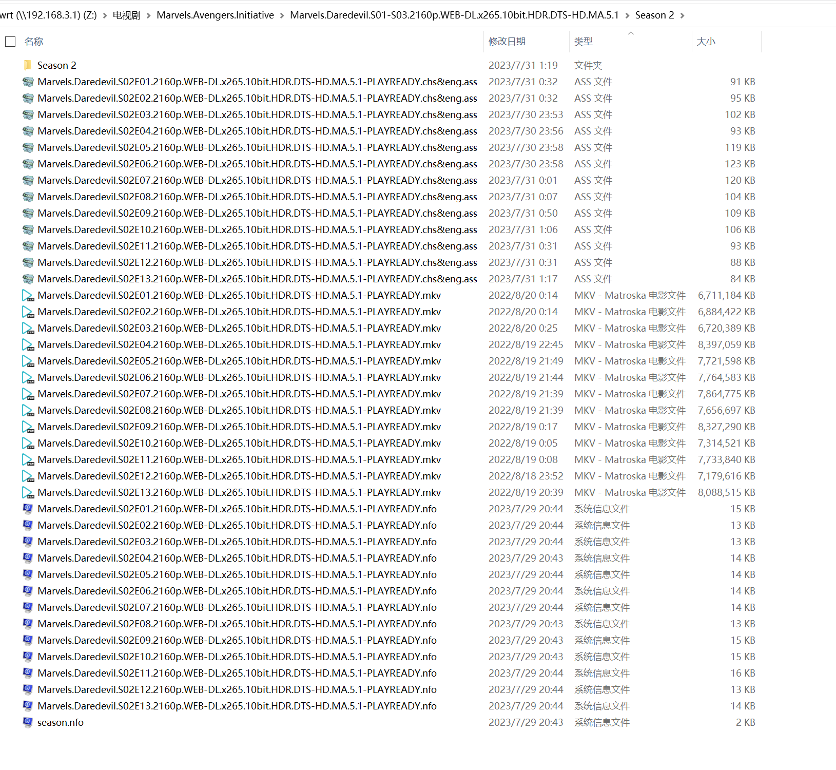

Neminem 1630 Posted August 4, 2023 Posted August 4, 2023 Do you have any about image in you season.nfo ?Â

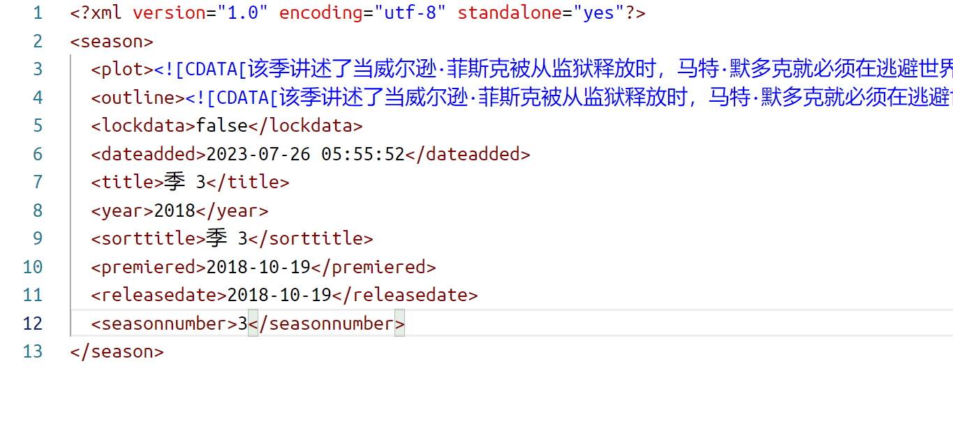

y29shi 8 Posted August 4, 2023 Author Posted August 4, 2023 30 minutes ago, jaycedk said: Do you have any about image in you season.nfo ? There's no season.nfo for season 1, and I just checked the nfo for season 2 and 3 and searched for the keyword "image", but no results. I also took a look in the tvshow.nfo and can't find "image" as well. 1
Neminem 1630 Posted August 4, 2023 Posted August 4, 2023 Can you try and move your season nfo out of the folder to an temp dir. I see tvdbid = 651300 in your nfo. And I think you are looking for Marvel's Daredevil - TheTVDB.com tvdbid = 281662 Â
y29shi 8 Posted August 4, 2023 Author Posted August 4, 2023 4 minutes ago, jaycedk said: Can you try and move your season nfo out of the folder to an temp dir. I see tvdbid = 651300 in your nfo. And I think you are looking for Marvel's Daredevil - TheTVDB.com tvdbid = 281662  hmm that's strange. this file was generated automatically by emby. Let me try that. But if the tvdbid is wrong, then shouldn't they not be able to match this image? I see that they still found the correct image for the show, it's just not the one I prefre.
y29shi 8 Posted August 4, 2023 Author Posted August 4, 2023 10 minutes ago, jaycedk said: Can you try and move your season nfo out of the folder to an temp dir. I see tvdbid = 651300 in your nfo. And I think you are looking for Marvel's Daredevil - TheTVDB.com tvdbid = 281662  Okay I just backuped all the nfo files and removed them from the folders, then I scanned the files and refreshed metadata. This time it didn't generate any nfo files at all. I've changed the season images again and I'll have to wait at least a few hours to see if they persist.
