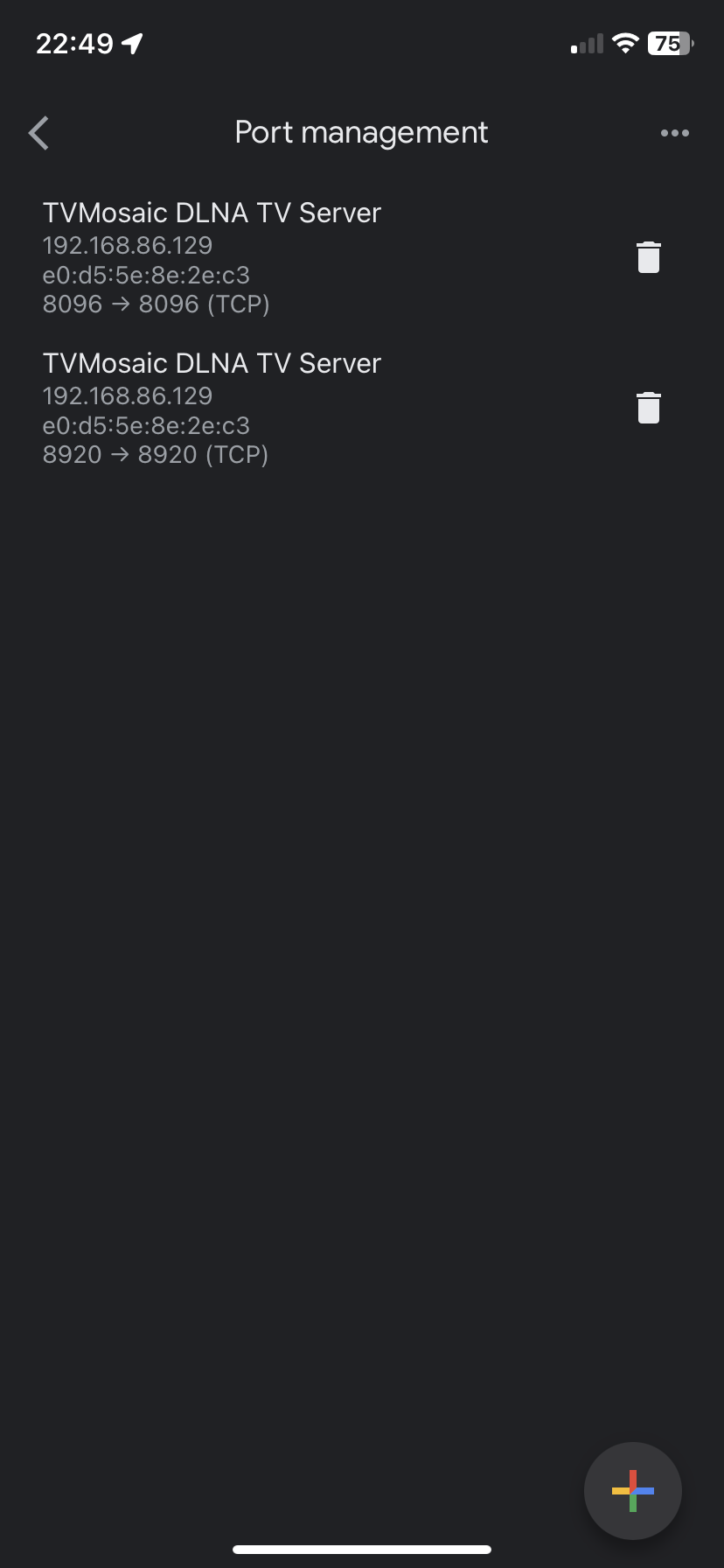

WoodviewRemote 1 Posted August 2, 2023 Author Posted August 2, 2023 Many thanks for your help - I enclose a screen shot from the google WiFi/home app I’m not aware of anything else using port 80 on that machine - any way I could check..? thanks again, and sorry that I don’t really understand these issues

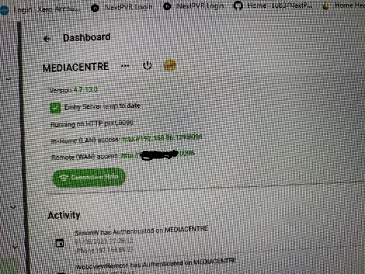

WoodviewRemote 1 Posted August 3, 2023 Author Posted August 3, 2023 Luke i am really sorry, but I am out of my depth i enclose a screen shot from my Emby server dashboard, which seems to have the same IP address? many thanks

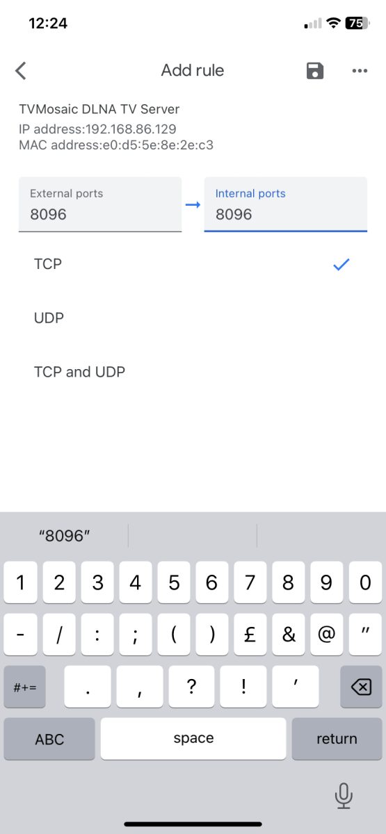

WoodviewRemote 1 Posted August 3, 2023 Author Posted August 3, 2023 Rbjtech i really appreciate your help i thought that is what I had done - see the enclosed screen shot highlighting the rule I set up. I tried again but it wouldn’t let me duplicate the rule if what I have done is incorrect please let me know, but I’m not sure what I should do differently many thanks again
WoodviewRemote 1 Posted August 3, 2023 Author Posted August 3, 2023 just thought to delete the rule and reenter so I could show you what I put into the google app thanks again
rbjtech 5335 Posted August 3, 2023 Posted August 3, 2023 Right ok - the 'TVMosiac' threw me - I assume that's what the Google App is picking up as your emby server. So how are you testing ? You may need to disable wireless on your phone and test via 4/5G ? If you are happy to - ping me your remote ip via PM and I'm happy to quickly test for you - don't need any login details - just the WAN IP.
