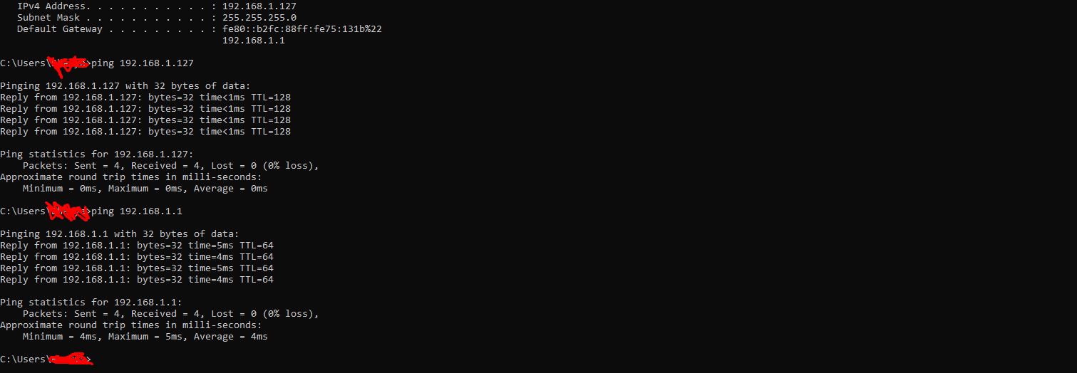

rbjtech 5335 Posted August 3, 2023 Posted August 3, 2023 What router/ap are you using ? Check your router/ap (access point) to ensure 'Client Device Isolation' (or something similiar) is not enabled. Can you 'ping' devices from the emby server on the same wifi network ? ie from a command prompt (type cmd in search if on windows, and hit return, on linux, use the terminal) on your emby server (if your remote device ip is 192.168.0.10) then try ping 192.168.0.10 Also do an 'ipconfig' - and you'll see a 'Default Gateway' - see if you can ping that as well. Is the emby server itself on wifi - or is that wired ? It's possible the wifi is on a different LAN - and the router is routing it - but the windows f/w is blocking it for the emby port. We really need to see all the networking details - the ipconfig output will help.

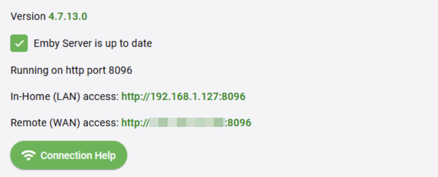

TheCanadIndian 0 Posted August 3, 2023 Author Posted August 3, 2023 (edited) I have tried manually trying to connect to the emby server on the app that has not worked. The server itself is on wifi and I am not using a VPN of any sort. I have a sagecom router and have turned off their AP isolation setting as well. Edited August 4, 2023 by seanbuff removed WAN address
rbjtech 5335 Posted August 3, 2023 Posted August 3, 2023 (edited) so I can see your server just fine, you can ping the server and the gateway ok. is the IP of the client(fireTV stick) also 192.168.1.x ? What exactly are you entering as the connection in the App ? You need to enter http://192.168.1.127 Port - 8096 edit - worth deleting any existing entries and restarting the app connection Edited August 3, 2023 by rbjtech

TheCanadIndian 0 Posted August 3, 2023 Author Posted August 3, 2023 (edited) Not sure how to edit on this forum I dont see the option but I am using the correct port and ip when entering the information manually as well. ps. found the button but do not see it on the post where I have my picture with my WAN showing was trying to remove that picture Edited August 3, 2023 by TheCanadIndian
seanbuff 1353 Posted August 4, 2023 Posted August 4, 2023 10 minutes ago, TheCanadIndian said: ps. found the button but do not see it on the post where I have my picture with my WAN showing was trying to remove that picture I have edited your post to hide your WAN address
