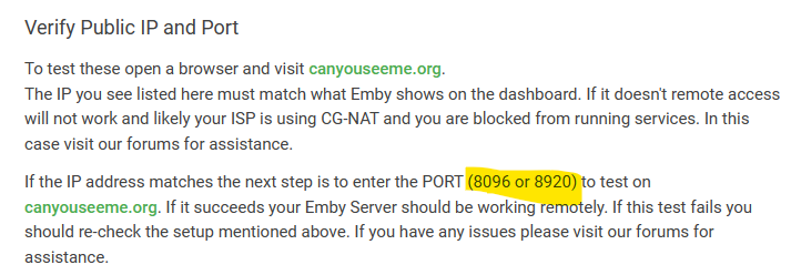

Neminem 1965 Posted August 1, 2023 Posted August 1, 2023 Tbh first step is how-to-report-a-problem And then use the forum and/or knowledge base to check issue https://emby.media/support/articles/Remote-Setup.html You have provided zero useful info about your issue. And that does not help the community, help you.

rbjtech 5401 Posted August 1, 2023 Posted August 1, 2023 9 minutes ago, elivick3031 said: I’m not sure what more I can say. Remote users are not able to connect to the server. They are receiving an error message. “ connection failure “. The Emby server is working in my home on my local network, the issue appears to be with remote users. I’ve restarted the Emby app, restarted my PC and restarted my router. Remote users still can not gain access. So have you followed the previous advice given ? A link was provided - have you run through this ? https://emby.media/support/articles/Remote-Setup.html Give feedback on what steps have worked and what have not - give examples if you can - that will give us a clue on where to start ...
rbjtech 5401 Posted August 1, 2023 Posted August 1, 2023 (edited) 28 minutes ago, elivick3031 said: Error: I could not see your service on [redacted] on port (80) Have you changed the default port to port 80 ? unless changed - you need to check port 8096 if just using http. It's all in the instructions ... Edited August 1, 2023 by GrimReaper WAN address hidden
elivick3031 5 Posted August 1, 2023 Author Posted August 1, 2023 Changed port to 8096 on canyouseeme.org Success: I can see your service on But I am still not able to remote access into my media?

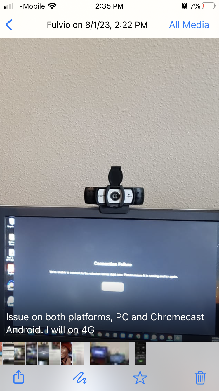

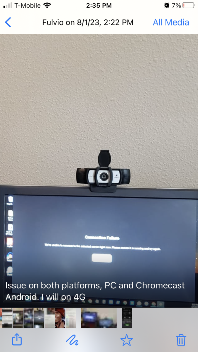

elivick3031 5 Posted August 1, 2023 Author Posted August 1, 2023 how did you do that? my daughter is trying to access my server from her home and she continues to receive a " connection failure " message?
rbjtech 5401 Posted August 1, 2023 Posted August 1, 2023 1 minute ago, elivick3031 said: how did you do that? my daughter is trying to access my server from her home and she continues to receive a " connection failure " message? Just via a browser and your IP address before it got redacted .. I've also tried from around the world using a VPN - I don't see any issues .. Make sure she is using a http://YOUR_IP:8096 - or port 8096 if she is using a non web client. Do not use https.

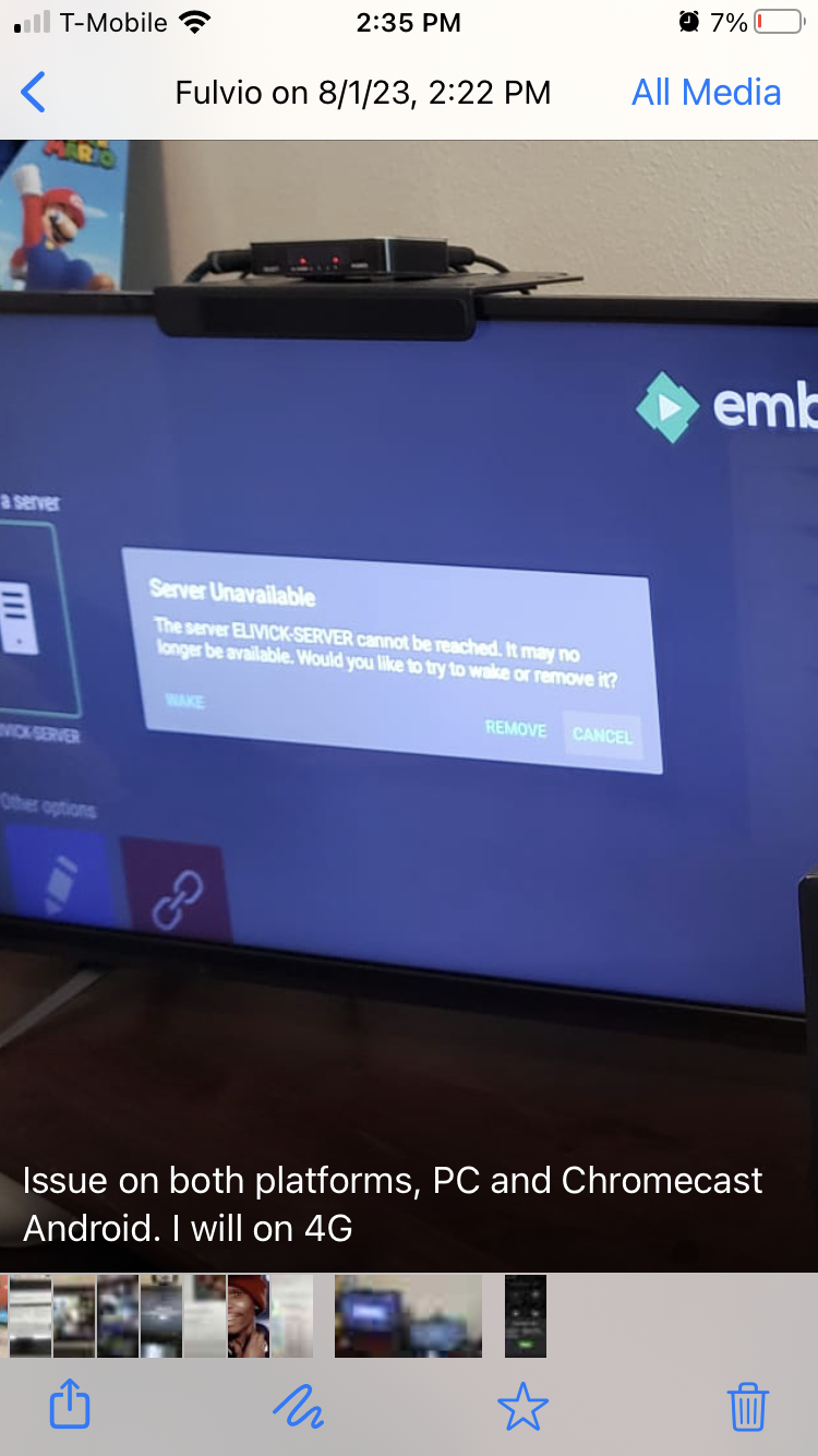

rbjtech 5401 Posted August 1, 2023 Posted August 1, 2023 (edited) ok - so that's AndroidTV right ? Press and hold on the 'server' to remove it (or click 'remove') on the message - and then try again with the info below server = http://YOUR_IP (the 47.197.x.x one) Port = 8096 It should then connect ... Edited August 1, 2023 by rbjtech 1
