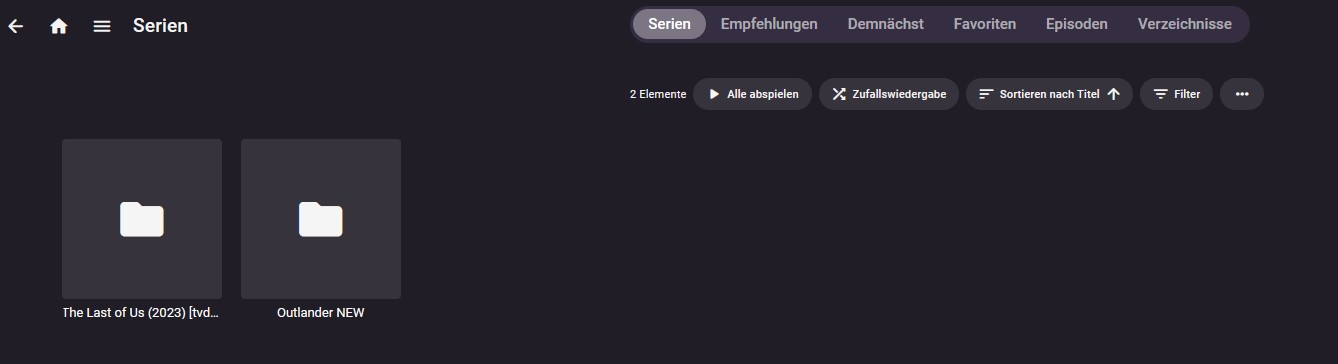

tomadick 8 Posted July 29, 2023 Author Posted July 29, 2023 (edited) At the beginning you can see the folder "The Last of Us (2023) [tvdbid=392256]" in the overview (see photo). After they are recognized (when the cover image is visible in the server management in the library settings) the folder "The last of Us" is no longer visible. Edited July 29, 2023 by tomadick

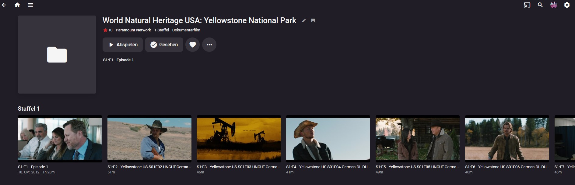

tomadick 8 Posted July 30, 2023 Author Posted July 30, 2023 (edited) The "merge" option was never selected. The folder structure and file naming system is exactly the same for each of the 26 series. Only the 6 series that I previously deleted via Emby (and not in the OS...) are not displayed to me. So I think it makes no sense to take a screenshot of the folder structure because - as written - they are systematically 100% the same. Example: will be recognized: /Ein Jahr zweite Liga - Die Werder Doku/Ein.Jahr.zweite.Liga.Die.Werder.Doku.E01.Der.Neuanfang.GERMAN.DOKU.720p.WEB.H264.mkv Was already recognized, nothing changed in the naming and is no longer recognized after deleting: /Yellowstone US/Yellowstone.US.S01E01.German.DL.DUBBED.2160p.WebUHD.h265.REPACK.mkv The series were already displayed correctly for me until I deleted them. However, they were not deleted in the OS. I opened a new library with "mixed content". The 6 folders with the unrecognized series are in there. As long as they are not identified by emby, the folders are visible - they only disappear after identification. One of the series (Yellowstone) is incorrectly recognized by emby as a documentary about Yellowstone Park - all episodes are displayed to me (of course with the wrong description) and I can play all episodes. As soon as I have the series identified as "Yellowstone", it disappears. Edited July 30, 2023 by tomadick

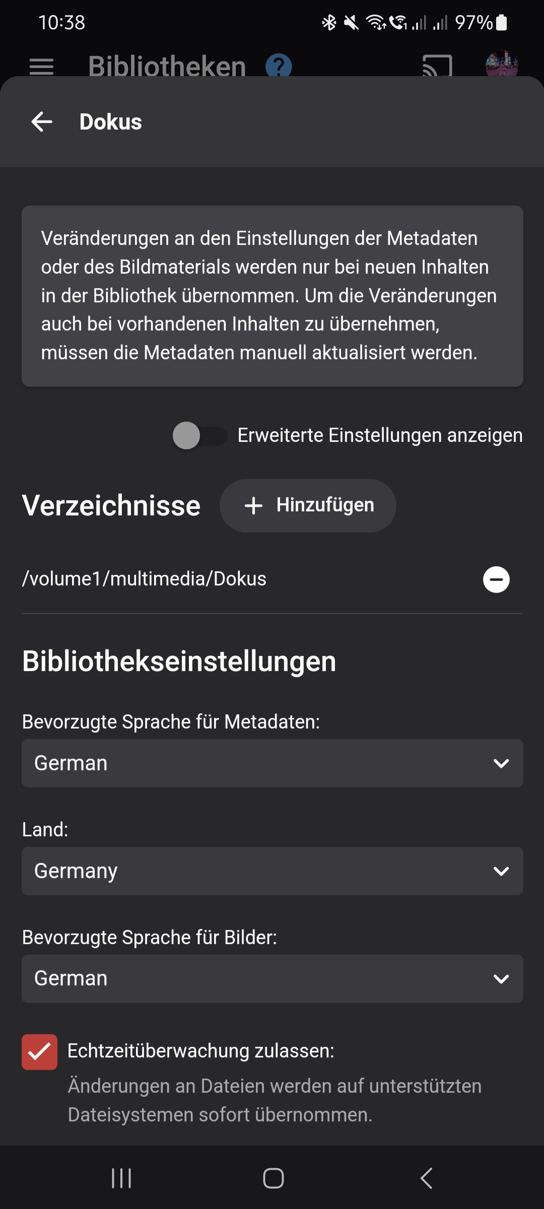

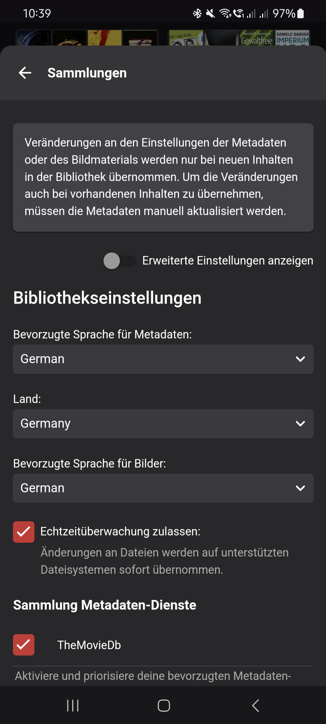

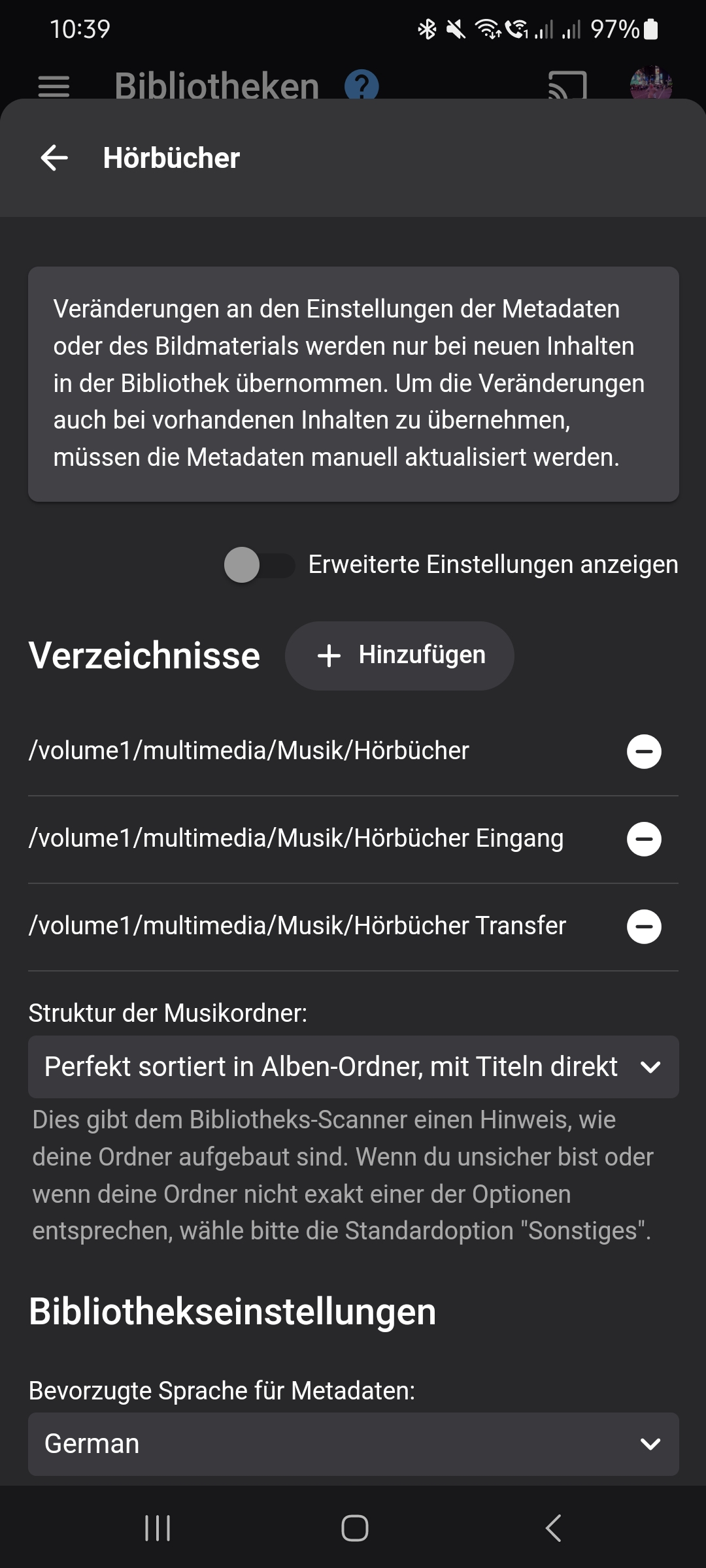

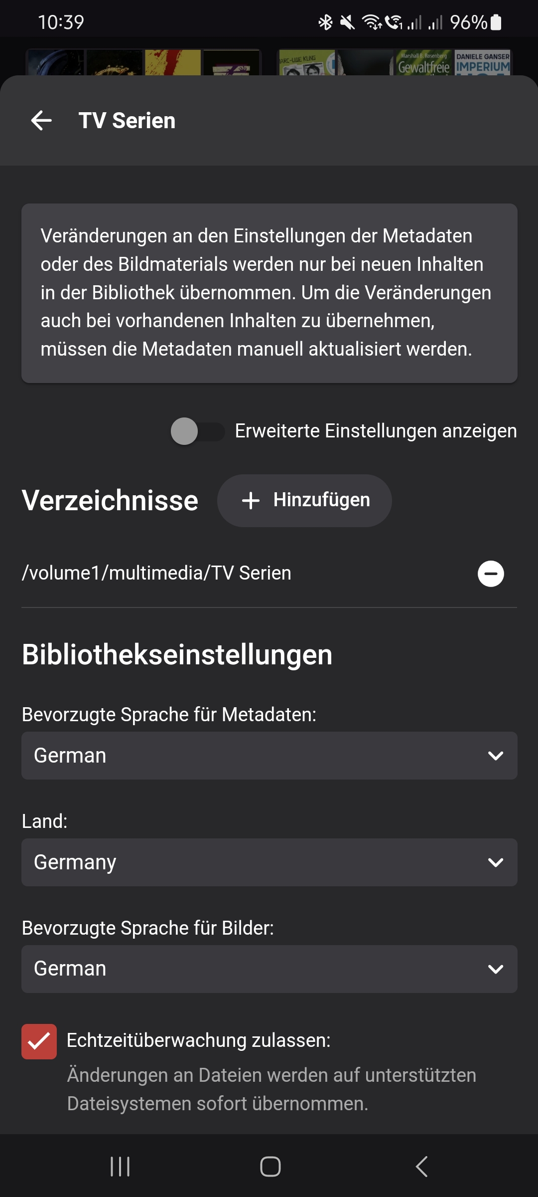

tomadick 8 Posted August 3, 2023 Author Posted August 3, 2023 (edited) There are 8 libraries. Originally there were 7, the 8th only gets the series previously deleted in emby. See screenshots... Edited August 3, 2023 by tomadick
Luke 42242 Posted August 3, 2023 Posted August 3, 2023 Can we see the folder paths for the second one? Thanks.
tomadick 8 Posted August 3, 2023 Author Posted August 3, 2023 Unfortunately, I can't help you there, because no paths can be defined in the "Collections" library.

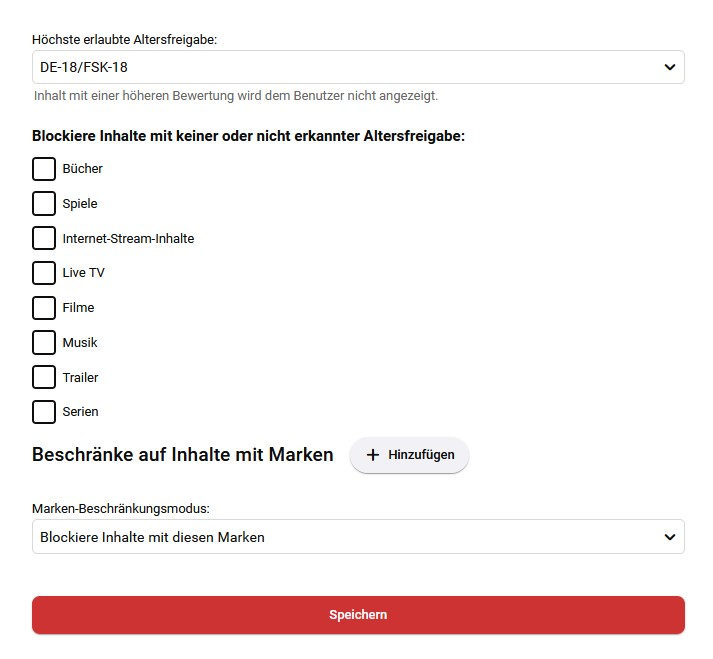

Luke 42242 Posted August 4, 2023 Posted August 4, 2023 Have you checked the parental controls for the user that is logged in? Perhaps the content is restricted. I would check that and also tag restrictions.

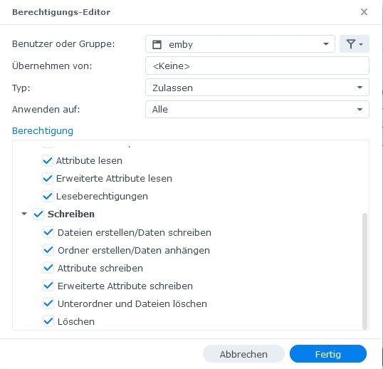

tomadick 8 Posted August 4, 2023 Author Posted August 4, 2023 With the account there are no age restrictions (see screenshot). There are four users created in emby, all of them are missing these 6 series already deleted once in emby. I started an experiment and re-added the series "The Outlaws 2021" to the path with the "missing" series. To do this, I checked emby's permissions, and emby has all read & write permissions on Synology for the folder (screenshot). After that I manually started a library scan and the series shows up with all 6 episodes in the folder where 6 other series are missing. Then I deleted the series via emby and it has been deleted in emby than on the NAS. Then I created the folder again and copied the 6 episodes in there and started a library scan again - the folder shows up in emby again. I marked all episodes as watched and deleted the series in emby - added it again and the series is back. I then repeated the whole thing with "The Last of Us" - named the folder "The Last of Us 2023" but did not move the episodes but copied them. The series then appears in emby with all copied episodes (screenshots). After that I identified the series (which was not recognized automatically) as "The Last of Us" in emby and bang: The series disappeared again in emby.
