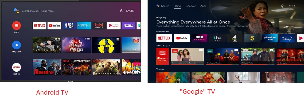

ClemFandango 18 Posted July 29, 2023 Posted July 29, 2023 Pretty much as it says in the title. I've updated the TV Software and downloaded the latest version of Emby for Android TV from the Play Store and the attached picture is what I see. I have no issues with the app at all - that's installed and working perfectly, but the grey boxes are sticking out a bit

ClemFandango 18 Posted July 31, 2023 Author Posted July 31, 2023 3 minutes ago, ebr said: In "Google TV" (the new iteration of the TV OS) they removed a lot of the customization for non-partner apps. Yes this is basically what's happened. The picture is very quick and dirty but it's a side by side comparison. The whole idea of customizable 'channels' has gone.
rbjtech 5341 Posted July 31, 2023 Posted July 31, 2023 So I see 'grey' empty boxes only for items that emby no-longer has available - I presume some sort of refresh is peroidically done within Android itself to generate the posters and these will get replaced. If you click the empty poster, does it still fire Emby and goto that TV Show (if TV) or start the movie ?
ClemFandango 18 Posted July 31, 2023 Author Posted July 31, 2023 9 minutes ago, rbjtech said: So I see 'grey' empty boxes only for items that emby no-longer has available - I presume some sort of refresh is peroidically done within Android itself to generate the posters and these will get replaced. If you click the empty poster, does it still fire Emby and goto that TV Show (if TV) or start the movie ? I've just done it and clicked on The Truman Show grey blob in the original picture and I'm currently looking at the launch page for that movie in Emby so that aspect of it works fine. 1
