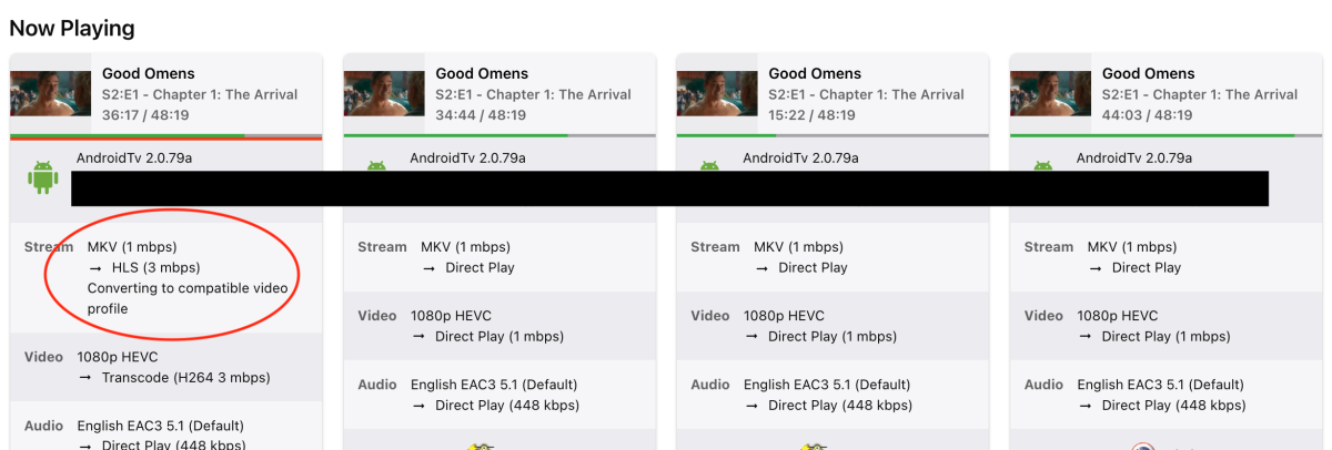

pomm 1 Posted July 28, 2023 Posted July 28, 2023 (edited) MKV files no longer direct stream to standard Fire TV (3rd Gen) devices. Direct stream still works on the Fire TV Stick 4K and the Fire TV Cube (3rd Gen). All devices have up-to-date firmware. Is this a problem with Amazon's standard Fire TV (3rd Gen) device? Thanks! Edited July 28, 2023 by pomm Image contained personal information

Solution GrimReaper 4898 Posted July 28, 2023 Solution Posted July 28, 2023 (edited) It appears that FireTV (3rd gen) is reporting not supporting 10-bit HEVC: Quote &hevc-profile=Main Quote "Profile":"Main 10"," hence it is transcoding: Quote &TranscodeReasons=VideoProfileNotSupported Same already reported here: You can reproduce the issue and follow the instructions to send a log from the app. You might also try sideloading Standard Android app and see how does that compare? Emby for Android - Emby Edited July 28, 2023 by GrimReaper
