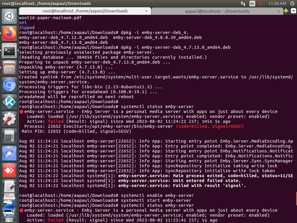

Ayush_92 0 Posted August 2, 2023 Author Posted August 2, 2023 (edited) I deleted using rm -rf and apt purge emby-server command. Also, I installed 4.7.13 version and below are screenshots.Only systemctl restart command can do active status but after a second goes inactive as I told you initially. Edited August 2, 2023 by Ayush_92
Luke 42245 Posted August 2, 2023 Posted August 2, 2023 Can you provide all of the log files that were generated by that fresh install attempt? Thanks.

Q-Droid 1011 Posted August 7, 2023 Posted August 7, 2023 Support for Ubuntu 16.04 LTS ended in 2021 also ending software updates and security patches. If you go on ESM you can still receive updates to 16.04 though there's no guarantee updates will fix your issue and may still need to upgrade the OS for Emby to work. You could also try the Docker container though you might also be stuck with an older Docker runtime and have other problems.
Ayush_92 0 Posted August 7, 2023 Author Posted August 7, 2023 Which minimum version of ubuntu does it support?
Q-Droid 1011 Posted August 7, 2023 Posted August 7, 2023 The devs might know the lowest supported release and/or the reason for the segmentation fault.
alucryd 318 Posted August 7, 2023 Posted August 7, 2023 We only support the current supported releases, that would be either 20.04 LTS or 22.04 at the time of writing. Other versions might work fine but we can't make any promise. 1
