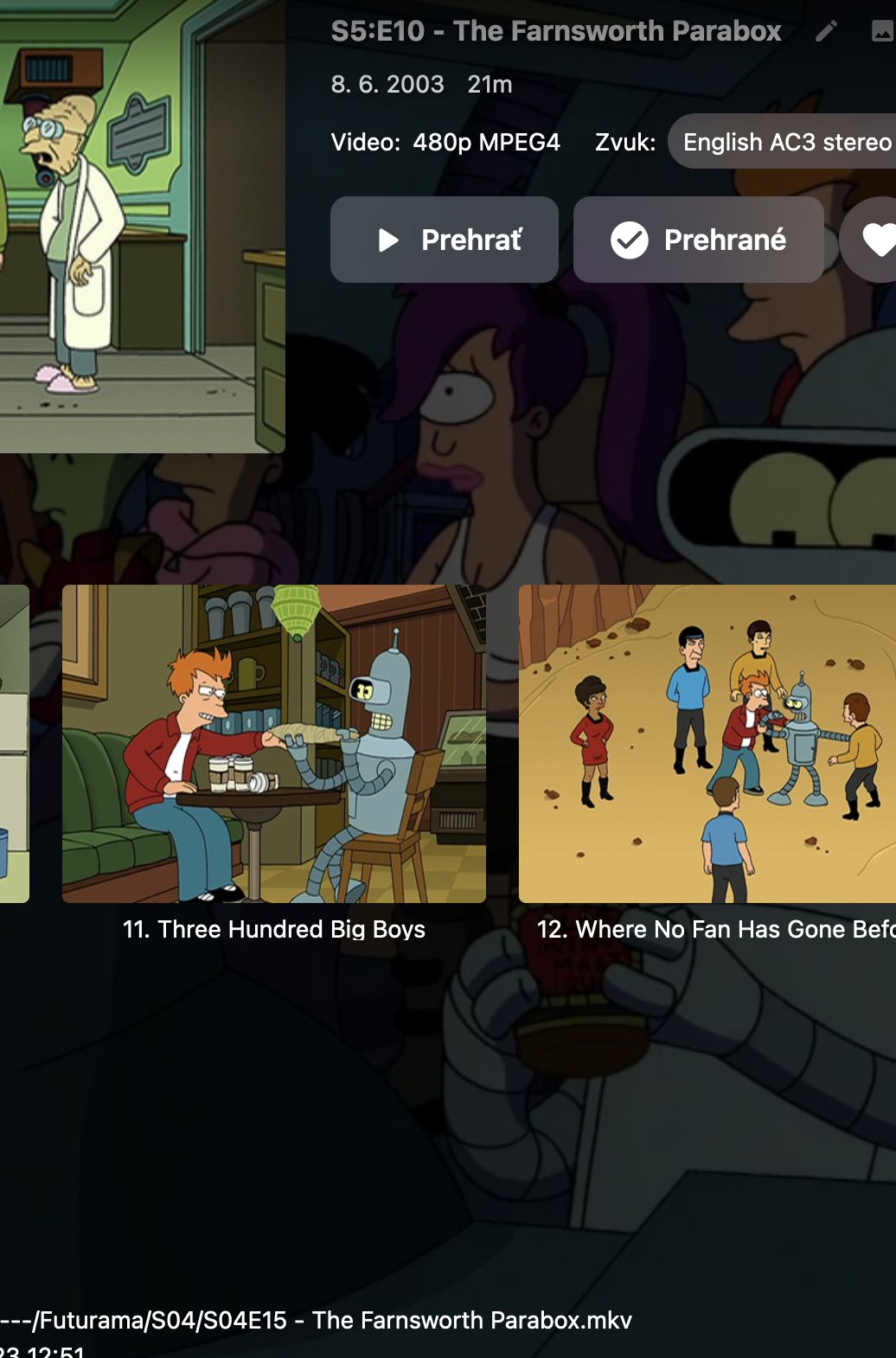

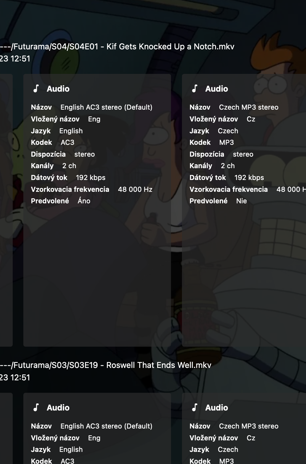

Barlog9511 17 Posted July 26, 2023 Posted July 26, 2023 (edited) Hi there I discovered a very strange bug, on my Futurama collection suddenly the file assignments to the correct episodes stopped working, as the screenshots below show 2 scenarios occur the episode is not assigned correctly, in my case episode S04E15 was assigned in the Emby server to S05E10 another scenario is a nonsensical merging of 2 episodes together, in the screenshot below S04E01 and episode S03E11 were merged like this the episodes contain the title of the episode e.g. S04E01 - Kif Gets Knocked Up and Notch can this be a problem ? I've never seen anything like this before thanks for help embyserver.txt Edited July 26, 2023 by Barlog9511 adding log file

GrimReaper 4898 Posted July 26, 2023 Posted July 26, 2023 (edited) 5 minutes ago, Barlog9511 said: my episode sorting uses DVD order of episodes Hence the question, as Aired order doesn't have S03E19 nor S04E15, but order of same episodes is: Aired S04E01 for DVD S03E19 Futurama - Roswell That Ends Well - TheTVDB.com Aired S05E10 for DVD S04E15 Futurama - The Farnsworth Parabox - TheTVDB.com and that's what you see occurring, it's as if you order is set to Aired. I'd reselect DVD order on series level and refresh metadata. Edited July 26, 2023 by GrimReaper 1
