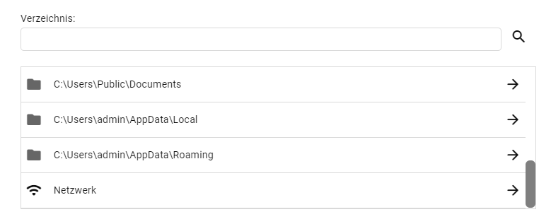

pachi81 6 Posted July 25, 2023 Posted July 25, 2023 Hi, I installed Emby Server for Windows on a new Windows 11 system. I used the NSSM to use Emby as service and set the local account for log-on to the service. I also disabled the Emby itself to start after login. All seems to work, the service run with the local account as expected, but I do not see my mapped network drives. I only have access to C:\ from the library. Is there anything I can do or is it better to use Emby Server on Linux?

pachi81 6 Posted July 25, 2023 Author Posted July 25, 2023 Yes, I know and you can see in the screenshots, that it runs with "admin" account.

pachi81 6 Posted July 26, 2023 Author Posted July 26, 2023 The interface is public and when I try to add it manually, I got an error, that the path is invalid...

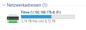

pachi81 6 Posted July 26, 2023 Author Posted July 26, 2023 The admin account is the one, I log in with and where I created the mapped network drives. What do you mean with network settings? Shall I switch to private?

pachi81 6 Posted July 26, 2023 Author Posted July 26, 2023 It is working, now! I stopped the service and started Emby manually and now I see my mapped drive. Maybe Emby as service does not work correct. Now I can play around with mapping the NFS mount... And if all is working, I will try again with the service. Regards, Michael
