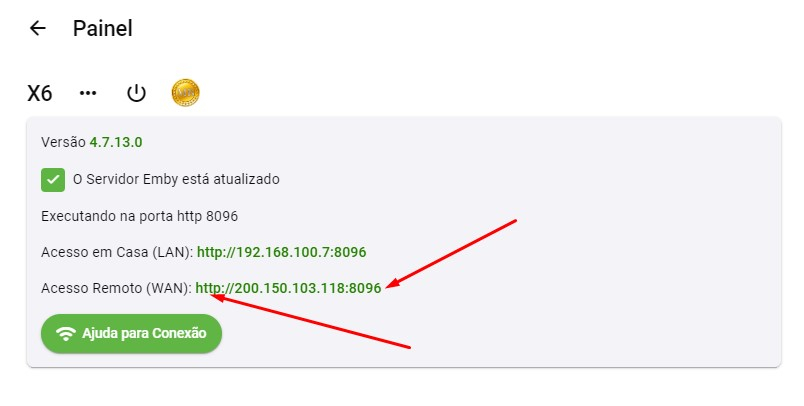

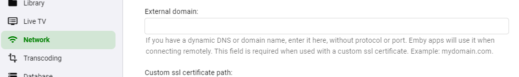

gsites 14 Posted July 22, 2023 Posted July 22, 2023 On 11/20/2022 at 1:38 PM, Luke said: Hi, you can customize your remote address in Emby Server network settings. Just keep in mind that if you do that, it will be your responsibility to keep the setting up to date if/when your IP changes. Hello I'm having a problem with this, emby doesn't "get" ipv6 automatically, it only simulates an ipv4 that doesn't work externally. Could you please show with images where the IPV6 address must be entered manually?
gsites 14 Posted July 23, 2023 Author Posted July 23, 2023 Hello I'm having trouble with some recent emby server updates. How to make emby forever "get" IPV6 and not IPV4 from PC/Modem link
Luke 42185 Posted July 24, 2023 Posted July 24, 2023 Hi, there is no option to do this automatically, but you can manually specify your server wan address in network settings if you need to. Please note, once you start doing this, you're going to have to make sure to keep this up to date anytime your wan ip address changes.
gsites 14 Posted July 26, 2023 Author Posted July 26, 2023 On 7/23/2023 at 10:44 PM, Luke said: Please note, once you start doing this, you're going to have to make sure to keep this up to date anytime your wan ip address changes. I'm trying but I didn't find it correctly could you send a print of the exact location thank you
gsites 14 Posted July 26, 2023 Author Posted July 26, 2023 On 7/23/2023 at 10:44 PM, Luke said: Hi, there is no option to do this automatically, but you can manually specify your server wan address in network settings if you need to. Please note, once you start doing this, you're going to have to make sure to keep this up to date anytime your wan ip address changes. When the user accesses the emby connect would not have to automatically find the address that appears on the emby server? that is, if the address is correct, will the user access the server perfectly?
ebr 16307 Posted July 26, 2023 Posted July 26, 2023 1 hour ago, gsites said: I'm trying but I didn't find it correctly could you send a print of the exact location 1 hour ago, gsites said: When the user accesses the emby connect would not have to automatically find the address that appears on the emby server? that is, if the address is correct, will the user access the server perfectly? Connect will use the address that is shown on your Emby server dashboard. When you change the field above, that will change as well - showing you the address that will be used. That needs to be exactly correct.
