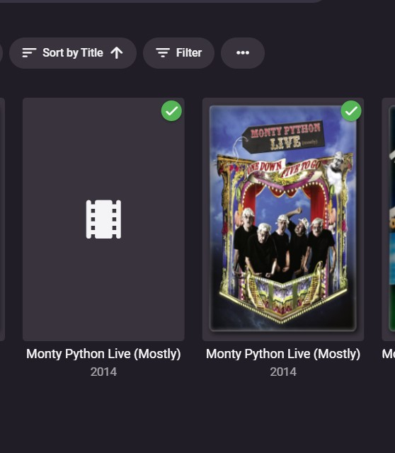

ulrick65 30 Posted July 23, 2023 Posted July 23, 2023 (edited) I have one Movie that I am adding that for some reason it is picking up the trailer as a separate movie and I can not figure out why. Background: I do not allow my Library folders to write to the movie location, the shares that it reads are read-only. This has been the setup for 10 years and works fine. I have one folder that I used to run new items "through" that does have write capability. That is so that I "can" use Emby's metadata, image downloads, etc. if I need/want to. But once done in there, the movie is moved to it's final library. I recently started a new naming convention...adding info about the Movie to the file names. This has worked fine with no issues noted...until this one. The trailer is being detected as a Movie for some reason. I thought maybe the file name length was an issue, but I have longer ones that work fine. I thought maybe the dashes in the file name were a problem, but I have those in others that work fine too. Any thoughts on why this is happening? Edited July 23, 2023 by ulrick65

ulrick65 30 Posted July 23, 2023 Author Posted July 23, 2023 12 minutes ago, GrimReaper said: How are you files named and organized? I figured it out. The reason is because the filename has -SHORT in it. For example: Monty Python Live (Mostly) (2014) [Bluray-1080p][DTS 5.1][x264]-SHORTVERSION.mkv and the Trailer is: Monty Python Live (Mostly) (2014) [Bluray-1080p][DTS 5.1][x264]-SHORTVERSION-trailer.mkv I tested several different names and every time -SHORT* is in there, it separates it into its own movie. I am guessing that Emby is assuming it is a "Short". Simply changing it to movie: Monty Python Live (Mostly) (2014) [Bluray-1080p][DTS 5.1][x264]-SHORVERSION.mkv And Trailer: Monty Python Live (Mostly) (2014) [Bluray-1080p][DTS 5.1][x264]-SHORVERSION-trailer.mkv (removing the T) fixes the problem. Seems like maybe something that should be addressed?

ulrick65 30 Posted July 23, 2023 Author Posted July 23, 2023 11 minutes ago, GrimReaper said: You can also dump it in \trailers subfolder in which case file name shouldn't matter, in general. I appreciate the recommendation...but that would change my entire collection requirements and is not something I am prepared to do. I think that Emby's parsing needs to be adjusted to pick up -short (or whatever else it is exactly looking for around shorts) but ignore things that are clearly not a short...for example have -trailer as the filename end before the extension.
Luke 42185 Posted July 24, 2023 Posted July 24, 2023 HI, yes I can see why this might happen. We'll take a look at it. Thanks.

Luke 42185 Posted August 18, 2023 Posted August 18, 2023 6 hours ago, adminExitium said: I was referring to the parsing fix that was mentioned above. Is it only for titles like Monty Python Live (Mostly) (2014) [Bluray-1080p][DTS 5.1][x264]-SHORTVERSION-trailer.mkv which have the SHORT keyword in them or any file that ends in -trailer.mkv like Monty Python Live (Mostly) (2014) [Bluray-1080p][DTS 5.1][x264]-ABC-trailer.mkv ? -shortversion should be resolved now. if it ends in -trailer it's going to be picked up as a trailer because that's part of the trailer naming conventions.
