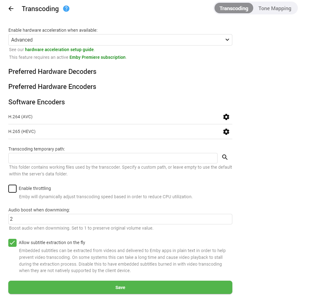

hallda 2 Posted July 22, 2023 Posted July 22, 2023 i install emby server with docker-compose My Set: intel i5 13500 gigabyte B760m ds3h (FW version F11) ubuntu server 22.04 OS (kernel 5.19.0-46-generic) Emby server Version 4.8.0.39 beta my docker-compose.yml version: "2.3" services: emby: image: emby/embyserver:beta container_name: embyserver network_mode: host # Enable DLNA and Wake-on-Lan environment: - UID=1000 # The UID to run emby as (default: 2) - GID=1000 # The GID to run emby as (default 2) - GIDLIST=44 # A comma-separated list of additional GIDs to run emby as (default: 2) volumes: - /programdata:/config # Configuration directory - /movies:/mnt/share1 # Media directory ports: - 8096:8096 # HTTP port - 8920:8920 # HTTPS port devices: - /dev/dri:/dev/dri # VAAPI/NVDEC/NVENC render nodes restart: on-failure i ran getent passwd <user> | cut -d: -f3 and getent group <group> | cut -d: -f3 , i got 1000 i ran getent group video | cut -d: -f3 , i got 44 i ran " ls -l /dev/dri ", it return drwxr-xr-x 2 root root 80 Jul 22 10:07 by-path crw-rw---- 1 root video 226, 0 Jul 22 10:07 card0 crw-rw---- 1 root render 226, 128 Jul 22 10:07 renderD128 so, i ran " intel_gpu_top ", it return intel-gpu-top: Intel Alderlake_s (Gen12) @ /dev/dri/card0 - but i don't know this is bug or something , i update bios version uptodate What did i miss ? (i sorry my english isn't good) hardware_detection-63825619855.txt embyserver.txt

Q-Droid 1011 Posted July 22, 2023 Posted July 22, 2023 The render group ID. $ getent group render | cut -d: -f3 1
hallda 2 Posted July 22, 2023 Author Posted July 22, 2023 Thanks you , I can see Enable hardware acceleration 1
hallda 2 Posted July 23, 2023 Author Posted July 23, 2023 Yes, i can use transcoding now with emby premiere, so that great 1
